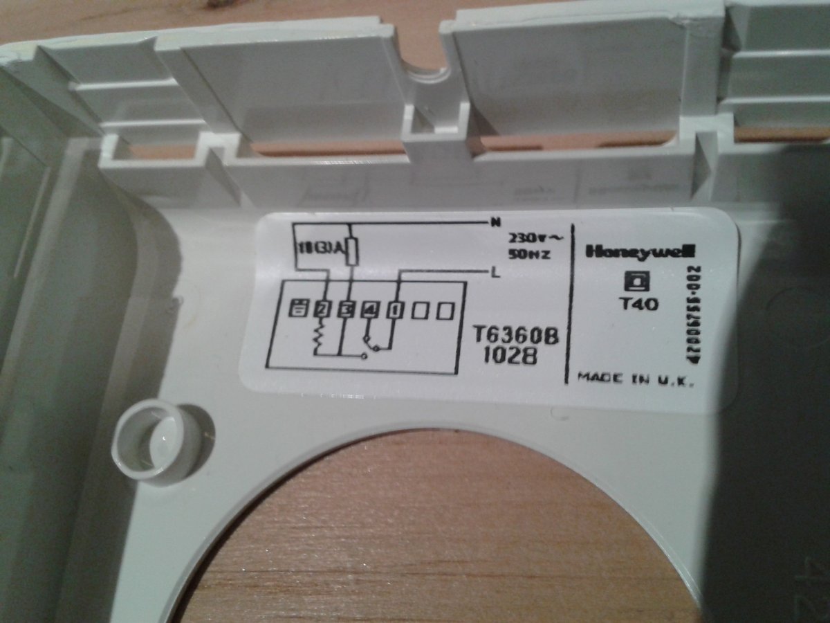

Hi group, forgive my ignorance, I ordered a Hive 2 ( combi) to fit onto my central heating system to replace a Honeywell T40 thermostat. I was under the impression that the Hive receiver would utilise the existing wiring from my old Honeywell thermostat, but I don’t understand which wires go where, I’ve included a couple of photo’s which I hope will help, my boiler is a Vokera Syntesi 35 model. I would appreciate any advice or positive comments.

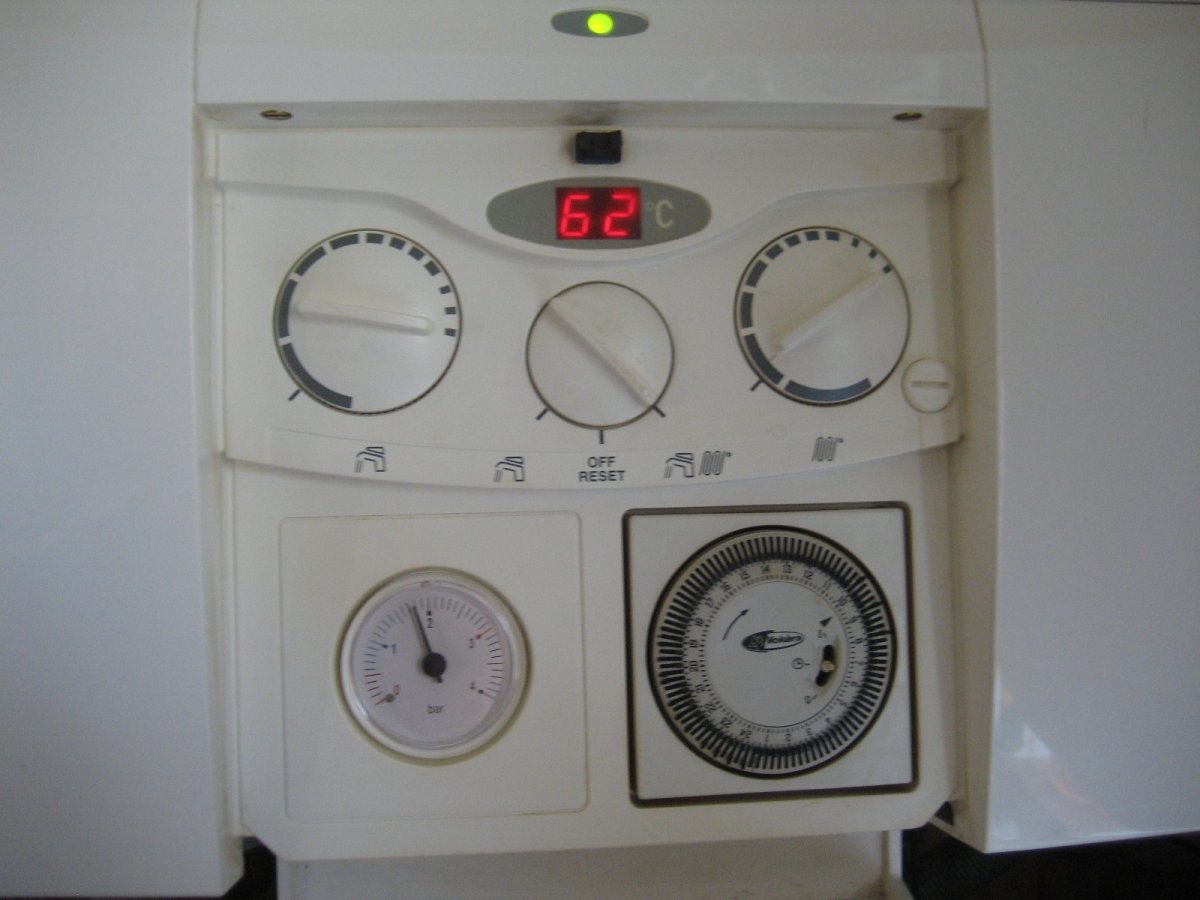

The receiver should replace the clock not the thermostat, just link the stat out by following ollski's instructions.

Do you have a timer/programmer/clock to set times for ch to come on ? Some pictures would be helpful.

Refer to this then as running wires from the boiler and disconnecting clock is probably not in your best interests.

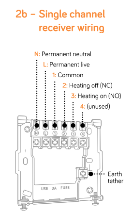

Put blue in neutral, red in live, a link between live and 1, yellow in 3 and Earth in earth.

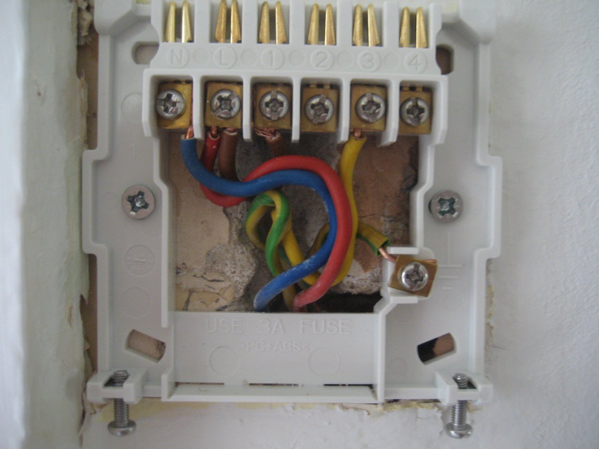

Quick update, I fitted receiver as per described, but I,m getting no indication of power on the receivers LED,s, checked the live & #1 and it is live as is the yellow #3, however when I connect the multi meter to the live & neutral I'm getting no display, Still getting domestic hot water. Boiler is set to constant. Refitted old honeywell thermostat and heating is working fine. Any help appreciated
check voltage to each connection and earth and see what you get
If I read that right, I'm taking the voltage check for the terminals whilst connected to earth, the are the results, N=45v L=170v T1=170v T3=250v

It looks like the yellow is live and red switched live. Try swapping them around.
