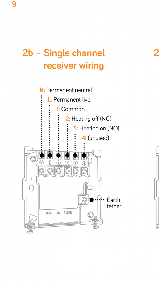

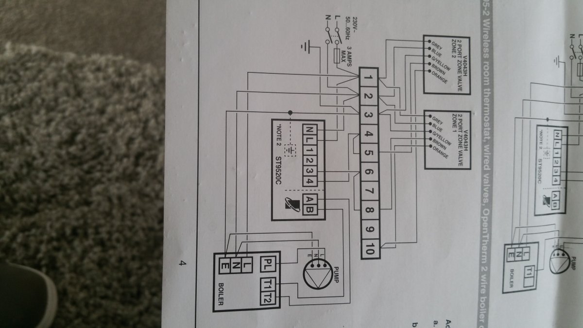

Hello, I recently purchased the hive acting heating system and was looking for a little help on the wiring, my current programmer is a honeywell st9520c, I will include a wiring diagram of how it is wired into my house and also a diagram of the hive receiver, any help appreciated, thanks
Your present system has two zones, normally they are controlled with two separate thermostats and configured as 'upstairs' and 'downstairs'. The Hive only has a single channel, so is not a suitable replacement.
So would I need to buy the additional multizone kit, or can it be rewired to a "single zone"
In theory you could do either, but if you did wire it as a single zone, if the room where the upstairs thermostat is presently sited doesn't have a thermostatic radiator valve, it will likely get overheated.
I'm assuming too, that your property is fairly new, so the two zone installation would have been done to comply with the current building regulations.
So, as your system has been designed as a multizone, it would probably be best to keep it that way.

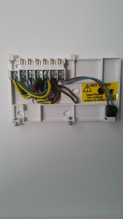

You appear to have open thermostat connections there.
Hive is not open therm
Yes indeed, good spot!
I saw in the circuit diagram that the motorised valves were wired at 230V from the programmer, and that the grey wires to the motorised valve microswitches normally used for boiler control are shown wired to a permanent live, but then when you follow the orange wires that normally control the boiler they don't actually go anywhere.
