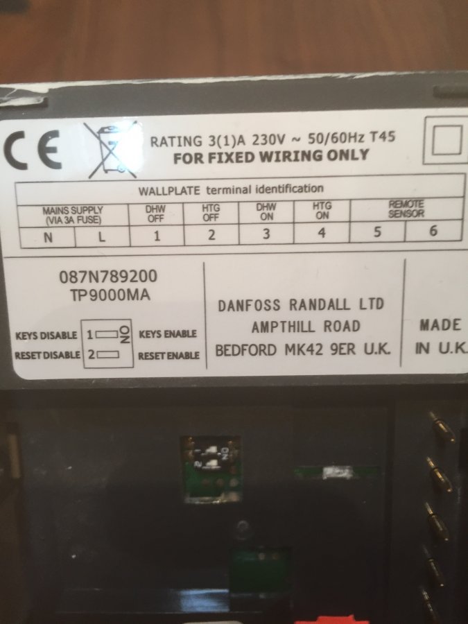

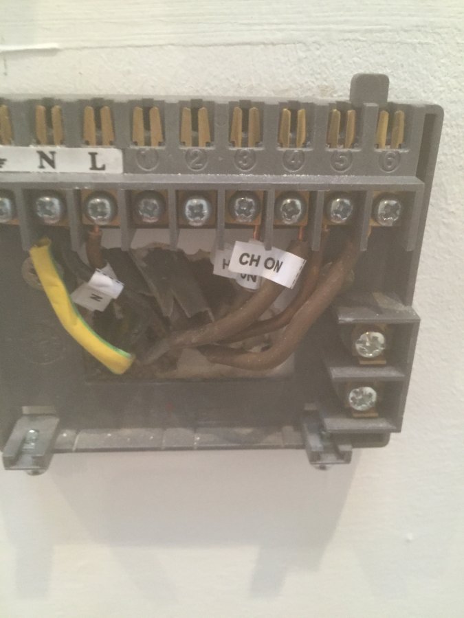

I'm really stuck with the wiring of my Hive active heating 2 I have bought and would really appreciate some advice from you knowledgable people.
I currently have a danfloss reviewer wired up to my combo boiler. There is a live, natural, Earth, and then 4 other wires coming into the reciever. From looking at the danfloss wiring diagram these are going into CH on and HW on. The other 2 go into the remote sensor plugs.
I have tried only wiring the live, neutral, Earth and CH On (into port 3) but this does not work.
I have attached a picture of the current Danfloss wiring
Can anyone tell me how I should be wiring this please - would really appreciate the help

As for your wiring. You will need to disconnect the remote wiring and wire the CH on straight to the valve white wire.
Despite all of the questioning. Actually, in this instance, with regard to your wiring question, it doesn't matter if you have a combi or not. The important thing is that you do have stored hot water and so require the dual channel unit. The wiring on the dual channel Hive corresponds with the wiring you have now.
Danfoss 'N' = Hive 'N'
Danfoss 'L' = 'Hive L'
Danfoss Terminal 3 'DHW on' = 'Hive Terminal 3 'Hot Water on (NO)'
Danfoss Terminal 4 'HTG on' = 'Hive Terminal 4 'Heating on (NO)'
The Hive doesn't need an earth, but there is a 'tether' for it, to keep it safely out of the way.
If the remote sensor wires (5 & 6) go to your existing room thermostat, then the 'Heating on' wire at the Danfoss will already be connected to the motorised valve, because the thermostat switching is presently done inside the Danfoss. If so, the sensor wires should be disconnected and removed.
