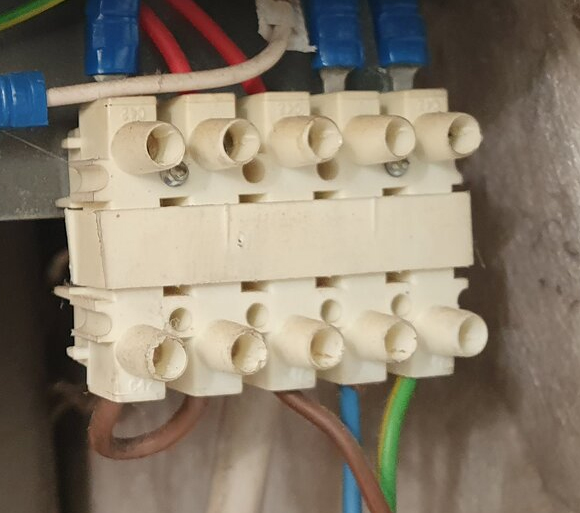

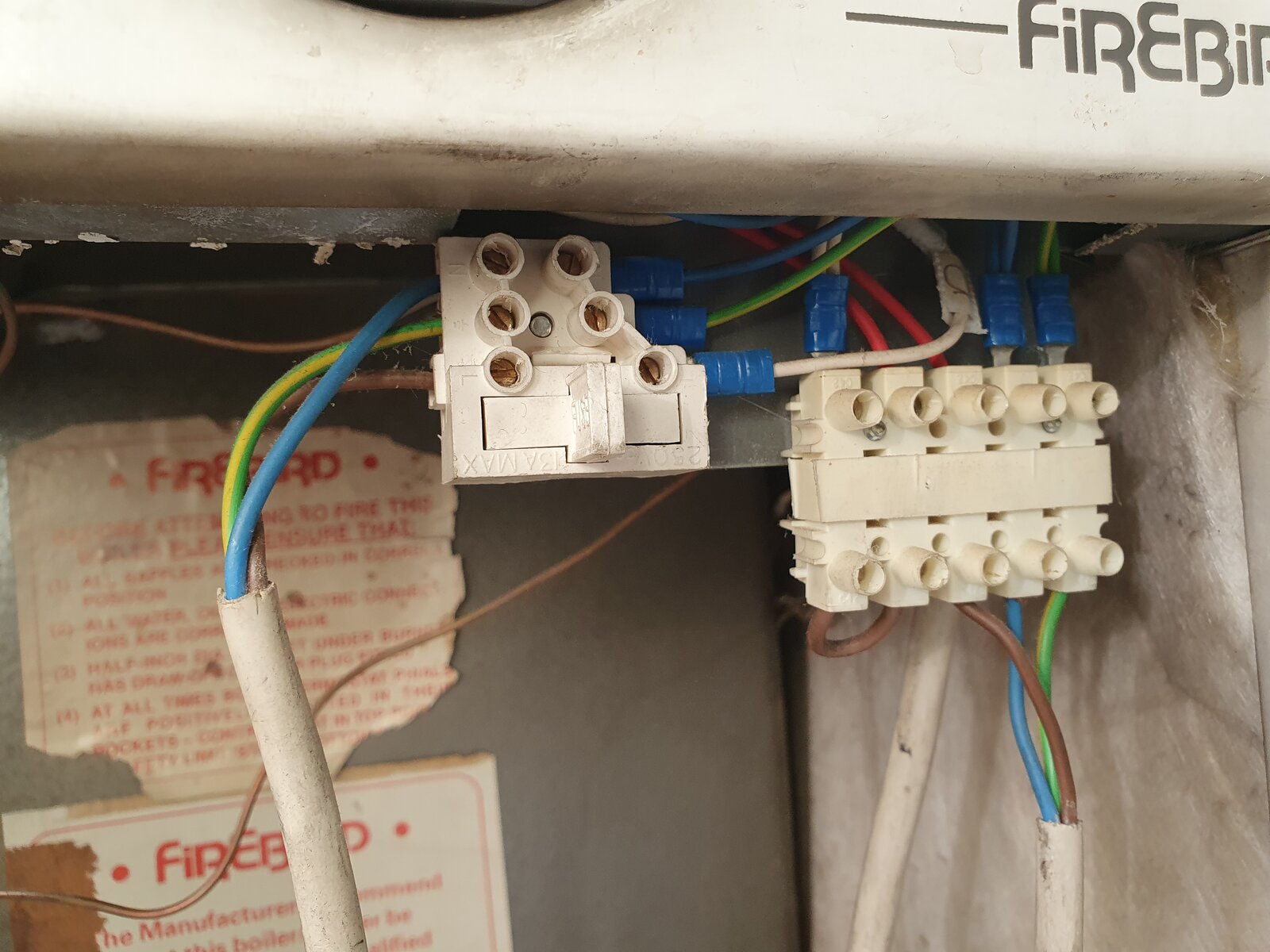

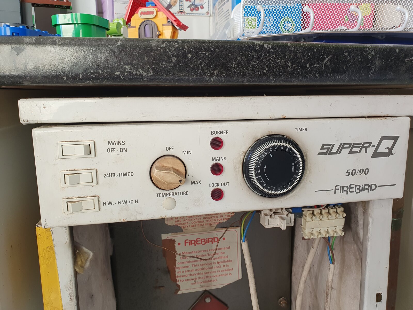

Hi,
I need help identifying wires from my old firebird boiler. I only ever turn the boiler on or off and always have it on HW/CWW so a simple control on the power switch for the boiler would be enough for me.
- I have the live,neutral and earth coming in from breaker.
-white wire from permanent live marked D1 going up into control panel
- neutral going to terminal block number 4- jumpered up to control and also going to pump
Terminal Block
1. 2 white wires- jumpered at other end with number 2
2. red wire...jumpered with number 1 at other end
3. red wire...other end is live gong to the pump
4. neutral from mains and shared netrual...going to neutral the pump
5. Earth wire
If anyone could shed some light on how to wire up the hive controller to would be greatly appreciated.

I have looked for installation instructions, but can't find your model, I would guess C Plan, so would guess there will be a wire to boiler and a wire to pump so Hive can select boiler only or boiler and pump.
I am sure at the boiler one could work out how to replace the built in timer and selector, but unless you can find the instructions I can't see how some one remote can help you.

Thanks for that, As its an old system and no labelling on the wires i think my best option is to use the hive to switch the mains on/off and control the hw/ch &hw through the existing controls(i never heat the water only anyway)
If I flip the existing timer switch to 24hrs (constantly on) it will bypas the existing
Timer clock.
My system does not have any motorised valves or external thermostat so the only control I have is on/off for the boiler.
Can someone confirm can i wire hive reciever into the boiler supply and jumper out the timer and hot water only switches on the receiver...

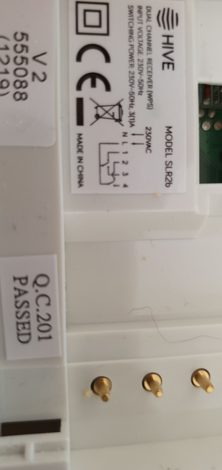

I suspect hive will connect here. temp.jpg I suspect the three cables to right go to pump, and two to left turn the boiler on/off.
So I would suspect the bottom brown will need taking out and will go to 3 on hive, the blue clearly neutral and the green yellow clearly earth, the two wires to the left will need the link removing and testing to see which is line, and line will go to live (miss named on hive instructions) and the other to 4 on hive.
However there is a lot of guess work, which needs confirming first. So does that cable to right go to pump as I suspect? and is one of the wires on the loop permanent line?
Many oil boilers do simply switch on/off, but not all, and in some cases turning off power can over heat them. I have guessed C Plan, that means when boiler stops it can cool by heating the domestic hot water (DHW) which can't be turned off. This cooling I am told is required and is why many oil boilers are plumbed as C, Y Plan with the latter default is DHW so it can thermo syphon through the pump even when switched off.
Remember I am guessing, it is down to you to work out if my guess is correct.

I suspect the wiring will be some thing like this
However would like confirmation that the cable is going to pump, and that 1 and 2 are the right way around.

I'm thinking I've worked on something from this range and the control panel hinges on one side, maybe a couple of screws on the right side and hinge on the left. Take great care as you hinge it out as the thermostat capilliary may not be free. a decent pic of the rear of the panel should clarify the wiring of that connector.
Sorry in advance if I have the wrong model.
Thank you for your detailed and helpful response ericmark. I can confirm neither number 1 not number 3 are permanent live, and you are correct 3,4 and 5 are going to pump.
In the configuration above the hive will power and a respond to the thermostat controls,however it will not switch the boiler.
However if I connect the permanent live into the fused live I can switch the boiler using the thermostat stat
