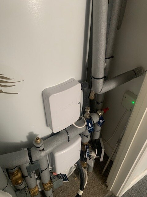

House setup - Ideal Logic H18 boiler and Kingspan Tribune XE, Hive active heating installed with multi zone (2 controls) Hive dual channel receiver wired to the boiler and a single channel receiver wired to the Tribune XE.
We have been having issues with hot water delivery. An electrician checked wiring and suggested we should have a dual receiver fitted to the Tribune instead of a single receiver. Does this sound right? Why would this be?

Are you sure the single channel is wired to the tribune and not just the wiring center?
Photos of cylinder cupboard would be beneficial here.

Thanks for the replies. We have been experiencing very little hot water during hot weather periods (I guess this is because the boiler is not firing up, therefore the water is cold without additional heat?).
Multi zone was originally in the house when built (main bedroom/en suite is separated from the rest of the house)
The single channel receiver is wired to the white box at the top (image below), I believe this to be the wiring centre.
Apologies, I think this is actually the wiring centre* that the hive is wired to.
I would say your sparks is correct.
I take it you have 2 heating zones?
The cylinder should be wired to the correct channel of the dual channel one heating zone on other channel. Single channel receiver to do other heating zone.
I can see two motorised valves
but from picture can't work out how connected. To have a Hive two channel and single channel I would have expected three motorised valves, but the levers on the valves
will go slack when activated, so you can work out what does what.
In the main the thermostat/programmer works the valves, and valves work the boiler, and there are micro switches inside the valves which have been known to fail or stick. So if it did work, and then stopped would be looking at motorised valves.
