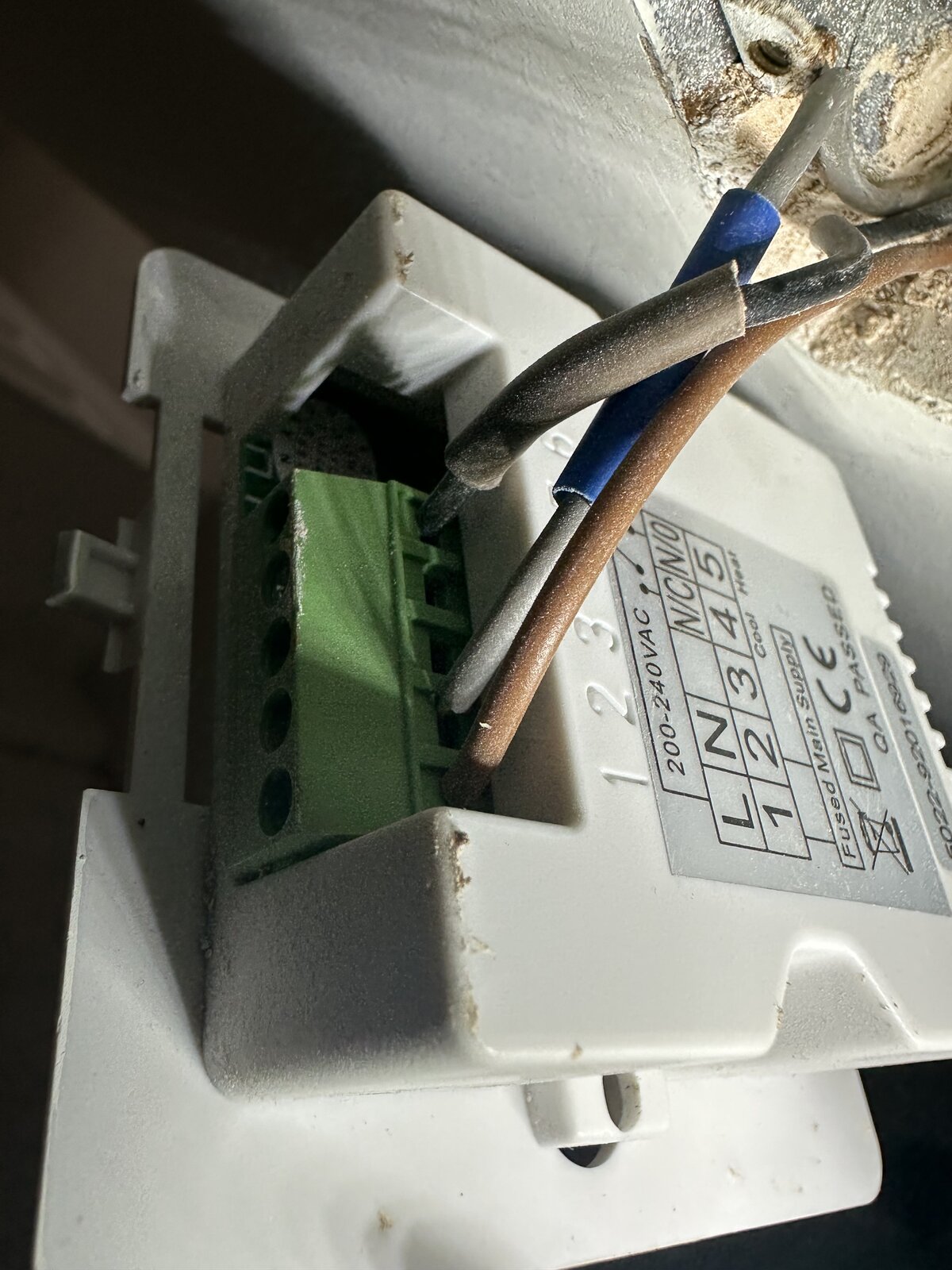

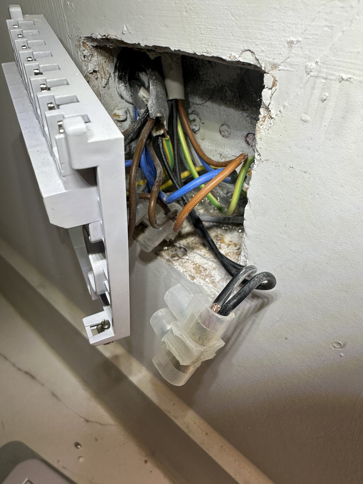

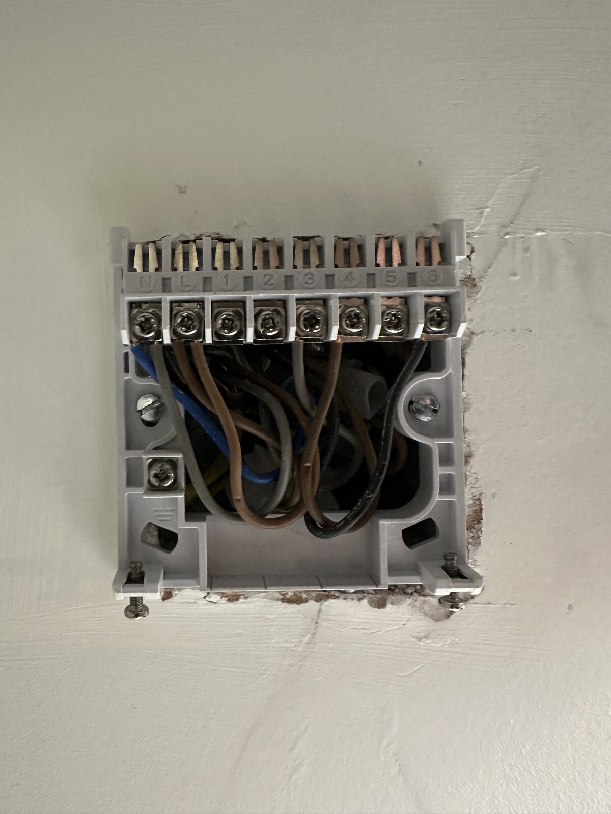

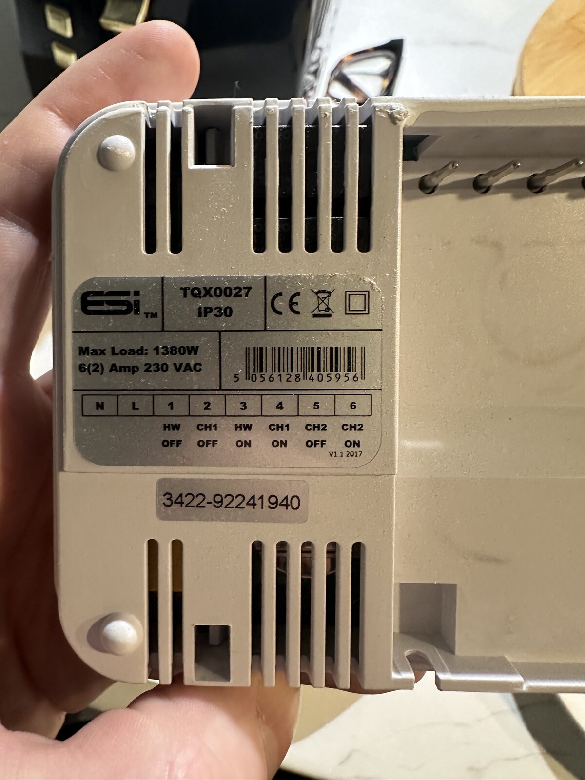

I have an Ideal Heat2 H15 boiler (Ground Floor) with a ESI Therma tqx0027 programmer; unvented cylinder with it's wiring centre on the 1st floor - with two ESI ESRTP5 thermostat's on either floor.
I know I would need a Hive Dual Channel Receiver and a Hive Single Channel Receiver in place of the current programmer.
My understanding would be that both receivers - to pick up the L, N & E from the current programmer feed's cable. The Dual Channel receiver would also take the cable 3 & 4 from the current programmer into the new receiver. The single channel receiver would have it's link between L and 1; with the cable from programmer's 6 position to the receivers' 3 position. Is this correct?

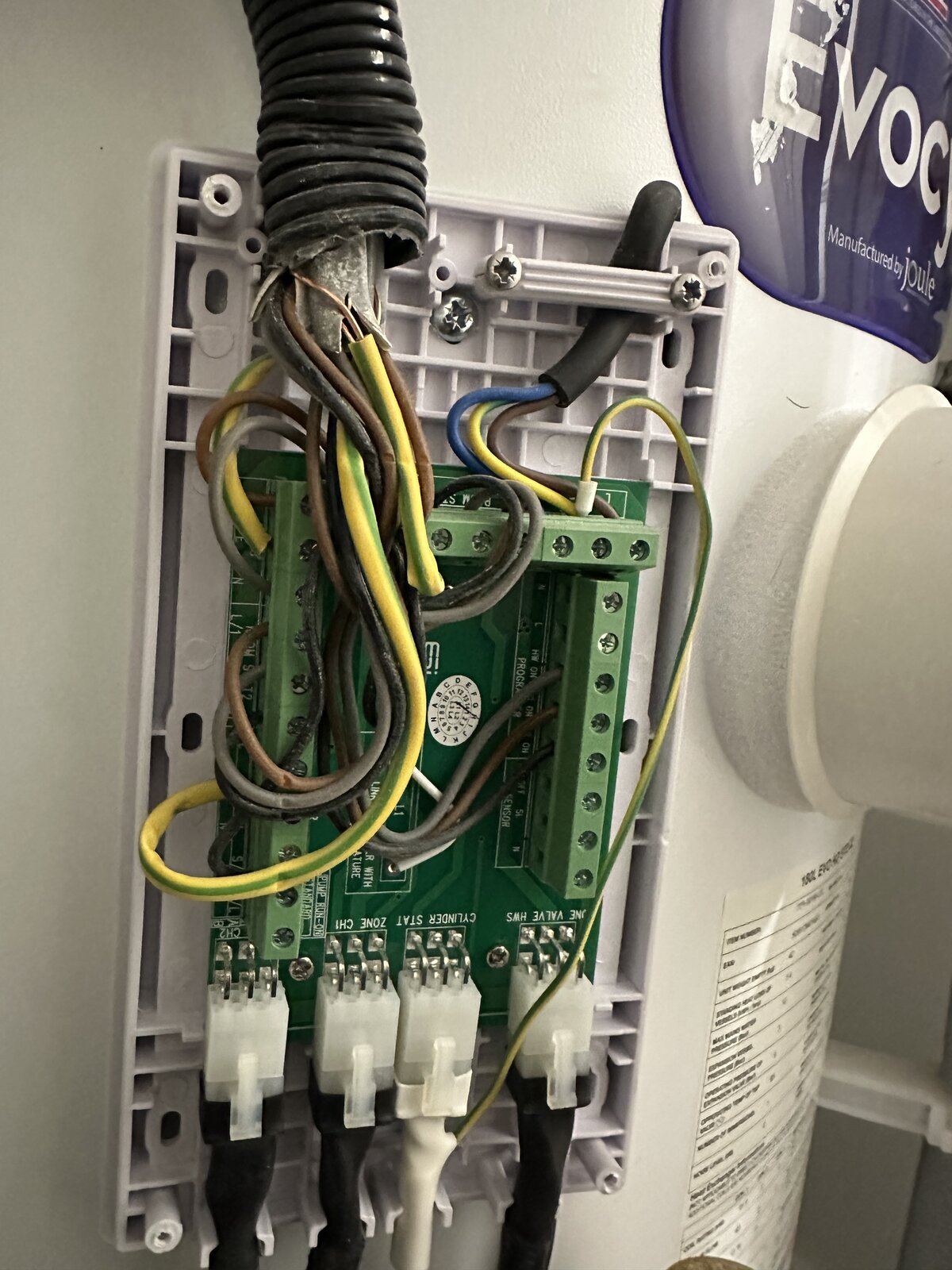

The switch live from the 4-core from the boiler direct comes into the back box and then it's goes into a connector block and direct up to the wiring centre - albeit not sure at this point which cable that is at the wiring junction box.
I'm used to the more standard wiring junction box 10/15 ways and never worked on the set up i have now - so currently above my knowledge set.

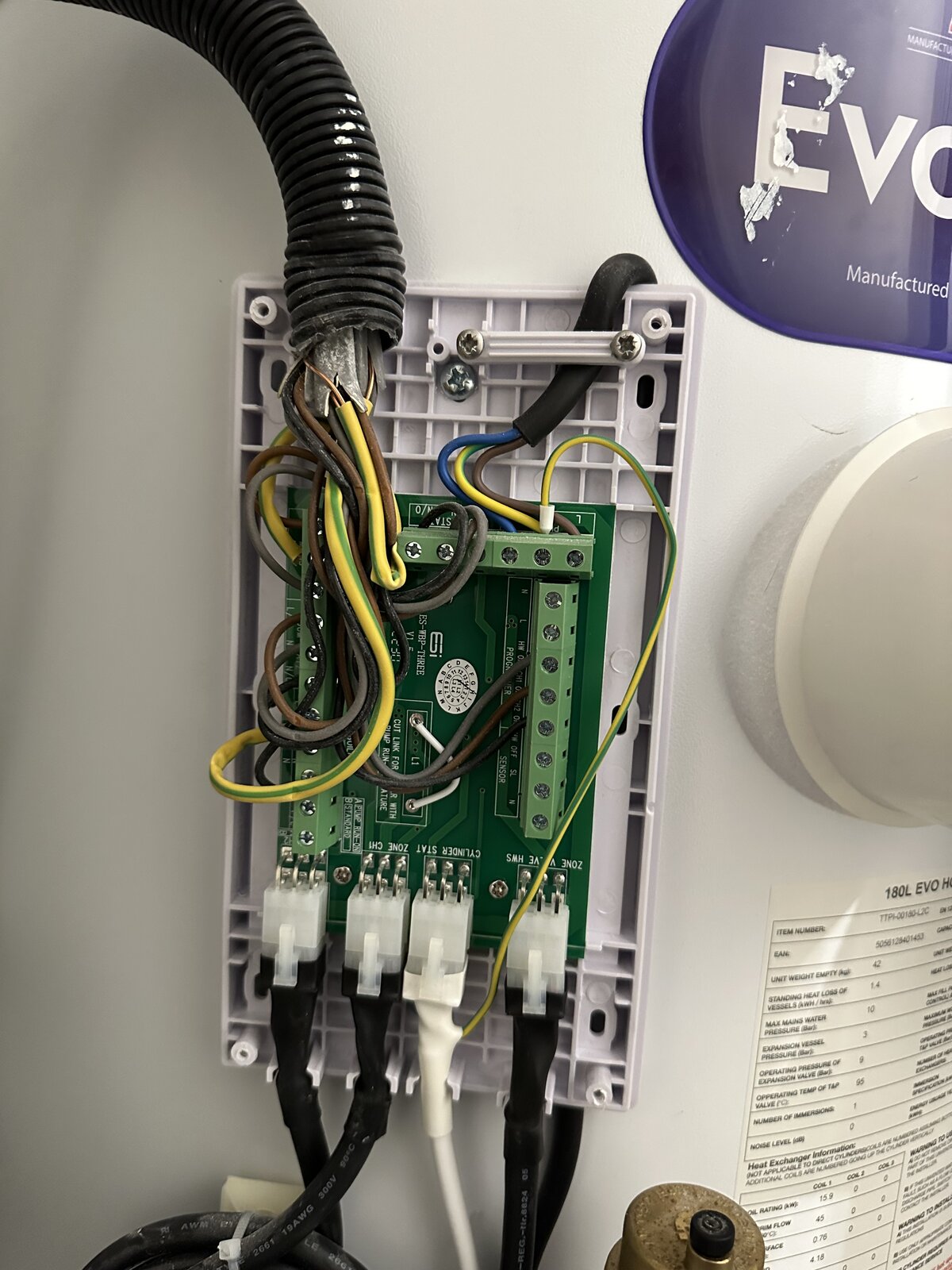

For extra information for the wiring junction box -

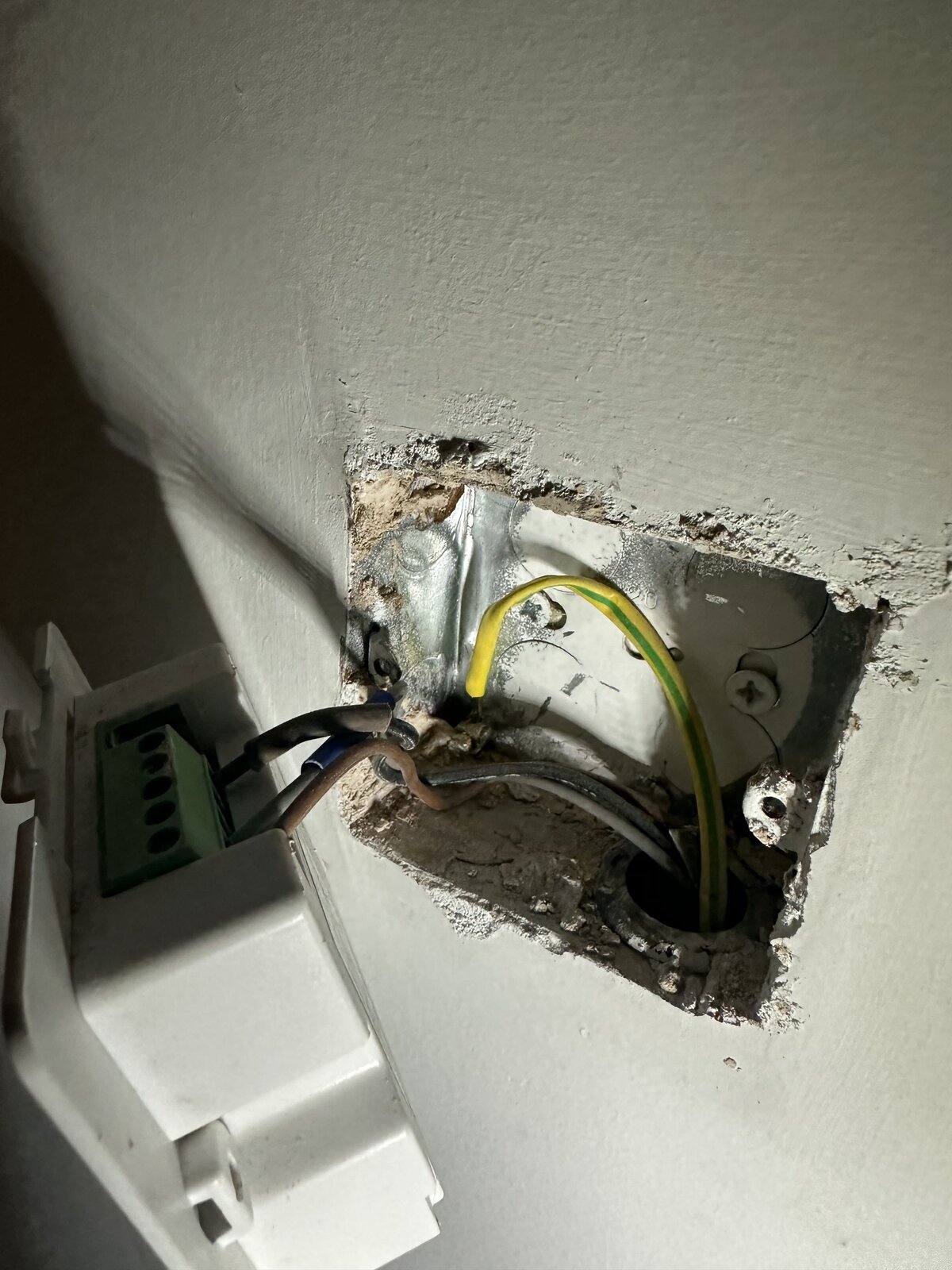

The thick black cable to the top right is for the system pump; the three cables to the immediate right of the pump cables (black, grey & brown) are for room stat 1.
The three cables mid-right by themselves are under the programmer section (HW On, CH1, CH2 - top to bottom).
Top left is marked up for the mains feed; directly beneath are the three cables for room stat 2.
Then there is an extra earth and black cable for L/S those i must admit it doesn't seem clear to me what that cable specifically does.
How would i go about this area's work? Would it be easier to link out at the existing programmer's position and have the receivers upstairs somehow?
Ideally i would just decommission the wires at the existing thermostat positions and have the wireless Hive Thermostats in the same positions.

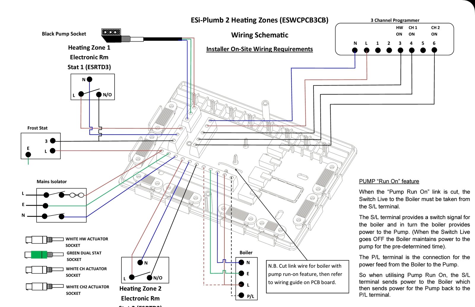

Can you confirm that this image matches your wiring centre?
If so:
Personally, I would decommission the existing controller and stat wiring - it may be useful to keep it in place for future needs, but safely isolate it.
I would wire up the dual and single channel Hives directly to the wiring centre.

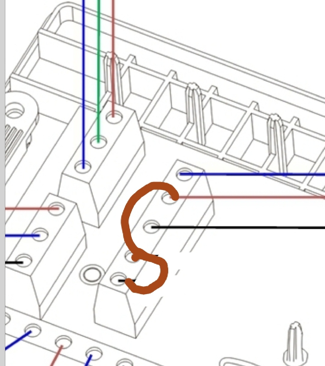

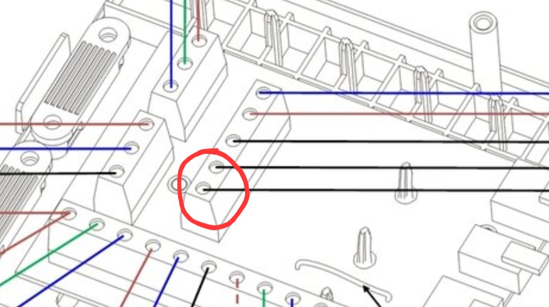

These two connections;
that would connect to terminals 4 and 6 on the programmer (CH1 on & CH2 on), I would bridge both to the L feed with a couple of short link wires, I.e.
The HW on terminal - that would connect to terminal 3 of the programmer, would connect to terminal 3 of the dual channel Hive.
Then connect the heating zone 1 terminals to the dual channel Hive - N/O to Hive terminal 4
Connect the heating zone 2 terminals to the single channel Hive - N/O to Hive terminal 3 and add a link wire between L and terminal 1 on the Hive.
I hope that makes sense!
Edit:
The board isn't quite the same, but the principle stands!
