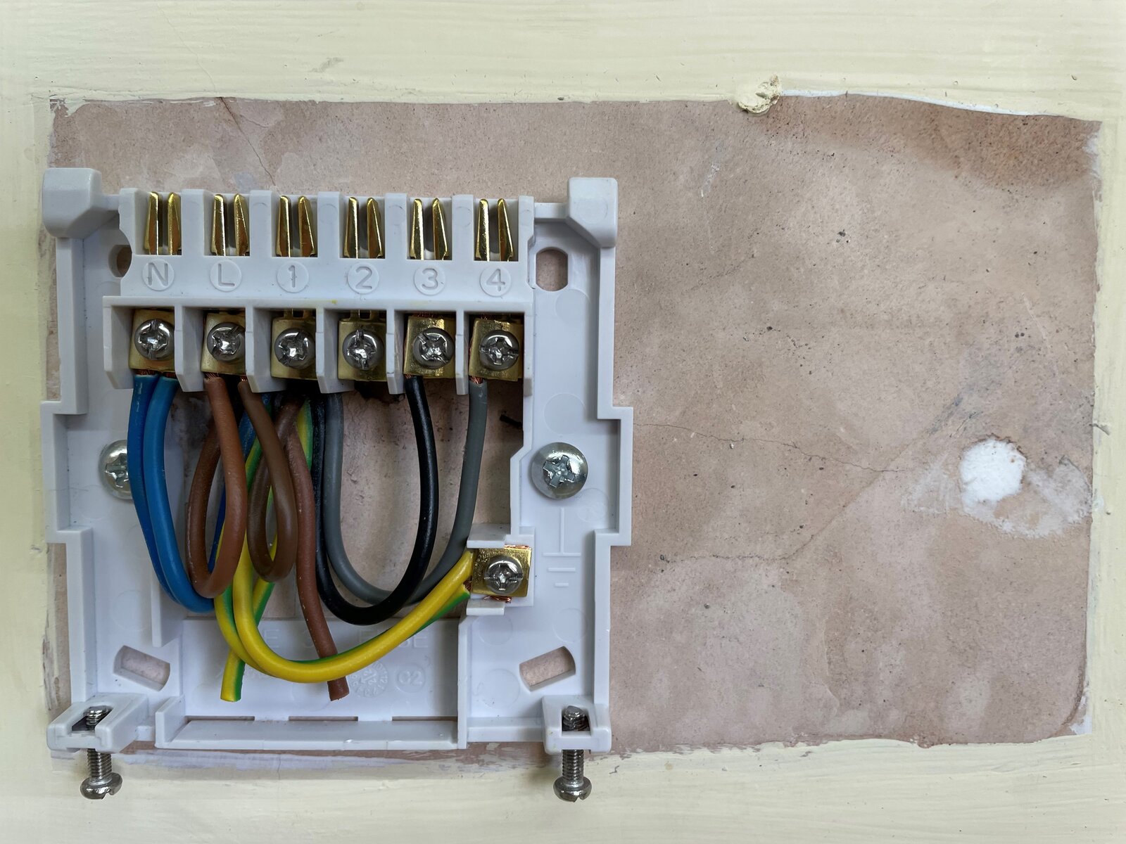

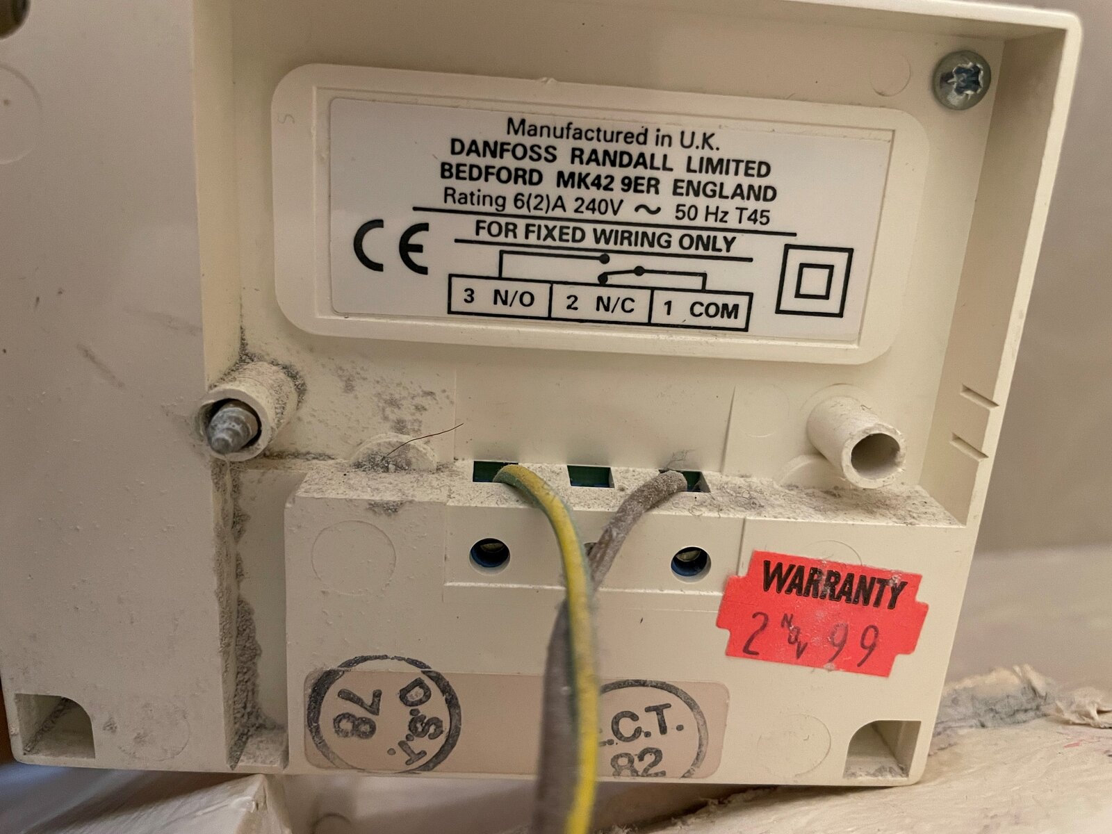

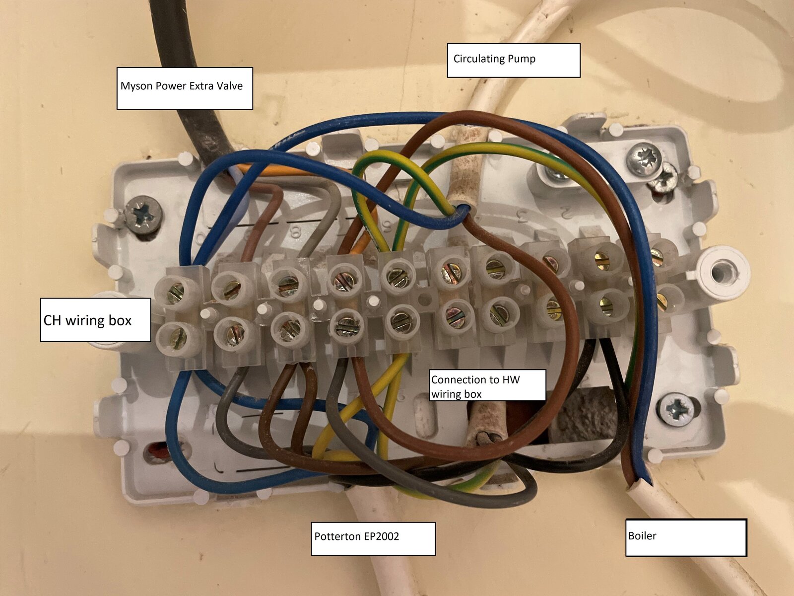

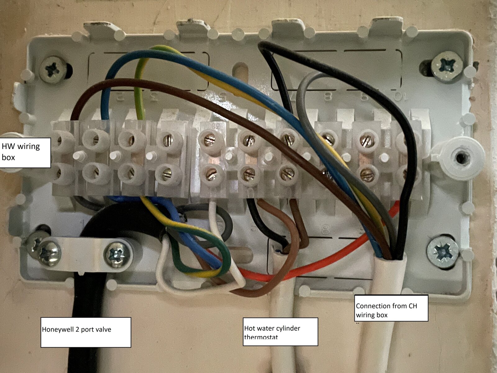

Hi, hope someone can help me out.
I'm installing a Hive central heating and hot water control replacing a Potterton EP2002 and Danfoss CH thermostat. I'm struggling to find where the CH thermostat is wired back to so I can remove it completely and bridge the connection. I cant find the connection to the CH thermostat in either of the two wiring boxes. I'm wondering if there is a work around? Or if I'm missing something?
Current system consists of:
Potterton EP2002 / Danfoss CH thermostat.
CH wiring box connecting boiler, circulating pump, myson power extra valve, connection onto HW wiring box.
HW wiring box connecting Honeywell 2 port valve, HW cylinder thermostat and connection from CH wiring box.
I've added photos of all the above and wired connections marked with text boxes.
Replacing the Potterton EP2002 with the HIVE receiver seems pretty straightforward. As per the photo:
EP2002 terminals 3 & 4 directly replicated to Hive 3 & 4.
EP2002 terminal 5 to Hive live and bridging wire removed (Hive does this internally). Neutral and earth wires to the same in the Hive.
EP2002 terminal C wires connected together in a terminal block separate to the Hive receiver.
Locating the end point of the CH thermostat cables is doing my head in. There must be a connection somewhere I can't find. Don't understand why it wouldn't be wired back directly to the CH wiring box. Unless I cant see it!?
Thanks for your help in advance.

I think that it is the brown wire in 4 at the ep2002 and the earth wire (which has been used as a switched live) in C.
So disconnect both of these and put the grey wire that is also in C to 4 on the Hive.
There are several items to look at
On the EP2002 you have
terminal L with link to 5, also in 5 is another brown core.
terminal C with a grey & green/yellow connected together
For the Hive
connect both browns from EP L & 5 into Hive L having discarded link brown (L->5)
connect EP N into Hive N
connect EP #3 into Hive #3
connect EP #4 into Hive #4
connect the pair of green/yellow cores into earth tether on Hive. Note keep the green/yellow in EP terminal C completely separate.
nothing in Hive 1 or 2
connect together in a terminal block the pair of wires previously in EP terminal C
As for the thermostat, easiest at this stage is just turn up to max pending locating the wires -or- just put the pair of cores at the thermostat into a common connection on a terminal block.
Do you have a multi meter. You can then check if the brown in EP #4 or #5 is the same as seen at the thermostat. Likewise is the green/yellow the same as seen in EP #C. Looking at the pictures I cannot spot the rogue green/Yellow from the EP terminal C. Certainly needs some investigation.
Based on S-Plan wiring the output from Hive#4 should go to the roomstat and then when demanding heat back to live input for the CH 2-port valve.

I thought I'd do a test of the above solution in the existing EP2002. Disconnected the earth wire (used as a switched live) in C and the brown wire in 4. I moved the grey wire from C to 4 in the EP2002. I then used the manual control on the EP2002 to switch the CH on and off. It works! The existing thermostat is isolated and has no function on the CH. HW function also not impacted. All good.
Now I know it works it is a hassle free transfer of the same wiring to the Hive receiver. Thanks once again Johnmdc much appreciated (y)

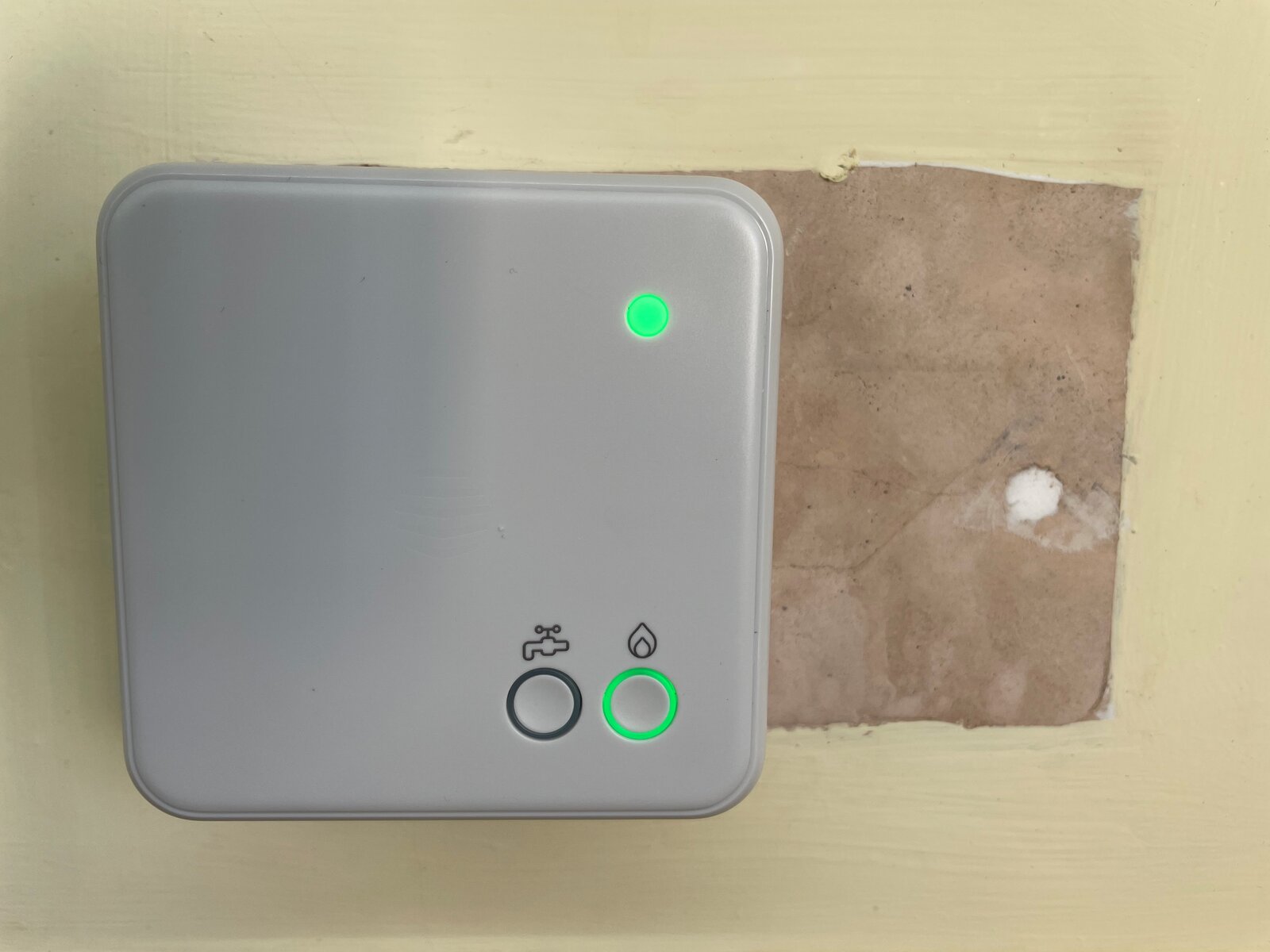

Transferred the wiring from the EP2002 as above to the Hive receiver backplate. Hive all set up and working for the past few days no problems (y)

Hi guys, I've got a problem with the Hive now. It's been working fine for two weeks no problems until yesterday.
Basically the CH is running on regardless of the target temperature set on the thermostat. However the CH green light on the receiver is off with no error lights main status light green. Also CH in the app and on the thermostat is off but the heating is running on. Switching the CH on and off at the receiver, thermostat and app also does nothing it carries on working. The only way to switch the CH off is switching the power off to the receiver / boiler and leaving it for a while. Resetting / rebooting the whole system. Note this has only happened a couple of times yesterday and today. Otherwise it has been working no problem.
I did swap out the Hive thermostat with a Hive mini thermostat last week purely because I preferred the smaller thermostat and use the app. Hive customer service deregistered the the original Hive thermostat from my set up. Confirmed all was working fine with the Hive mini. Could it be a problem with the Hive mini? Or a failure of the receiver? Or my wiring!? Note I did do a factory reset of the hive mini yesterday but the same issue has happened today.
The only other thing to mention is that the issue seems to have coincided with the HW button being pressed on the receiver leading bizarrely to the CH running on. Note HW water button is green and lit but CH is off on the receiver. Again HW and CH have been functioning independently with no problems up until now.
Anyway any ideas appreciated!
Cheers
Chris
Is this just the normal 3 minute boiler/pump running to cool the boiler down?
Thanks for the response. No you can hear the boiler gas jets are active and heating. I came home this afternoon and the thermostat had hit 24 degrees with a target set of 18.5. The missus and the kids said they thought it was hot!
Note as above this coincided with my son turning on the HW boost at the receiver. The same thing happened yesterday. When I came home HW light was on at the receiver (my son confirmed he had turned it on). Again the heating was also running but no CH light on at the receiver. Could be a coincidence.
Could it be a boiler fault? Or the CH valve not closing? My understanding is If the central heating light on the receiver is not lit then Hive is sending no commands to the boiler.
