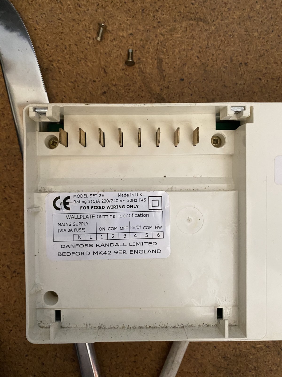

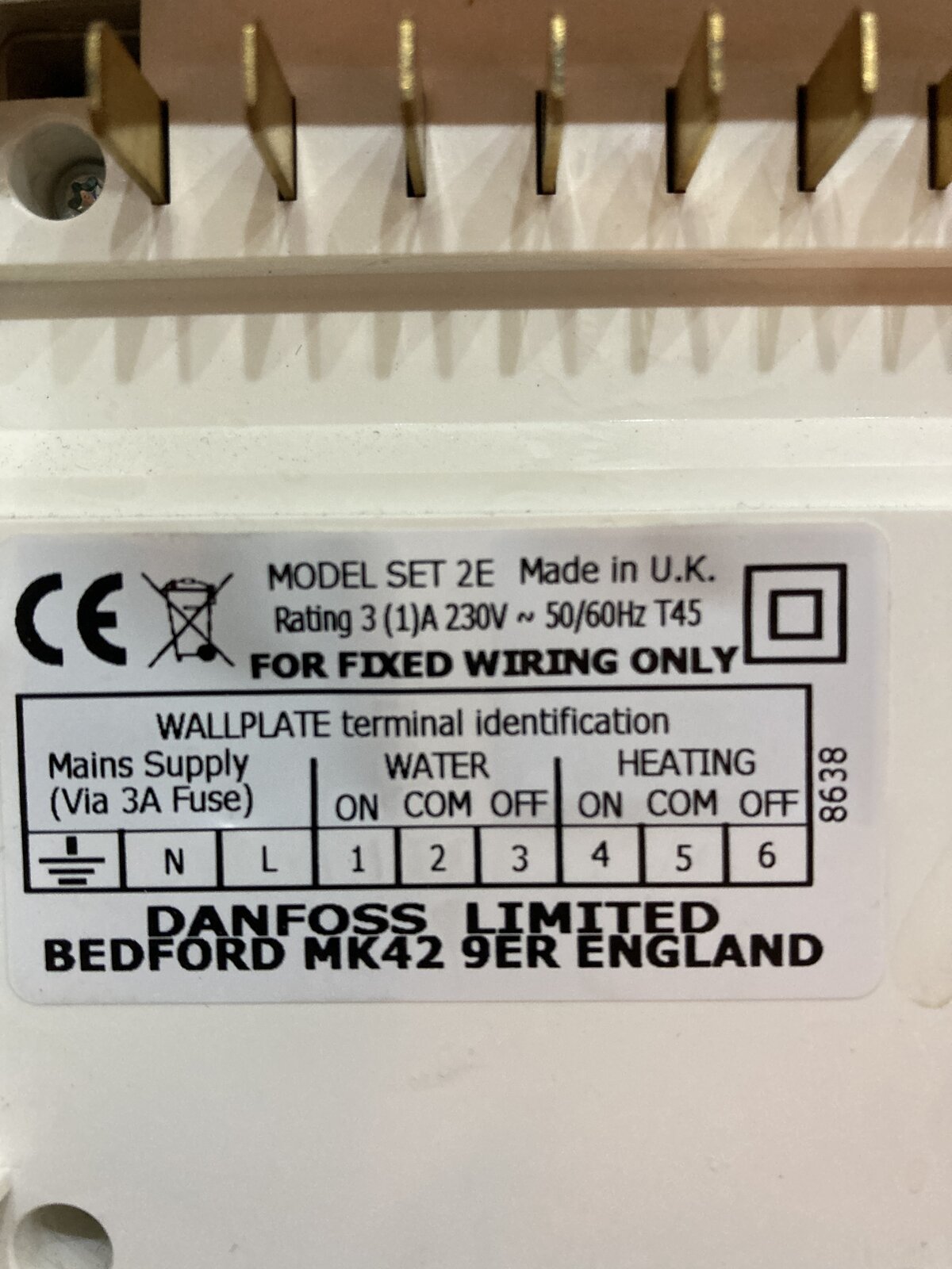

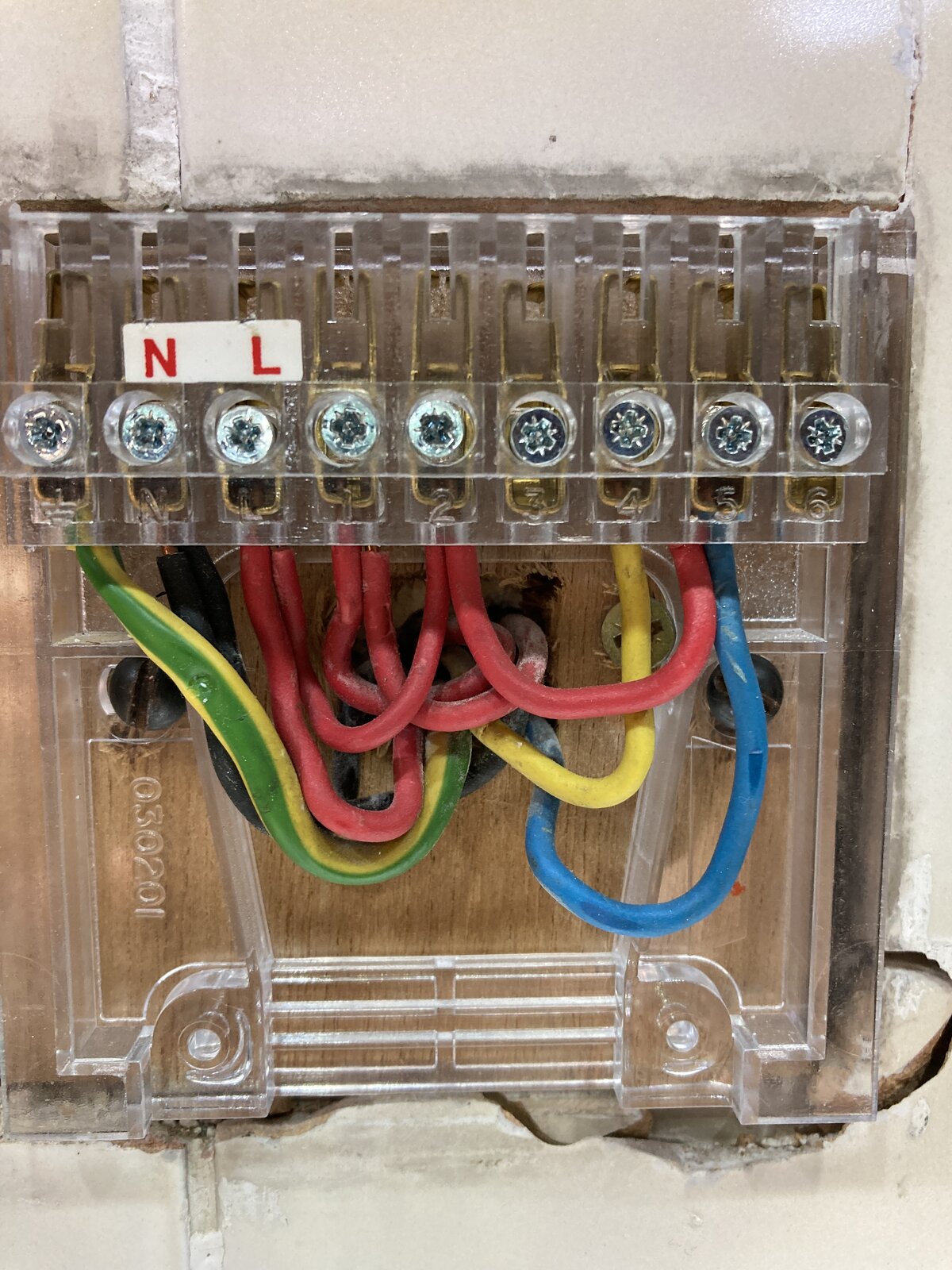

The current programmer is a Danfoss SET2E. I’ve included a picture of the wiring. We have E, L, N, 1 (DHW N/O), 2 (DHW Com completing circuit of N/C with 3), 4 (HTG N/O) and 5 (HTG Com completing circuit of N/C with 6) currently in use. I’ve also included a photo of the back of the front plate.
It looks like we have cables connecting L to 2, and 1 to 5.

I was able to connect Hot Water On, and Central Heating on, like for like to Hive (so 3 and 4 on Hive). N and L of course transferred to the new programmer like-for-like.
I removed the connecting cables that ran from L to 2 and 1 to 5 on the old programmer and did not try and replicate this on the new Hive system first: my logic being that since we had two clear cables that controlled the switching on off hot water and central heating separately, likely this would be enough because, when either was on, it is on, and when hive has it off, it is off: it shouldn’t need prompting via any other cables.
The result was that I’m not sure why the connecting wires from L to 2 and 1 to 5 were ever there, perhaps the old programmer required it: it was not required in the new system.
So in sum, I was able to transfer L N HW-On and CTH-On like for like to the new system, and the system all works as expected!

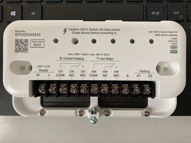

Hi, came across this post as I am searching for a similar solution. I am attempting to replace my Danfloss SET2E with a Tado smart heating system (Tado wireless receiver).
Most of the wires I can identify to the corresponding terminals in the smart wireless receiver. I can see that I have 2 bridges (L, 2 & 5) which Tadop account for. However, I am not sure what 1 and 4 terminals correspond to or are equivalent to the NC or NO terminals in the Tado wireless receiver.
Any ideas?

All of the the wires, including the links. go from the terminals of the Danfloss SET2E to the terminals of the TADO which have exactly the same functionality.
As you have figured, most are straightforward to identify as they are the same [L, N, Earth, Water COM, Heating COM]
For the others:
ON = NO (Normally Open)
OFF = NC (Normally Closed)
