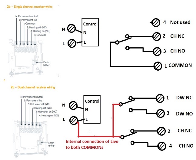

Hi guys I have a firebird slimline combi that uses a timer for both water and heating circuits. Looking at the hive options I think I need the dual channel and not the regular combi package? Any help appreciated
Thank you! The boiler has connections for room stat (just bridge these I assume) and switched live for the central heating and the hot water. The hive is it just a relay inside so I need to jump the live to the normally open connection?
nope no links required on the hive they are already made internally , then HW NO to HW switched live at boiler and CH NO to CH switched live at boiler and make a link between the thermostat connections at the boiler
nope live to both com connections
The dual Hive does not have access to the Com connections, they are both internally linked to Live
