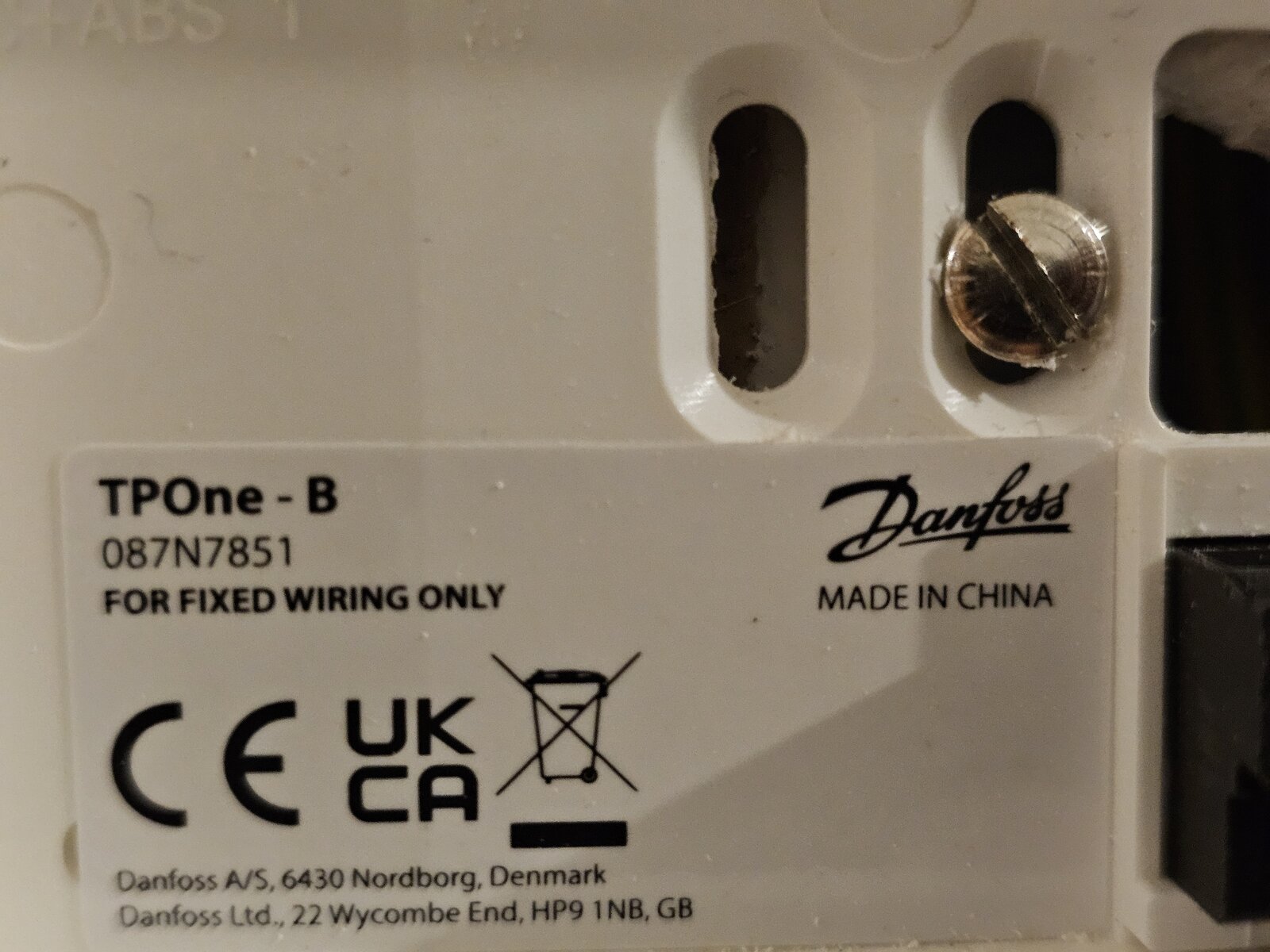

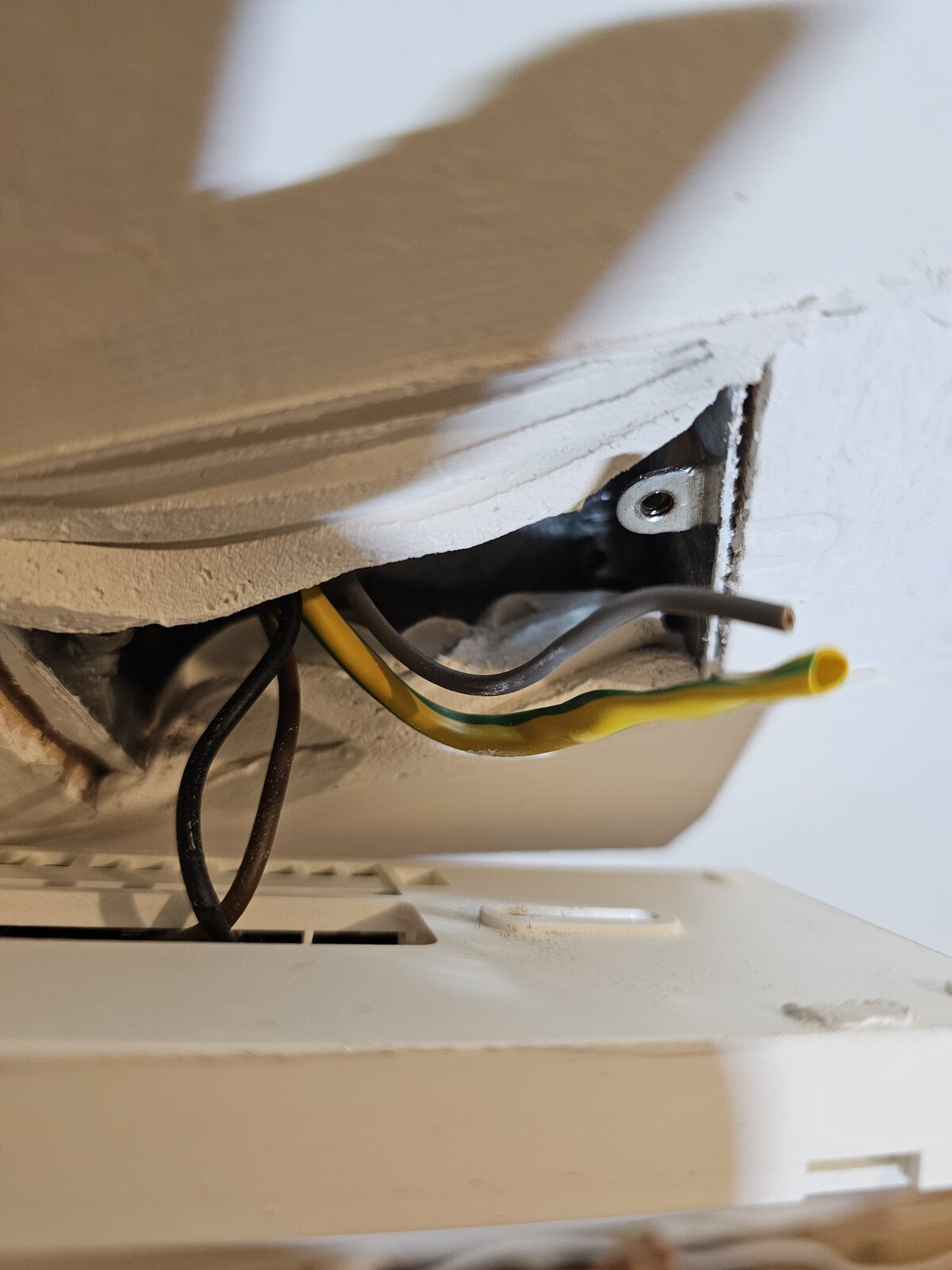

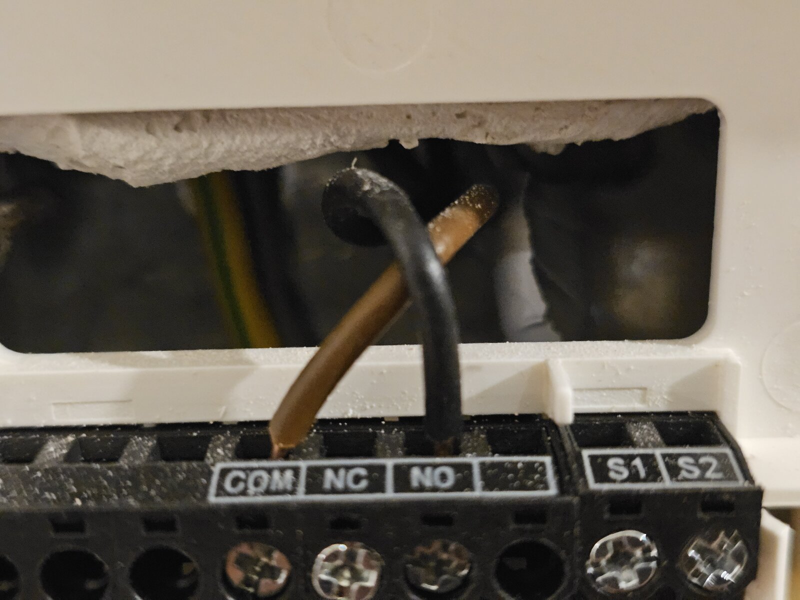

Hi All
Kindly asking for help.
Just moved to a property that has Ideal Combi Boiler with 2 Zones.
Each Zone has its own Thermostat - Danfoss TPOne - B
The TPOne is battery operated and acts as a Thermostat and Programmer hence there is no standalone programmer near the boiler.
I have got Hive Mini and Receiver from my previous property where I installed without any problems.
The wiring in the TPOne is just 2 wires Brown and Black. How do I install Hive receiver which requires L, N, Earth plus switch Live?
Also behind the TPOne 2 wires are not attached to anything. Grey and Earth
Thanks in advance

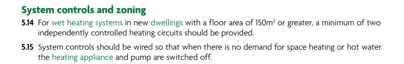

There is no "and" reading further through Part L approved document it does say:-
6.51 Comfort cooling systems should have both of the following controls.
a. For each control zone and for each terminal unit, independent control of both of the following
should be possible.
i. Timing.
ii. Temperature.
b. If both heating and cooling are provided in the same space, the controls should prevent them
from operating simultaneously.
but seems the only cooling needs a time control, it says
I know the approved document is not the law, but reading the approved document it does seem to question if using a zone valve connected to a thermostat would comply, one as it does not have a time setting, and two as at least with my house my rooms don't have the same thermal characteristics and temperature control requirements, each one is different.
It also raises the question is geofencing permitted? As this does not use time, but occupancy, or at least future occupancy, after a couple of cold days after high winds took out the EE mobile phone app, I disabled my geofencing, the problem was the PIR built into the Nest Gen 3 thermostat would put the system back into comfort mode each time we walked past, so I was unaware it was returning to Eco mode, and 16ºC was not warm enough for me, it was not until I went into the computer program did I realise what was happening.
Apologies to the OP, for the digression.
You originally stated that you were looking at the guidance on the LABC website, rather than at Part L - I quoted the "And" from the LABC technical update, from their website.
and I don't know which part of Part L you are looking at, but the intention seems clear..

Two things to note, first the grey wire is already connected to neutral - a little bit poor, considering it is just hanging out loose, in the backbox of your existing stat.
Secondly, one of the brown zone valve wires has been trapped by the lid of the wiring centre - it shouldn't be an issue, but just make sure its clear of the lid before replacing it.

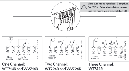

If you are happy with your single channel Hive receiver replacing the existing stat...
With the power safely isolated,
Connect the Brown wire to the L terminal of the Hive receiver backplate.
Connect the Grey wire to N.
Connect the Black wire to terminal 3
Put the Green/Yellow earth wire into Hives earth terminal.
Then add a short link wire between L and terminal 1.
