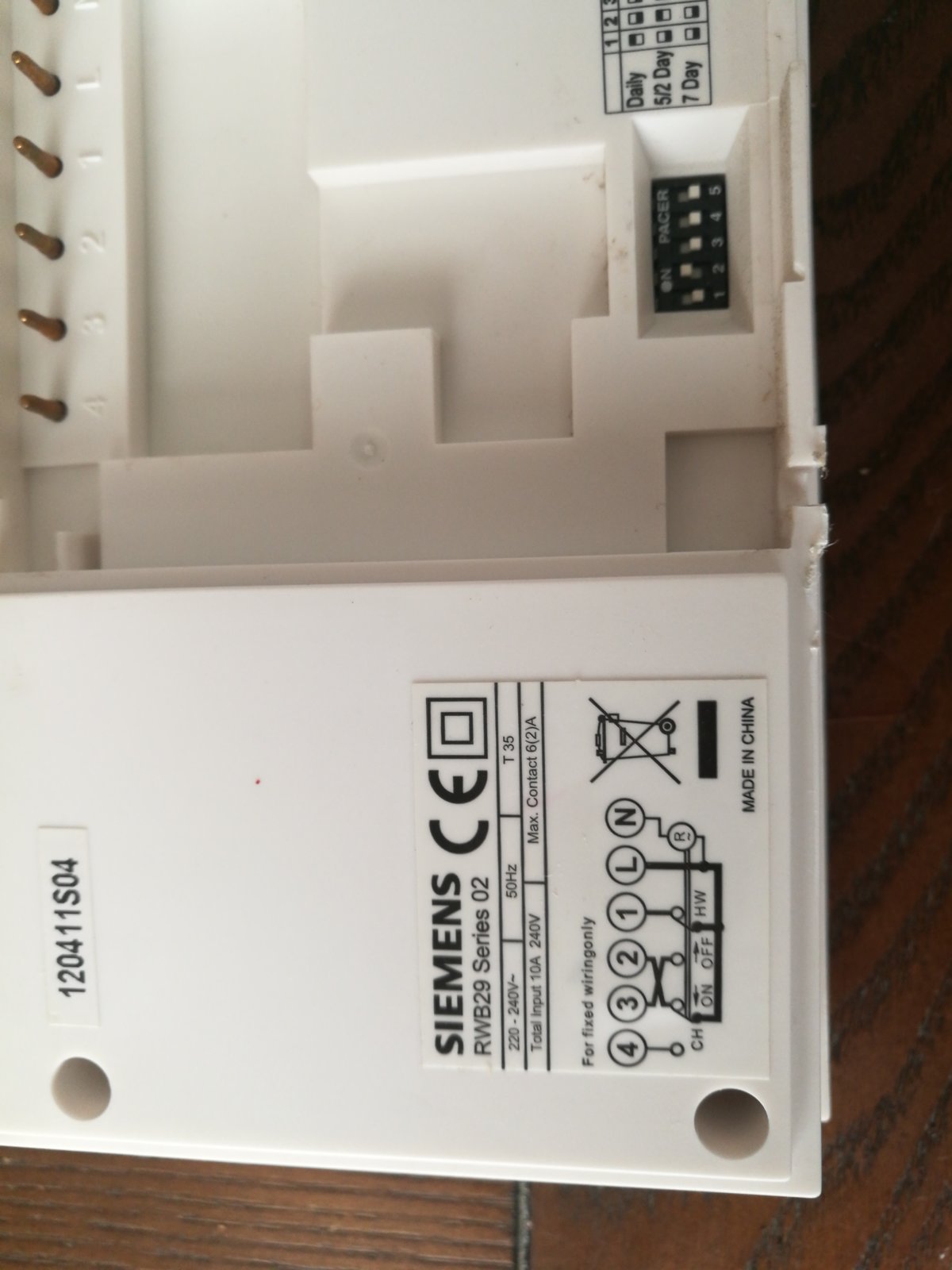

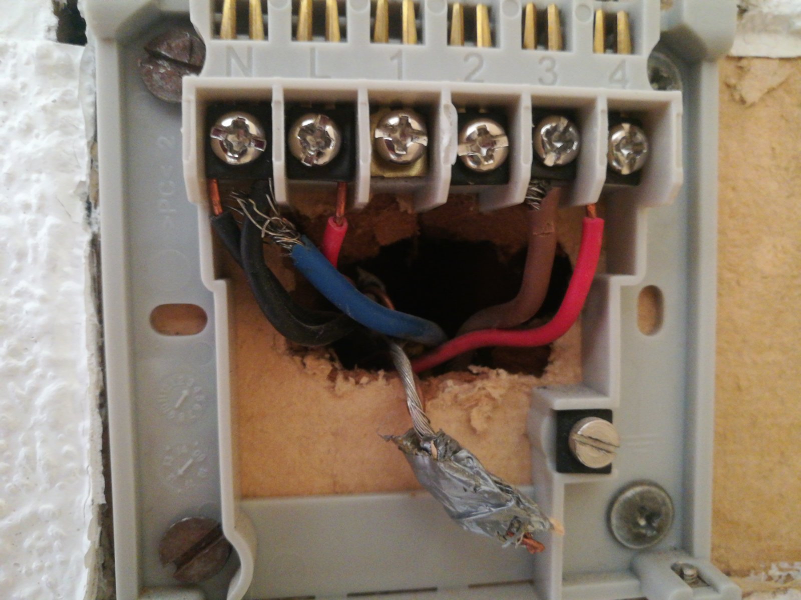

I am installing a hive onto my existing controls which is a Siemens RWB29 programmer.
Have attached photo of existing wiring, is it just a straight swap?

You seem to have been overlooked.
Firstly, what a disgraceful mess is your current wiring.

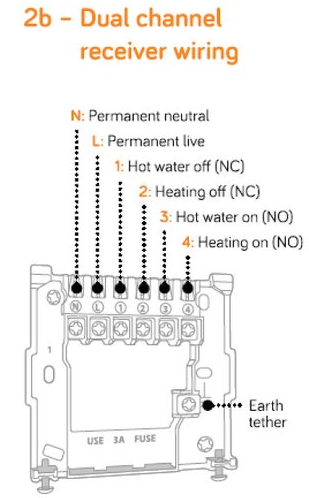

Secondly, if you have a dual channel Hive then it looks like it could be the same (depending on where the blue wire is supposed to be).
Were there no instructions with the Hive?
