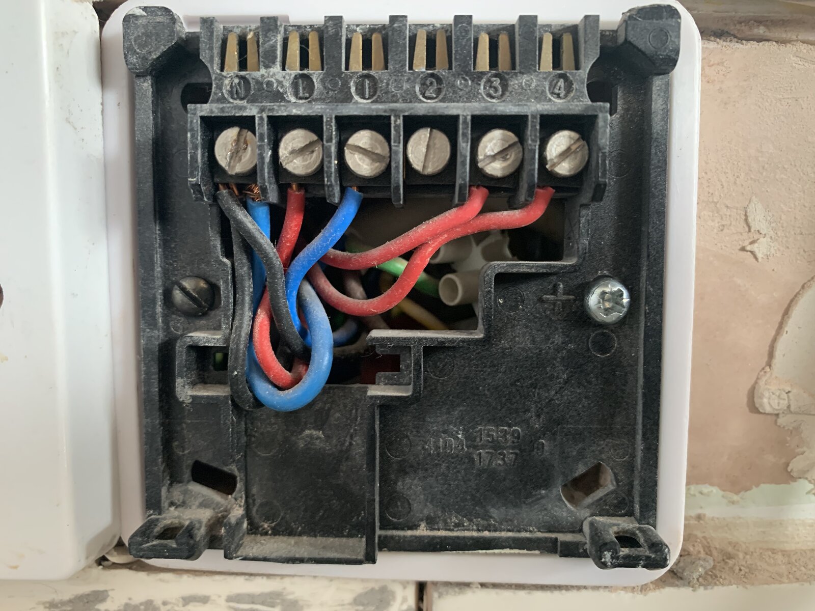

Hi there - looking for some help on hive wiring - I have an existing programmer that I can’t make any sense of the wiring on:

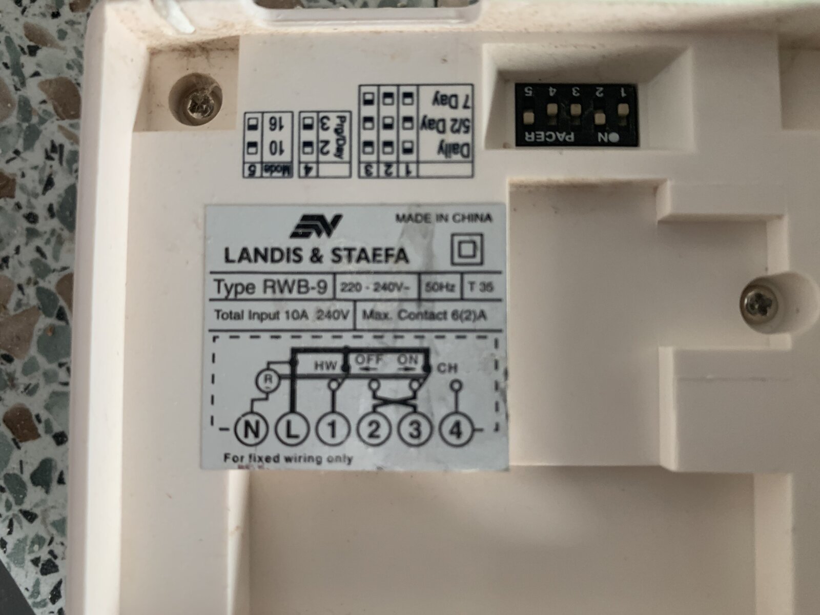

The diagram on the existing timer doesn’t seem to match:
I am trying to translate this to a single channel hive receiver. There is a wired thermostat in the hall that I planned to just remove and cap off the wires! Any help greatly appreciated.
you cant , you need a dual channel hive, you have a Y plan system
Well at least I know I’m not going mad - thanks for the response.
