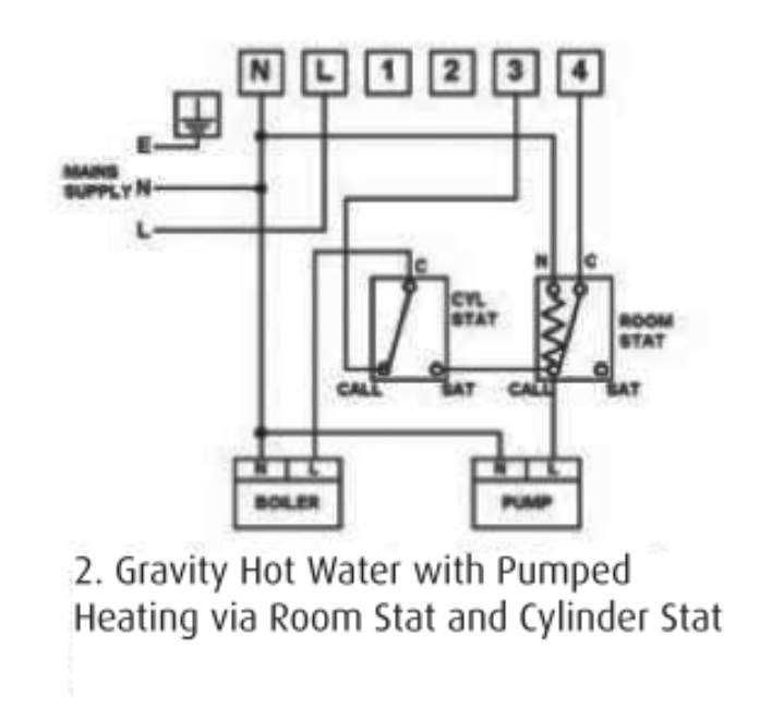

Im looking to have a hive installed in my house.
The current set up is using a CentaurPlus C27, using this wiring diagram in the attached files.
I have ordered a Hive duel channel receiver unit, to be installed by the electrician I normally use.

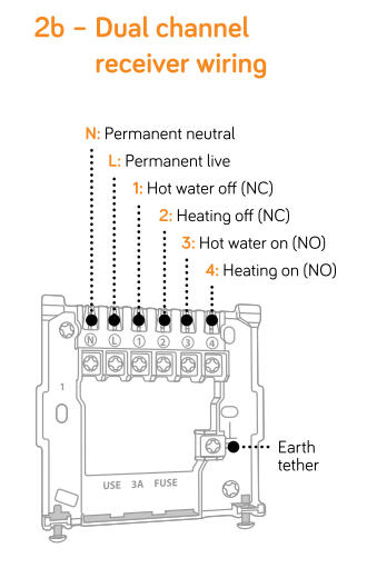

The hive installation diagram doesn't seem the most detailed, so any pointers that i can pass on to the electrician would be great. Thanks

I havn't seen a gravity hot water system in ages!
Anyway the Hive part is wired in exactly the same way as the old programmer:
N - N
L - L
3 - 3
4 - 4
Infact, if the bases are EXACTLY identical it should just clip to the old C27 Base, no wiring required. If not, swapping them over should take only a few minutes.

Would it be without 4? as the room stat will now be the hive room stat which is wireless.
The unit the OP is trying to wire is a 2 channel wireless receiver isn't it? The Hive fancy looking bit using this to controll both CH and DHW?
Or have I got it totally wrong?
Yes, which is fine as that is what they require.
It just needs to be set to Gravity, so that heating can't be selected on it's own.
The room thermostat also needs to be removed and the C and Call wires permanently connected together (or the thermostat set to maximum permanently and left like that)

I have just looked at the Hive manual and every single thing mentioned here is written in the installation instructions. In fact the manual is very well written and not poorly translated from another language.
It looks like the only issue with oil systems is that British Gas don't deal with them!
