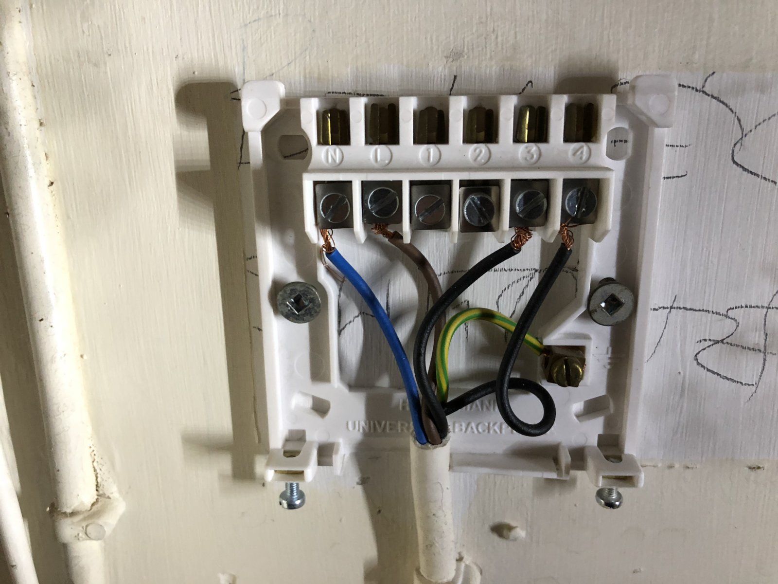

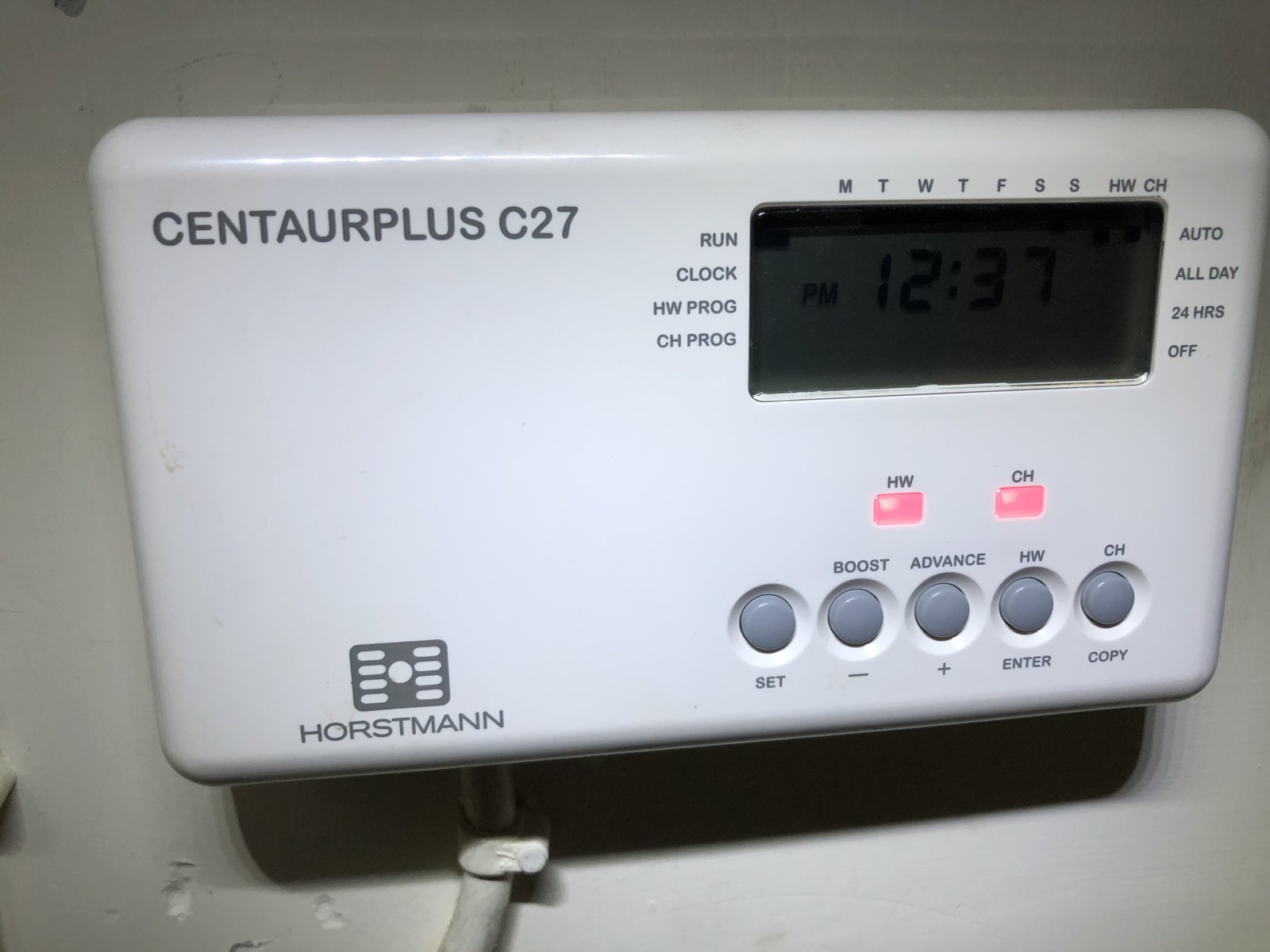

My system comprises a Baxi Solo boiler, with a separate Megaflow HW tank. The boiler is presently controlled by a Horstmann Centaur C27 Programmer and a Honeywell thermostat. I have opened the programmer and found that it is wired only to terminals 3 & 4. I'm assuming from this that it is a “gravity fed system” even though it is at mains pressure.

1. The Centaur backplate appears to be compatible with the Hive receiver (barring the wiring issue above). Is this correct?

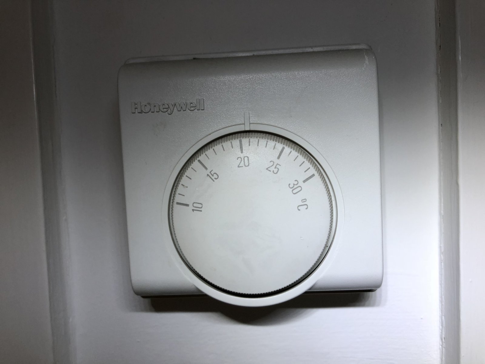

2. Do I take the existing thermostat out of circuit?

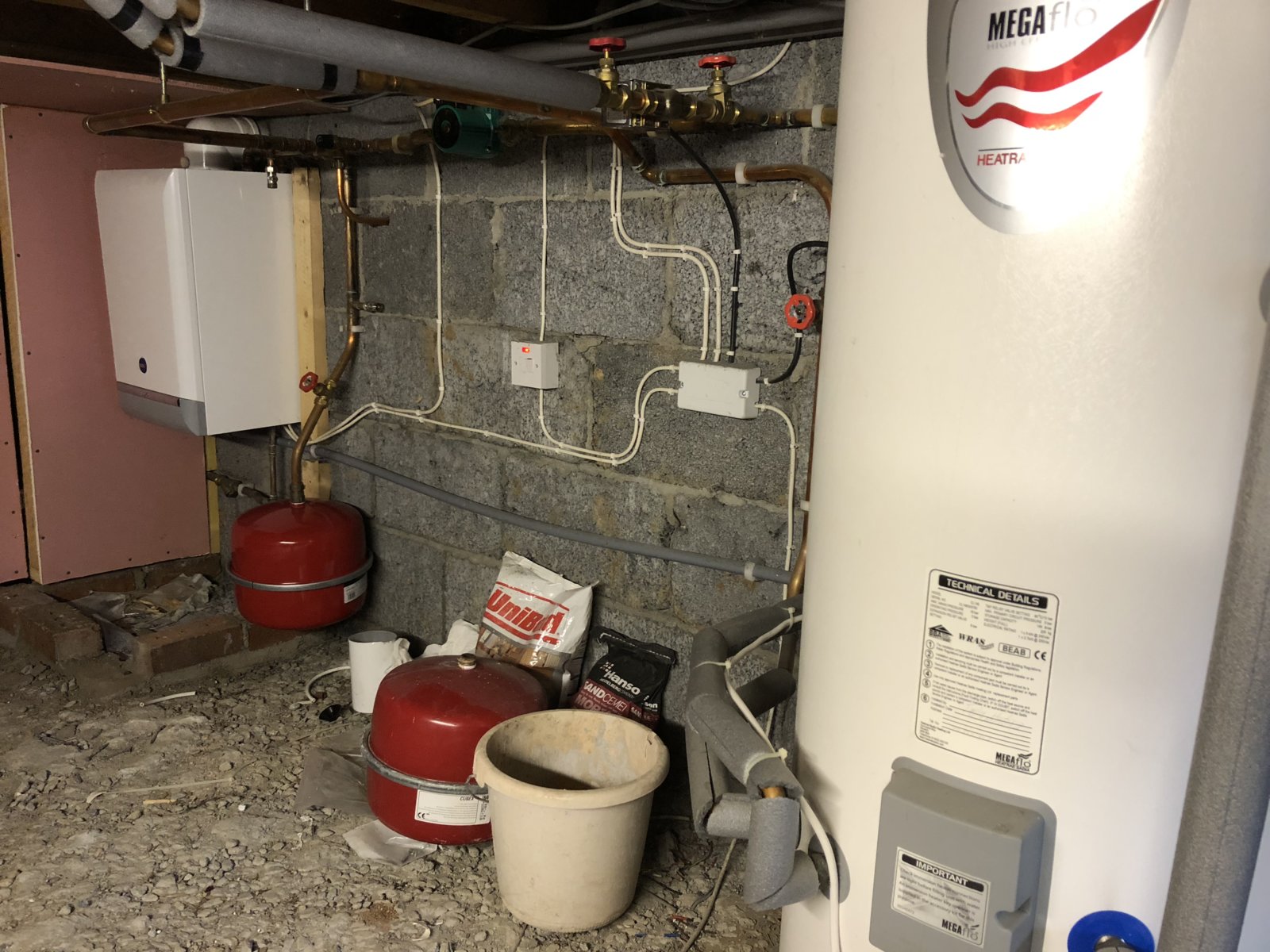

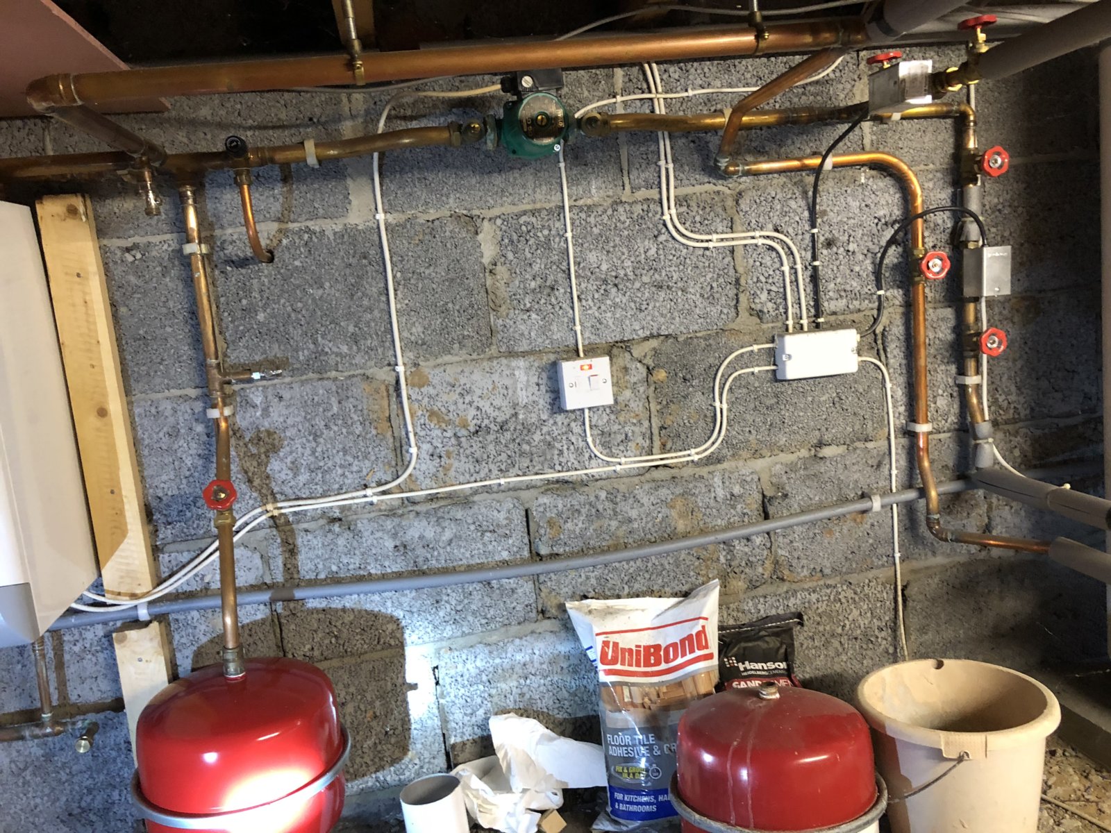

4. Do I need to do anything at the boiler end.
By the way I was pretty horrified at the quality of the terminations when I saw the backplate! I plan to tidy these up during the work.
Yes the connections are the same, (L&N) (3=HW 'on') (4=CH 'on') but your wiring is terrible. There should only be a small amount of copper on show and no whiskers poking out. The existing backplate will be old and whilst they are more or less compatible (sometimes they can be a tight / loose fit) but as you have a nice new one specifically designed for the Hive it would be daft not to use it.
Yes. Because the Hive carries out the functions of the room thermostat, the old wired thermostat needs to be decommissioned to prevent it overriding the Hive. It can't simply be disconnected as this would leave the heating wiring 'open circuit' and it will not operate. This is done by finding the origin of the thermostat cable. Note where the wires are connected to and disconnect the cable completely. Then link the terminals where the two ‘live’ switching wires came from together.
No.
