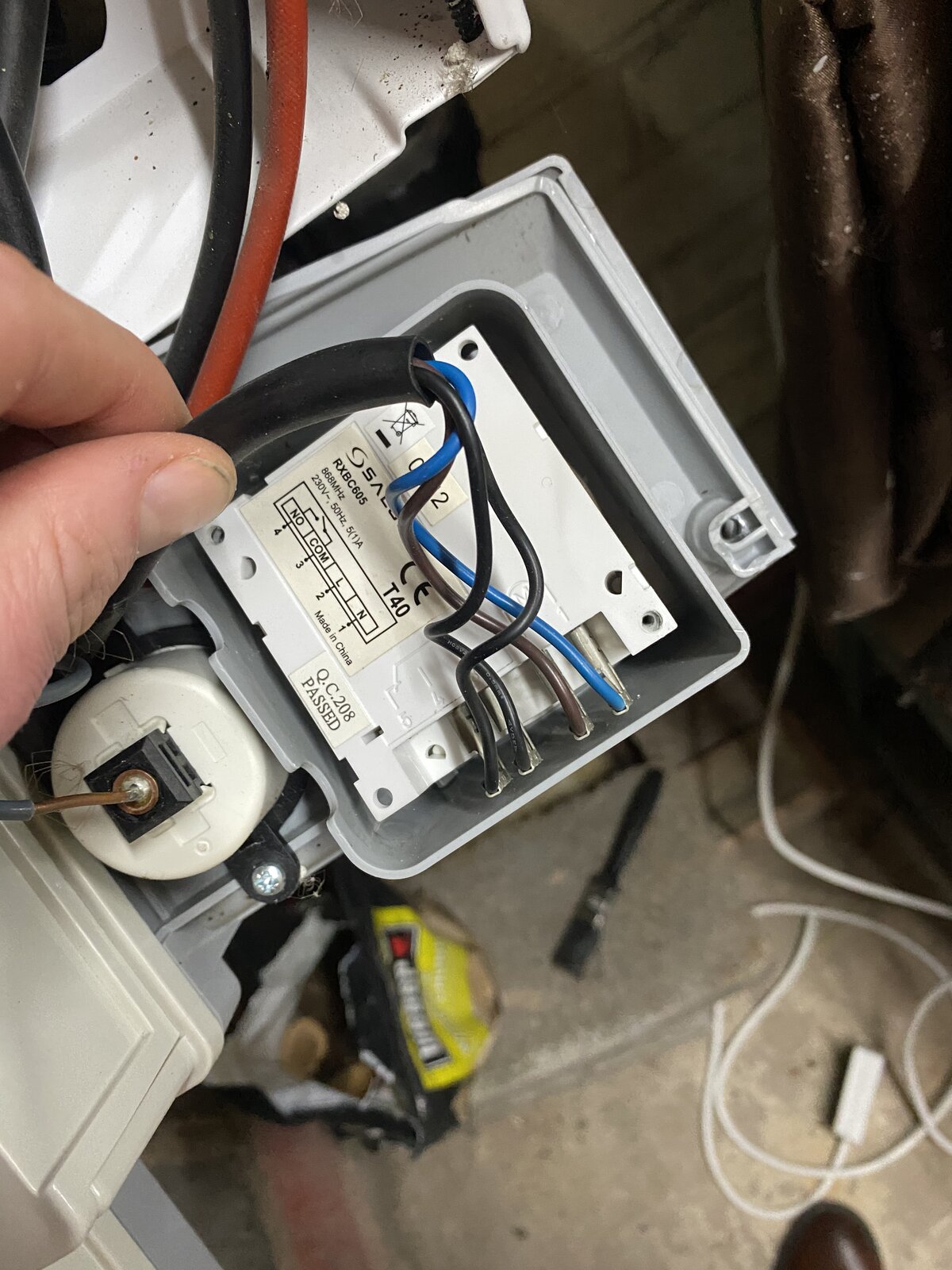

Hello,
I have wired the hive receiver to the baxi boiler as the instructions detail however it does not trigger the boiler. The boiler is already fitted with a Salus radio frequency timer / thermostat, I suspect this needs to be removed. Is this the case and how do I remove / link it out? Thanks
Of course it needs to be removed post pics of your wiring , you have done something wrong
Looking my at the wiring diagram I think 3 + 4 needs to be linked in the salus?
