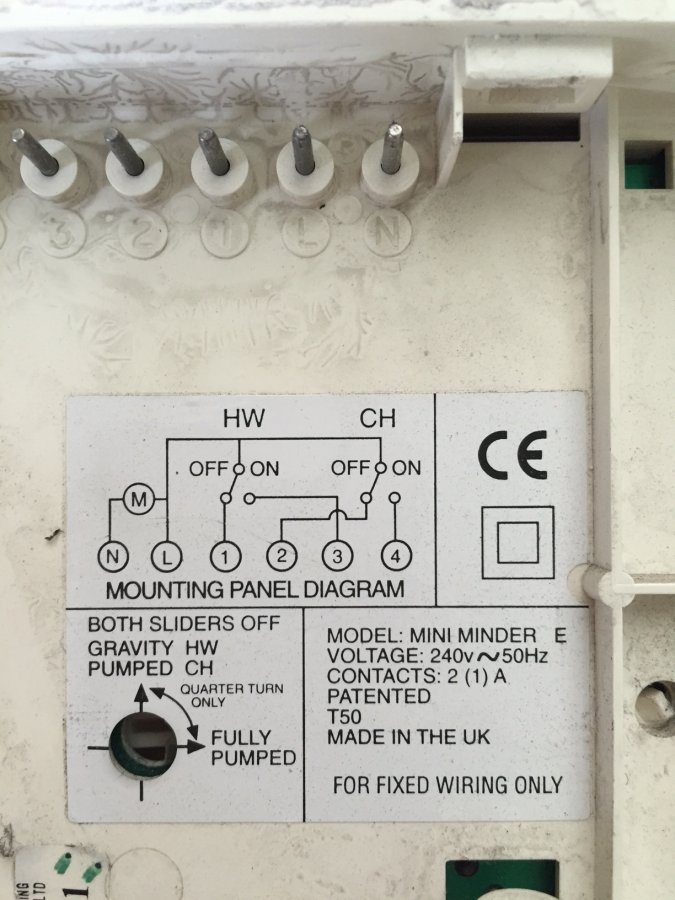

Here is the old timer back wiring Diagram

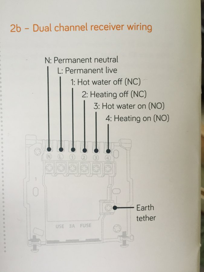

I have Installed the Hive backplate to the wires. Installed the Live, Netural & Earth Wires as per the instructions
I have the two Wires for the Hot Water on (pin 1) & off (pin 3) in the new Hive Timer. These were labeled from the old timer Pins 1 & 3
I have connected the wire from the Old Timer Pin 4 CH On to the Hive on Pin 4. The issue I have is what to connect to the Hive on Pin 2 for the CH Off. On the old Timer there was nothing in the Pin 2 for CH Off.

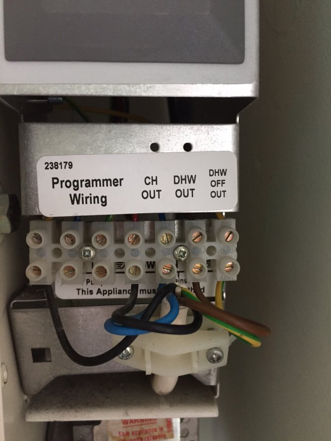

I have attached a wiring diagram for the boiler & the wires that connect to the Boiler

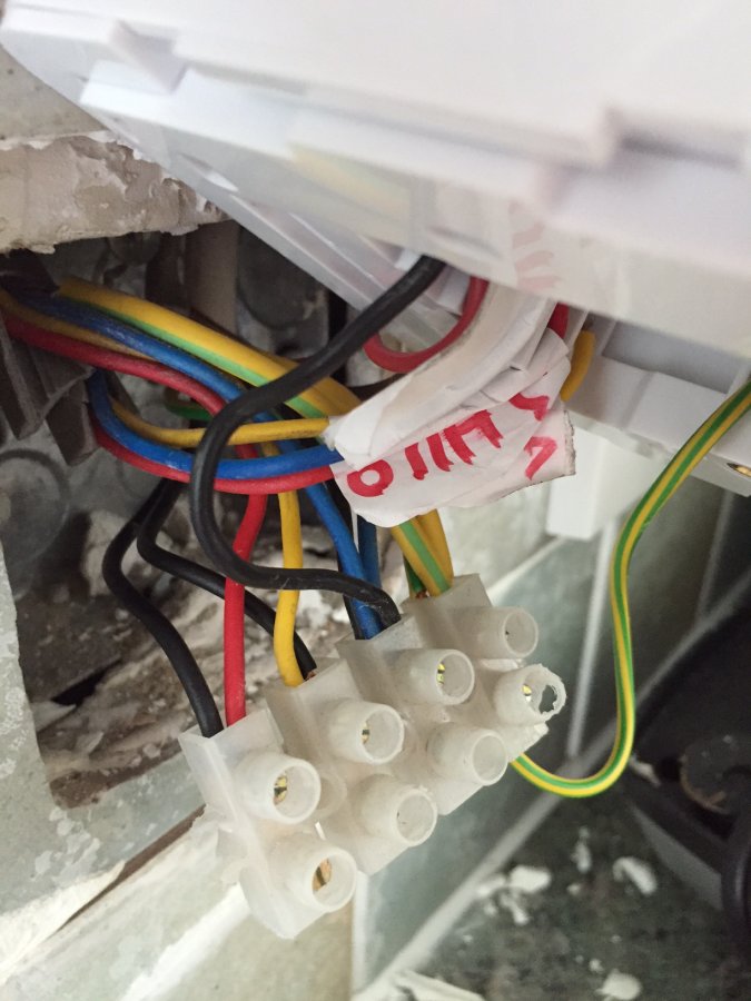

This unfortunatly is the mess behind the old timer with nothing Labeled. 4 off the wires connect to the old Thermostat that is in the hall. Blue/Red/Yellow & and an Earth
There appears to be two black wires that go from the plastic termination block to the Boiler . they Feed Pump Live & Mains Switched. These go into the first 2 connections on the above Photo and also have the yellow and red Wires connecting to them.

The Hive receive replaces the existing programmer, wiring is the same as the old, Pin 2 Ch Off is not required and not connected just as it was before.
The only other thing is to remove the old thermostat and connect L and SL together permanently (most likely Red and Yellow but this must be confirmed before connecting anything).
Nothing else needs to be changed.

I found out the wires that connected the old stat and traced them back a panel in the cupboard where the tank is housed. I then found more cables.
I then followed this diagram
and connected pin 4 on the hive to the White cable powering the valve. Tried the Central Heating and it works.
