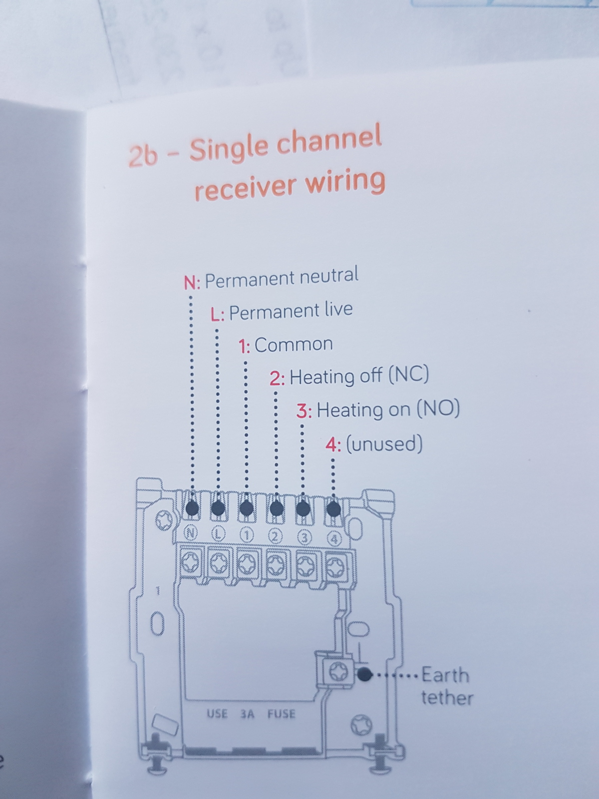

I am wanting to connect Hive heating to a Alpha CD25C that has the extra clock and a wired thermostat fitted.
Here is the boiler wiring diagram:
And the Hive install diagram:
Am I correct in thinking I wire it like this:
HIve----------------Boiler
Live ---------------- Live
Neutral-------------Neutral
1 Common----------Term 2
3 Heating On-------Term 1
Earth to Earth
I remove the current time clock and themostat and dont replace the link, just wire it up as above?
