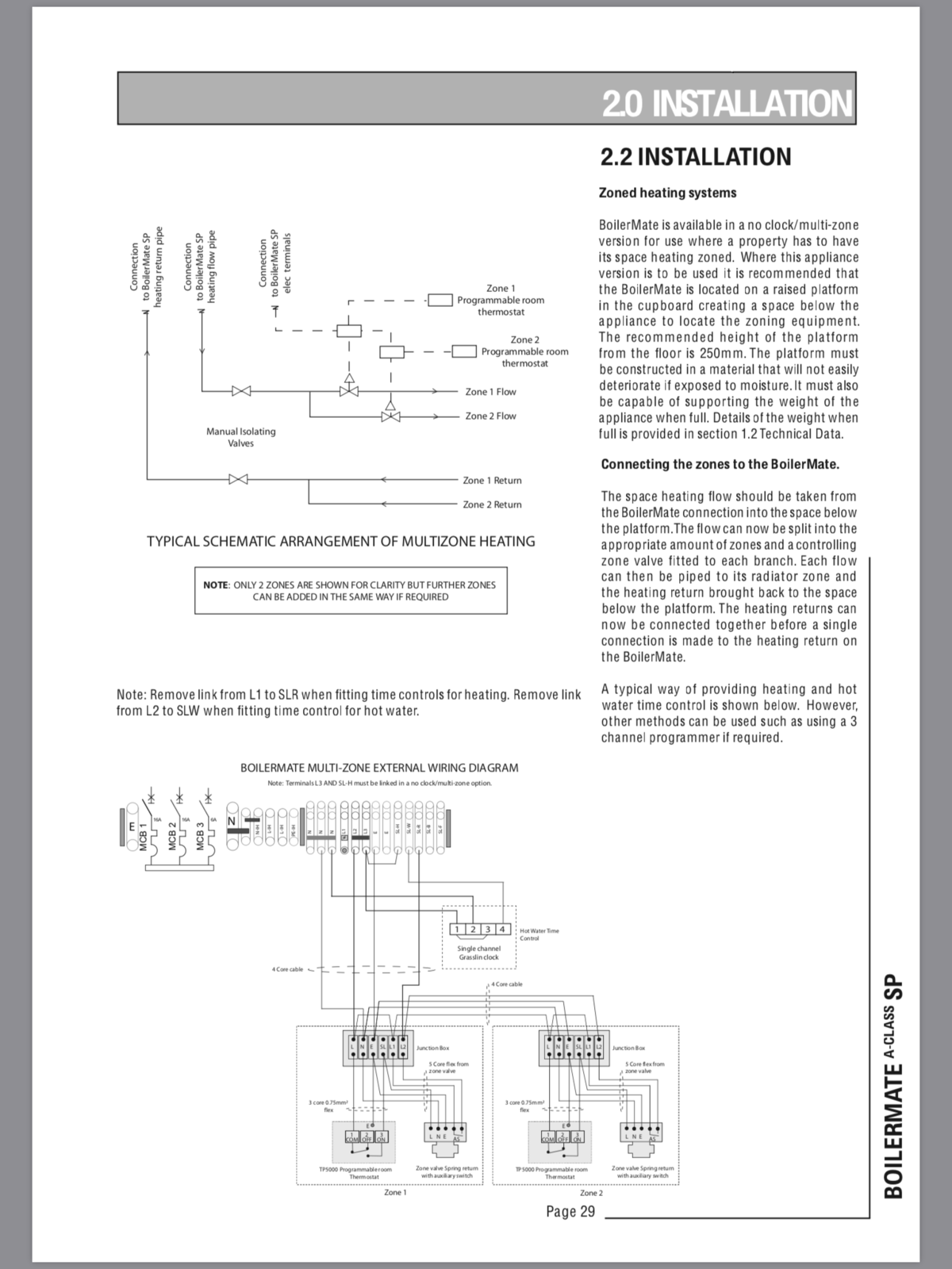

The Boilermate instructions show a typical installation using the TP5000 units
It however describes the connections as 1, 2 & 3 vs A,B & C
1) which I assume is A is connected to Live
3) which I assume is C is connected to Switched Live

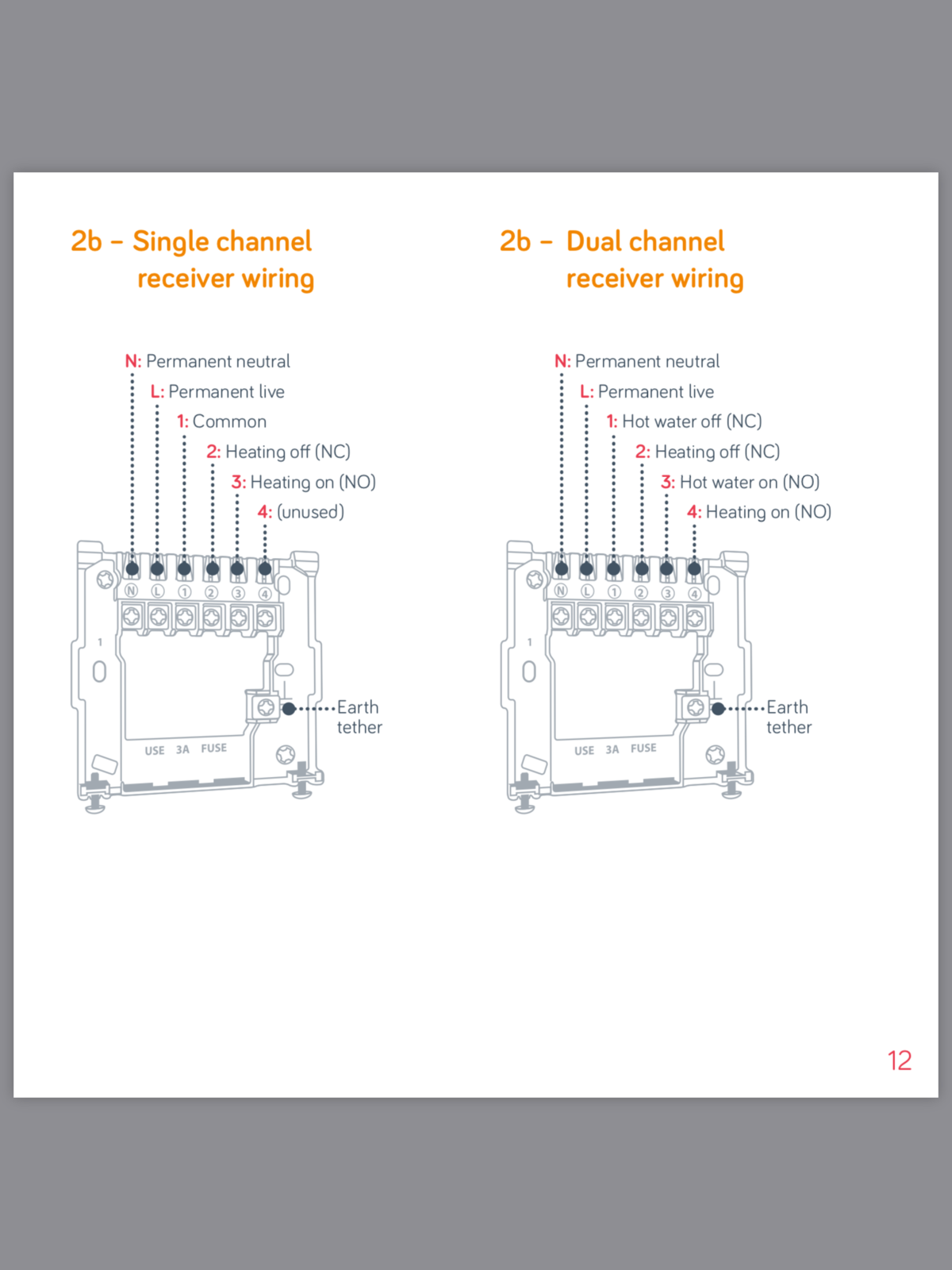

Hive has a Live & Neutral Connection as well as
1 Common
2 Heating Off N/C
3 Heating On N/O (see thumbnail image)
My understanding is that the Live & Neutral are used to power the Hive receiver.
So by connecting my Brown wire to Hive 1 and my Black wire to 2 Heating Off the system should work ?

You can swap the TP5000 for a Hive Single Channel. From an electrical point of view they provide identical control functions. Both are a simple 'on' and 'off' switch. The only difference is that whilst the TP5000 is battery powered, because Hive has WiFi built in, it requires more power than would be practical with a battery, so it has a 230V mains supply.
The brown wire at the TP5000 is the Live and would connect to the Hive Single Channel Version (L)
The black wire at the TP5000 is the Switched Live and would connect to the Hive Single Channel Version (3) 'Heating on'

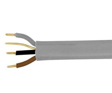

The Hive will also need a neutral supply connecting to (N) This should come via the same 3A fused spur that supplies the rest of the heating system and not from a separate source. You may find that there is an unused grey wire in the existing cable that you could connect to provide this.
Finally a link between the Hive (L) and (1) 'Common' is required so that the terminals are electrically connected together.

The Gledhill diagram shows Live going from the junction box to COM(1)(aka B Com on my photo) and the S/L going from the junction box to ON(3) (aka Normally open C on my photo)

Anyway from my photo it appears that I have Brown & Black connected, but tucked away are a grey and yellow/green.
I can only assume that they ran a 3 core and earth through the walls (photo above) so hopefully I can turn the power off and look to see if the grey wire is taped off.
If not, assuming they have not chopped it off in the Boilermate cabinet, it may be hanging loose waiting to be connected to the Neutral.

Looking at the Gledhill schematic, it seems that the Grasslin clock shares a Live & Neutral with Zone 1 & also has a link between terminals 1 & 3 (not sure what this link does yet, or if this link would be required on the hive)
I can only guess that the water Switched Live would connect to terminal 3 (Hot Water On ) on the Dual Channel Hive.
I could then leave ZONE 2 as is for the moment, make sure it all works and add a single zone hive later if required.
I think for the price difference it makes sense to get the dual receiver.
Assuming that the second TP5000 Zone 2 wiring is the same as Zone 1, then I guess the wiring would be the same as you mentioned in your initial reply, albeit using the Live, Neutral and SL from the second junction box.

Hot water on (3) would be the right Hive connection to use, and I guess you could heat up the heatstore in advance of the heating coming on if you wanted the radiators to heat up quickly. However, I imagine it retains much of its heat overnight anyway.
