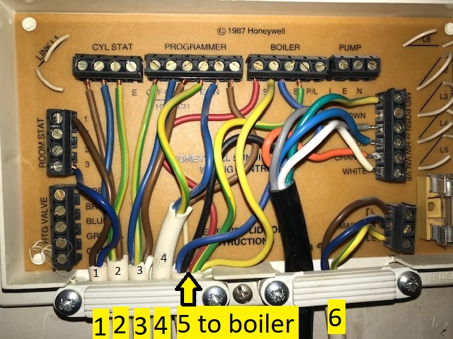

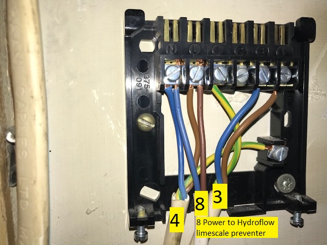

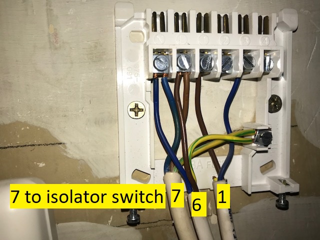

Hello friends,
I'm looking to install a Hive dual channel (for CH and HW) in place of my existing British Gas Model UP2 Programmer and WR2 Wireless Receiver. I've already looked at a number of posts on this forum, but found that the wiring in my installation is different from what I've seen, so I thought it would be better/safer to post my own thread, with photos of my specific installation, and hope that someone will be able to advise me what to move and/or disconnect. I've numbered each of the wires, to easily identify the routing to/from the Wiring Centre. Thanks, in advance, for any assistance.
Wiring Centre
Wireless Receiver
Programmer
