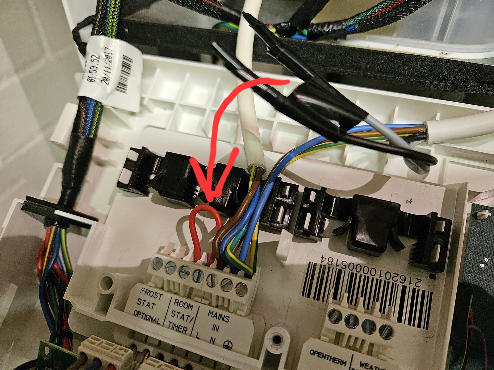

The connections you describe are correct for a Hive Single Channel Receiver, but you don't say where the black and grey wires are connected to at the other end. They should be connected to the boilers thermostat terminals marked Room Stat / Timer as below.....

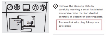

Sorry, yes, the black and grey wires are connected to the room stat terminals. I just removed the red link wire first, as directed.

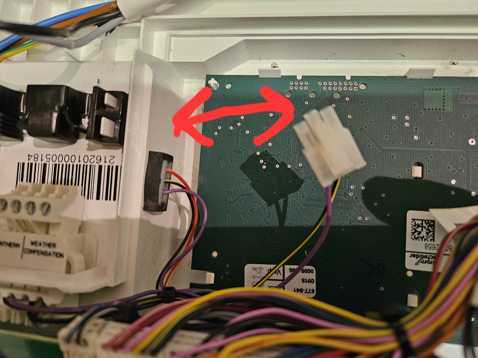

Can you show us a picture of the receiver, and the wiring loom you have disconnected it from.
Rather than simply being removed, it may need 'bridging out', i.e. some of the wires behind the receiver, would need connecting back together.
The display on the boiler, where it states the room thermostat or timer is off, can this be manually changed, or does it change with the wireless one?
Yea, as you can see in the 3 pictures. I remove the receiver box from the boiler (pic 1). Then connect both connectors (pic 2), into each other, as stated in the Ideal Vogue installation manual. Then reconnect the black and grey wires into the room stat connector (pic 3). But the Hive still won't turn the boiler on.
Just for into, I've replaced the original wiring loom, so that we have heating..
