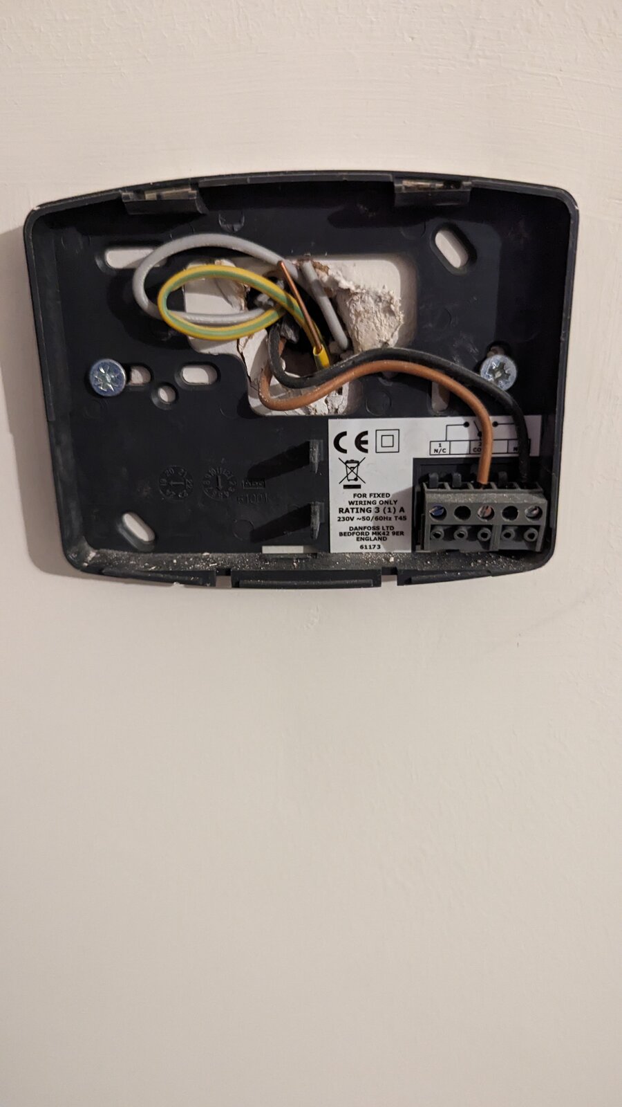

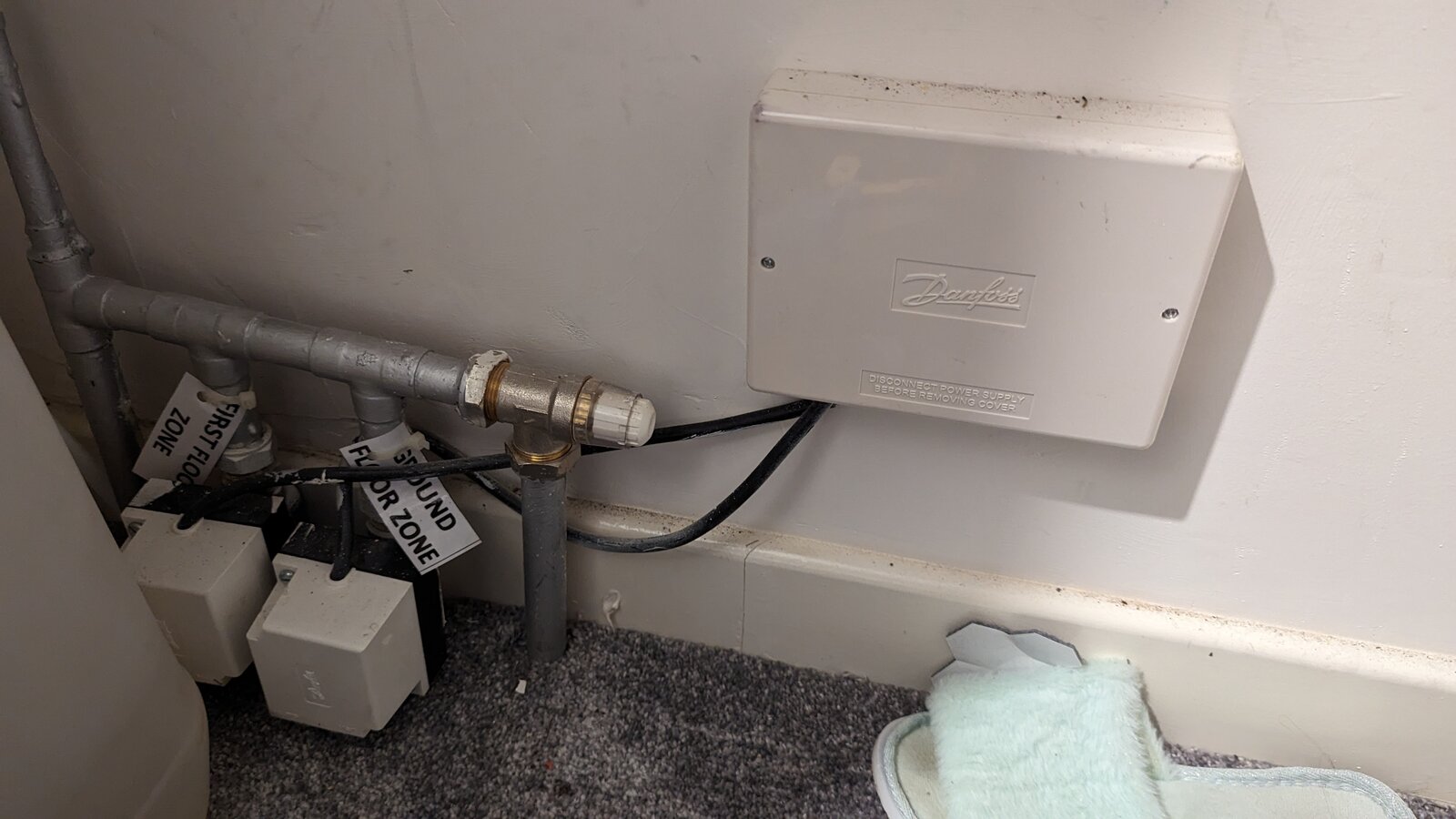

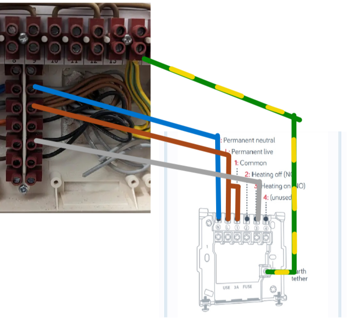

Could really do with help here I am planning on installing hive I have two single receivers and thermostat.can I wire the both into the wire box or does one need to go downstairs into the boiler

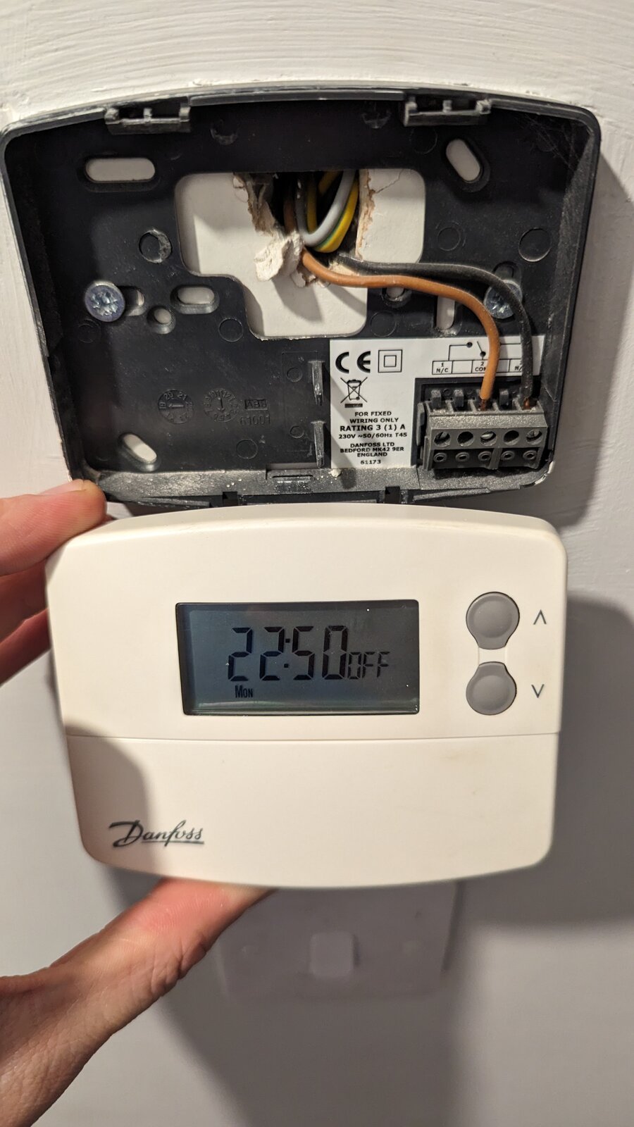

Do you want to wire the Hive receivers into the same places as your existing Danfoss (TP4000-RF?) receivers?

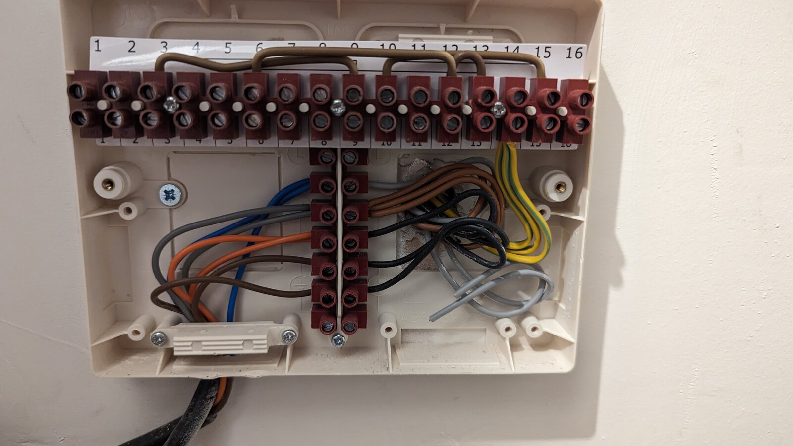

Or do you wish to connect them to your wiring centre, beside the zone valves?
you connect the receivers to the wiring centre, the Hives control the motorised valves and the valves control the boiler
That's the inside

That's the inside

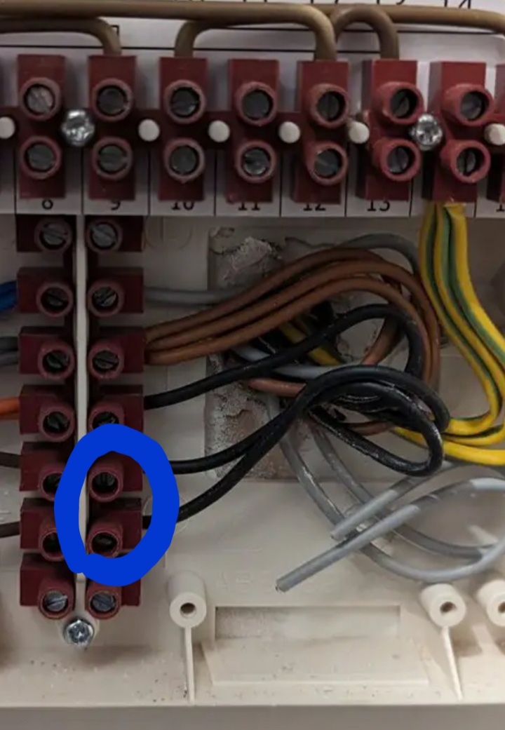

So, these two black wires...
..come from the terminal 3's (N/O) of your Danfoss receivers.
To decommission the Danfoss, these will need to be detached from the wiring centre, together with the other wires associated with those cables.

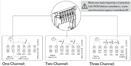

As above, there are alternatives to the Hive, but assuming you will get two single channel Hives, here would be the wiring to one of them...
You can use 3 core and earth flex to connect them up.
Just repeat the above for the other zone.

So will both receivers both be wired to the same side ?
Sorry, I don't understand your question.
The only difference in the wiring between the two receivers, the second receivers 'grey' wire would connect to where the other black wire was, as highlighted earlier....
