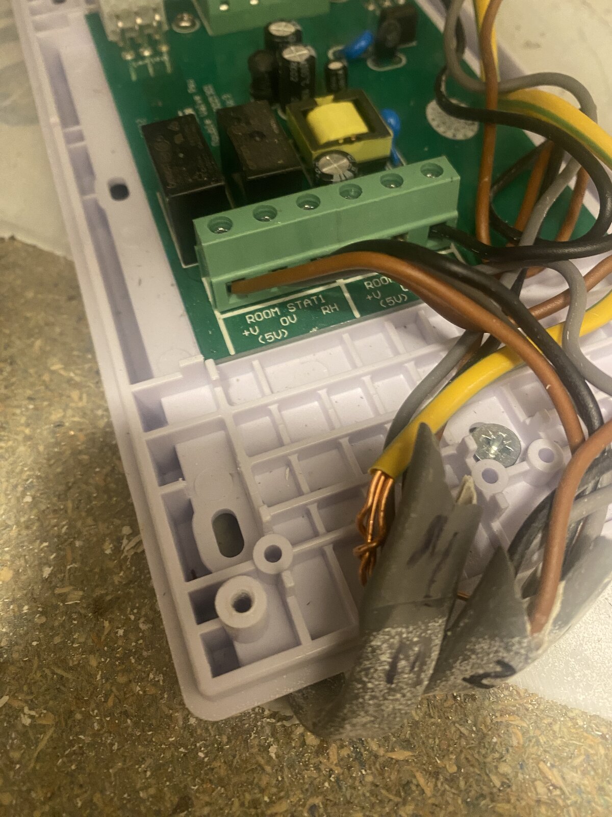

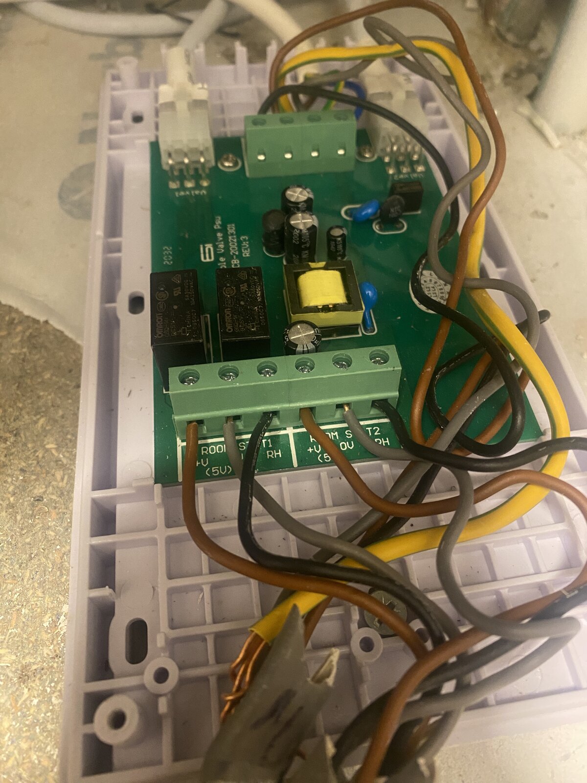

I added pics to give more of an idea where the current thermostats are wired into.
There's a lot of information here, from when we reverse engineered one of these wiring centres...
The existing ESI stats are (extra) low voltage. Please ensure that any wires from the thermostat connector side of the board, don't come near to the mains voltage wiring.
The ESI calls to heat when the RH terminal connects to 0V. It is held off, when RH is connected to 5V.
So with a single Channel Hive...
DO NOT put any link wires between L and any another terminal.
RH (black wire) would connect to Hive terminal 1 (Common)
0V (Grey wire) would connect to Hive terminal 3 (NO)
+5V (Brown wire) would connect to Hive terminal 2 (NC)

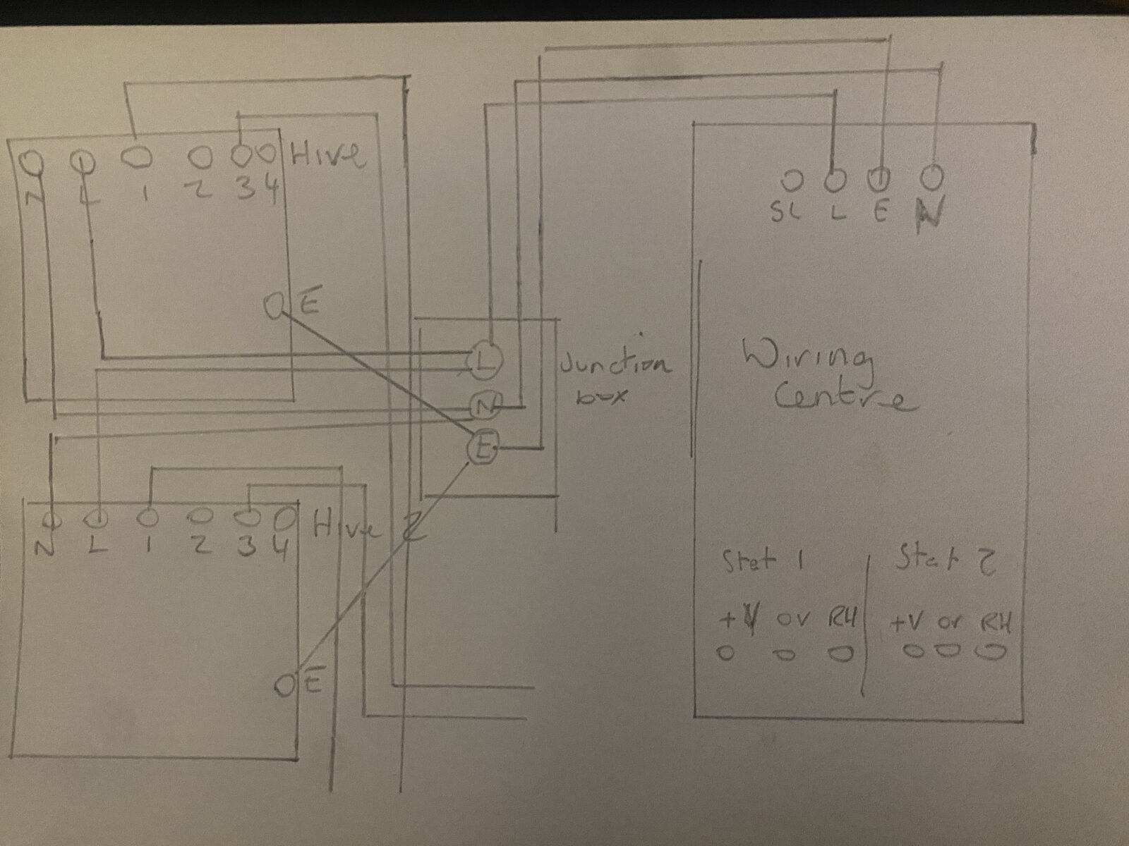

Can you post a picture of how you have attempted to connect up the Hive?
So should I run an extra core from the hive 2 port to the +V port in the wiring centre? So in total I have 6 cores running through?
Excuse the rubbish drawing
Ok, so (taking post #1 into account) you've used a 5 core cable to connect the receiver, with a grey and black connected to terminals 1 and 3 of the Hive?
If so, try connecting 0V to Hive terminal 3 and RH to Hive terminal 1 - this should work - if it doesn't, the 5V connection may be needed to stop the output floating.
Also, ensure your wiring is neat and tidy, we really don't want any stray copper wires joining the 'low' and mains voltage sides.

Spot on. Thank you so much works a treat.
