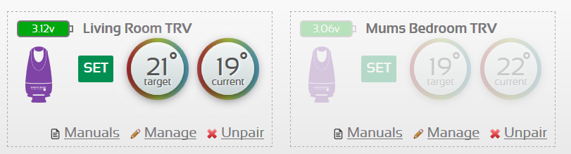

Why is Bedroom one greyed out? Is it simply as not calling for heat? Or is there something wrong?
View attachment 112577 Why is Bedroom one greyed out? Is it simply as not calling for heat? Or is there something wrong?
I think that means the backend service hasn't heard from the TRV recently. You might want to make sure it has a good connection to the hub. Try moving the hub closer to the radiator and see if that helps.
If not, you can try deleting it and repairing it through the web interface.
It seems to be working now, and at last got it on phone as well. But early days, there is one large difference between the standard TRV head and the eTRV head, the standard head slowly closes as the temperature raises, the eTRV motors fully open or fully closed. So it is all or nothing. Pressing the switch on the head one hears it running as it opens or closes, and once it had been locally activated it seems to work.

Unlike the programmable thermostat, the eTRV has two way coms, it both receives and transmits, since one can push the local button to give one hour at 21°C then there must be some local temperature control, without needing to contact the hub. At the moment the web page says "Last seen about 5 hours ago" I assume until there is a programmed change the transmit function will remain dormant, this will extend battery life. It is set at 8 am to increase temperature, I would expect at 8:01 to read "Last seen about 1 minute ago"?

You will note "Last Seen: about 2 hours ago" and it does not say which device was seen 2 hours ago, it seems the times are stored, as when there is a programmed change, then the devices are no longer greyed out. The main thermostat has not asked the heating to run, so even if the TRV was to call for heat, the room would not heat up. The Bedroom clearly had a problem and would not turn off, that has now been cured, not really sure if down to wrong spacer or wrong set-up. This morning I realised there was a fault with living room as well, radiator was warm and target was lower than current. So battery removed and refitted, and tried to initialise the unit again. However still not been running long enough to know if now working as it should or not.
I am not impressed on the fitting instructions, there were non with the TRV's had to down load off the internet. There is a procedure to ensure pin fully retracted before fitting, and for it to open and shut the valve to calibrate it's self. It says press this on PC then that on valve and one is upstairs and other down stairs so I think the gap between pressing button on computer and valve was too long?
Ups found out why greyed out, wife has unplugged the hub, can't really blame system when wife has unplugged it! So now have to wait to see if it turns on/off as it should, fingers crossed, now it's switched on it should work.
