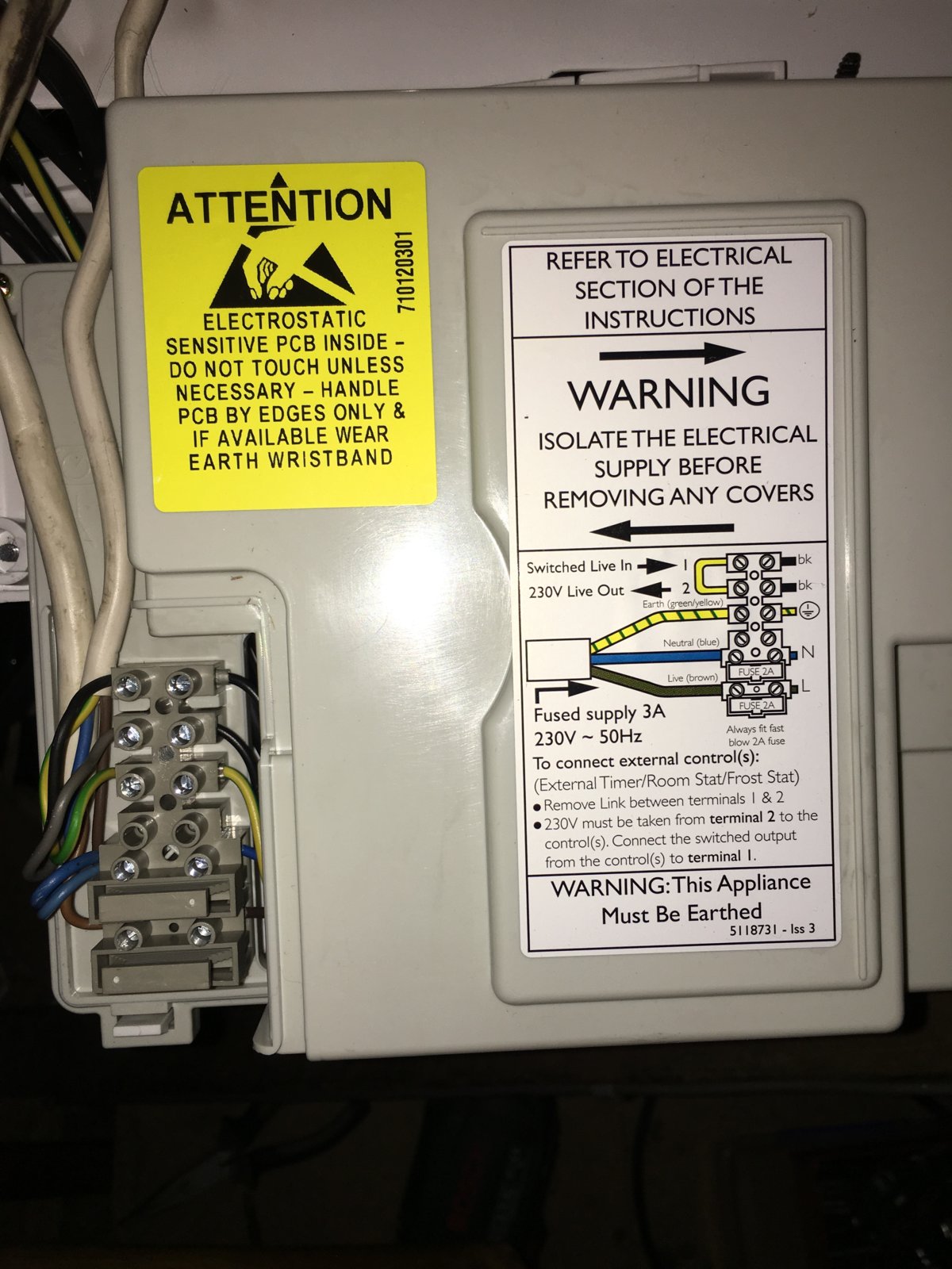

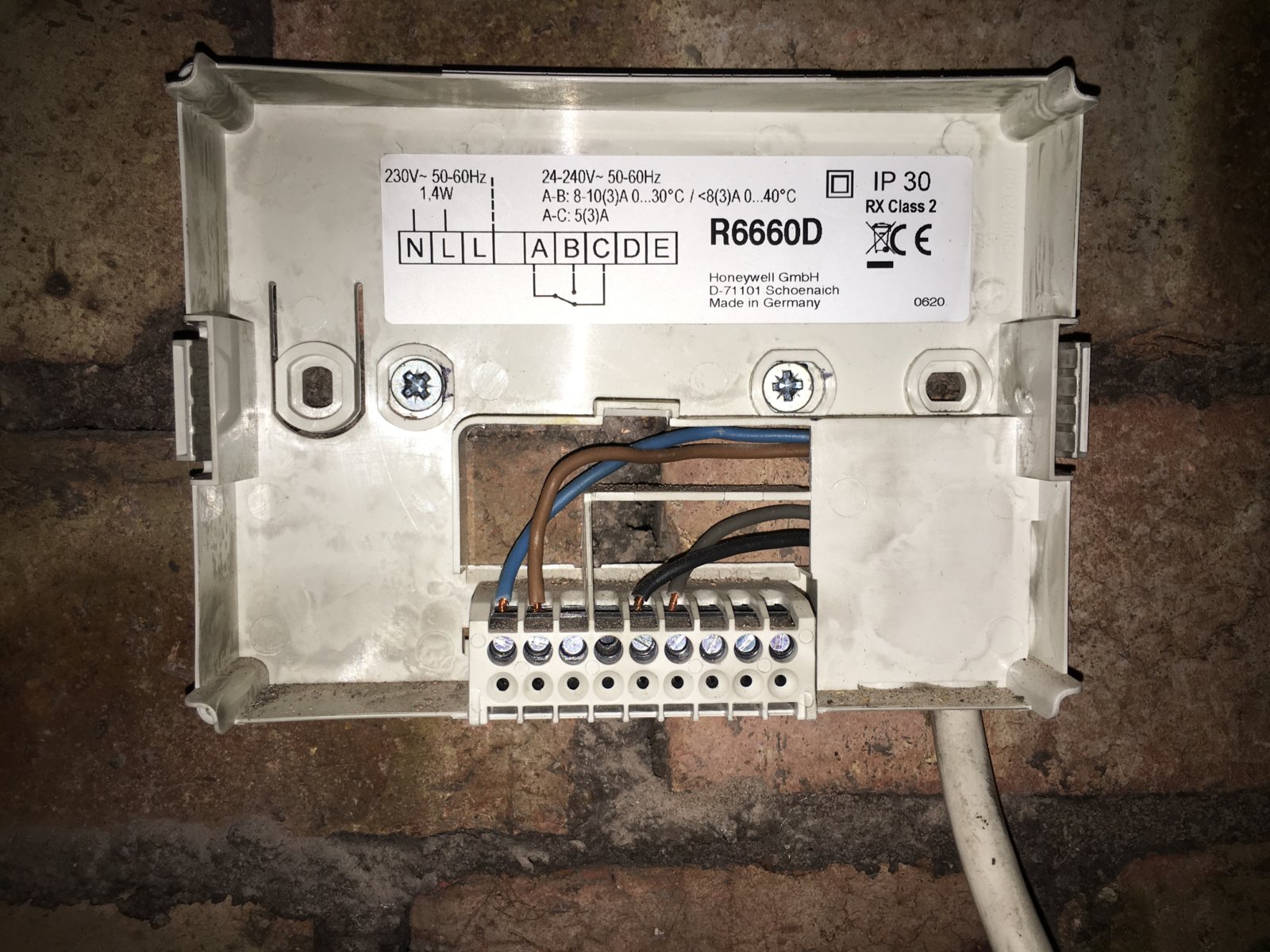

I have a hive heating only thermostat that I was going to install. Currently I have a honeywell thermostat attached to the Baxi combi boiler. I have checked the wiring to the boiler and think I know how the hive should be wired but wouldn't mind a bit of clarification from any experts please.
Pictures include wiring to honeywell thermostat, boiler wiring and my proposed wiring to hive.
I'm concerned as I have seen on various other forums and posts the reverse wiring of live out and switched live
note; I have a grey wire for Live out and black wire for switched live
