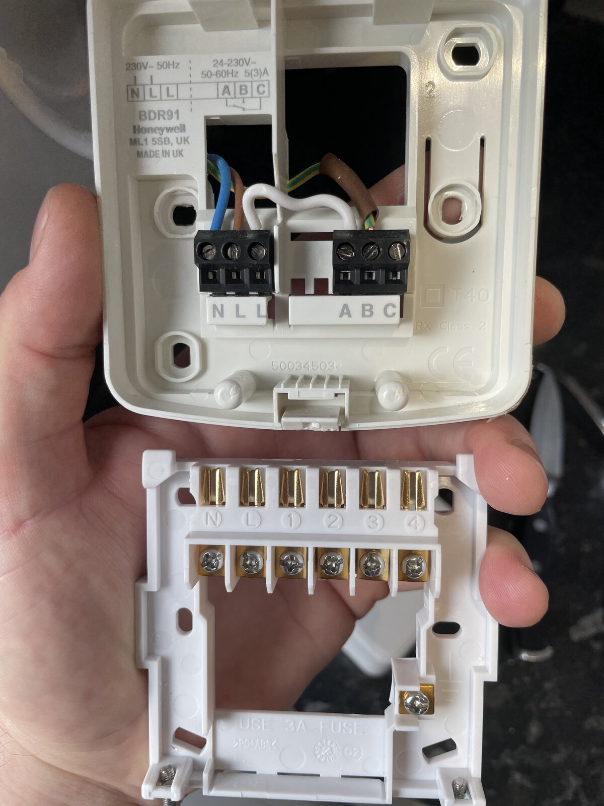

Morning all, newbie here. I have a Worcester Greenstar 30i combi boiler with wireless thermostat and I’m changing it for the hive active heating. I’m trying to figure out how to wire up the new receiver - can someone please advise? The old receiver has N L L A B C which doesn’t correspond to the new Hive unit. Photo attached I think!! Thanks in advance!

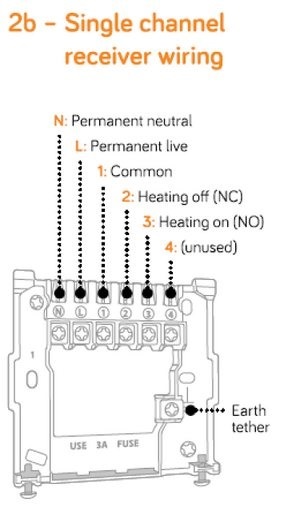

Assuming that you have the single channel version of the Hive as below: [The terminals of the dual channel version of the receiver look the same, but have different functions]
N and L are a straight forward swap over from the BDR91 to the Hive like for like.
The existing white wire link goes between Hive (L) and Hive common (1)
The green/yellow wire with the brown sleeve on goes to Hive Heating on (3)
