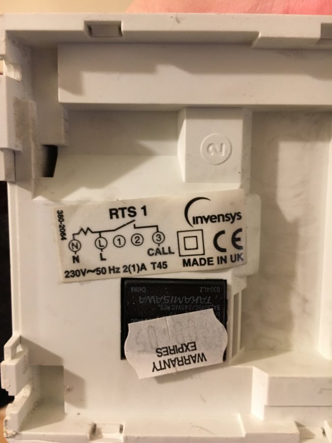

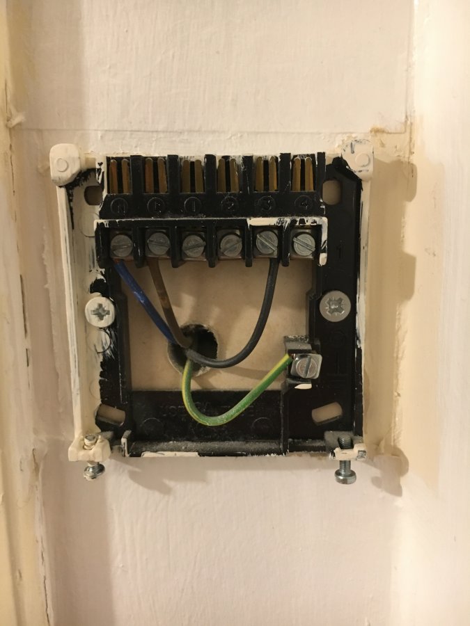

I am looking to purchase hive heating I will only be using it to control my heating I have checked my wiring of the current thermostat which I have attached, do I need to change anything or will it just be a matter of fitting the hive relay to the plate and that's it?

We need a bit more information.
What presently controls the times that the heating is on for?
Do you have stored hot water, or do you have a combi?
At present we have a timer built into the combi so I would just assume that I would set the time to always on since the hive thermostat would take over the responsibility for that?
OK thanks understood. In that case you are correct. You will need the single channel version of the Hive and all you would need to do is to add a link between the L terminal and Terminal 1.
You are welcome. You are also fortunate, adding a Hive to most systems is a bit more tricky. Yours is one of the easiest I've come across.
Hive is deliberately designed to be easily fitted to existing drayton products as they made BG branded controls for a long time.
