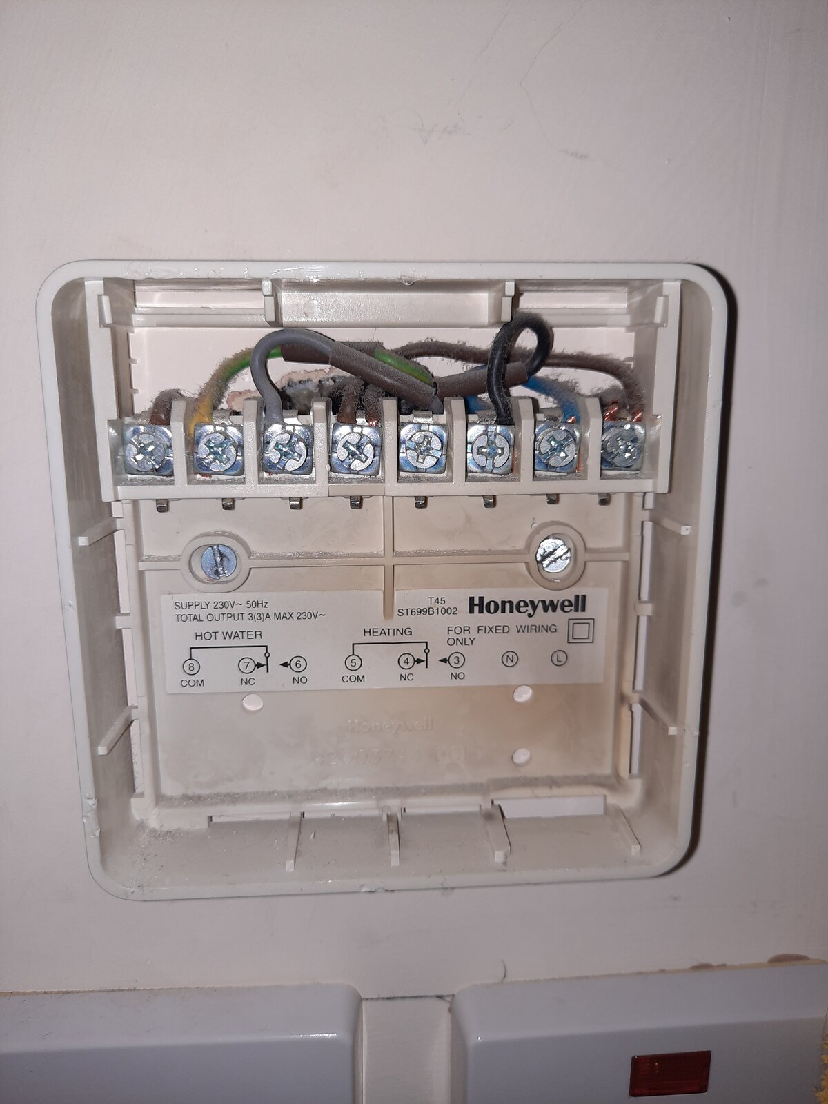

Hello all
I have a honeywell programmer and want to replace this with a hive system.
I'm fairly aware of the wiring purpose, but could do with some clarification, if possible.
The main issue is that I have multiple wires that have to go into fewer terminals in the hive.
Can anyone clarify? Here's a pic of my honeywell
Thks
On the 2 channel Hive, there are no COM(mon) terminals.
These are internally linked to the Live terminal, within the Hive.
So straight away, you can ignore a couple of link wires on the Honeywell.
See how far that gets you! :)
Thanks. That's what I thought. Does that mean I'll ignore using the com wires?
