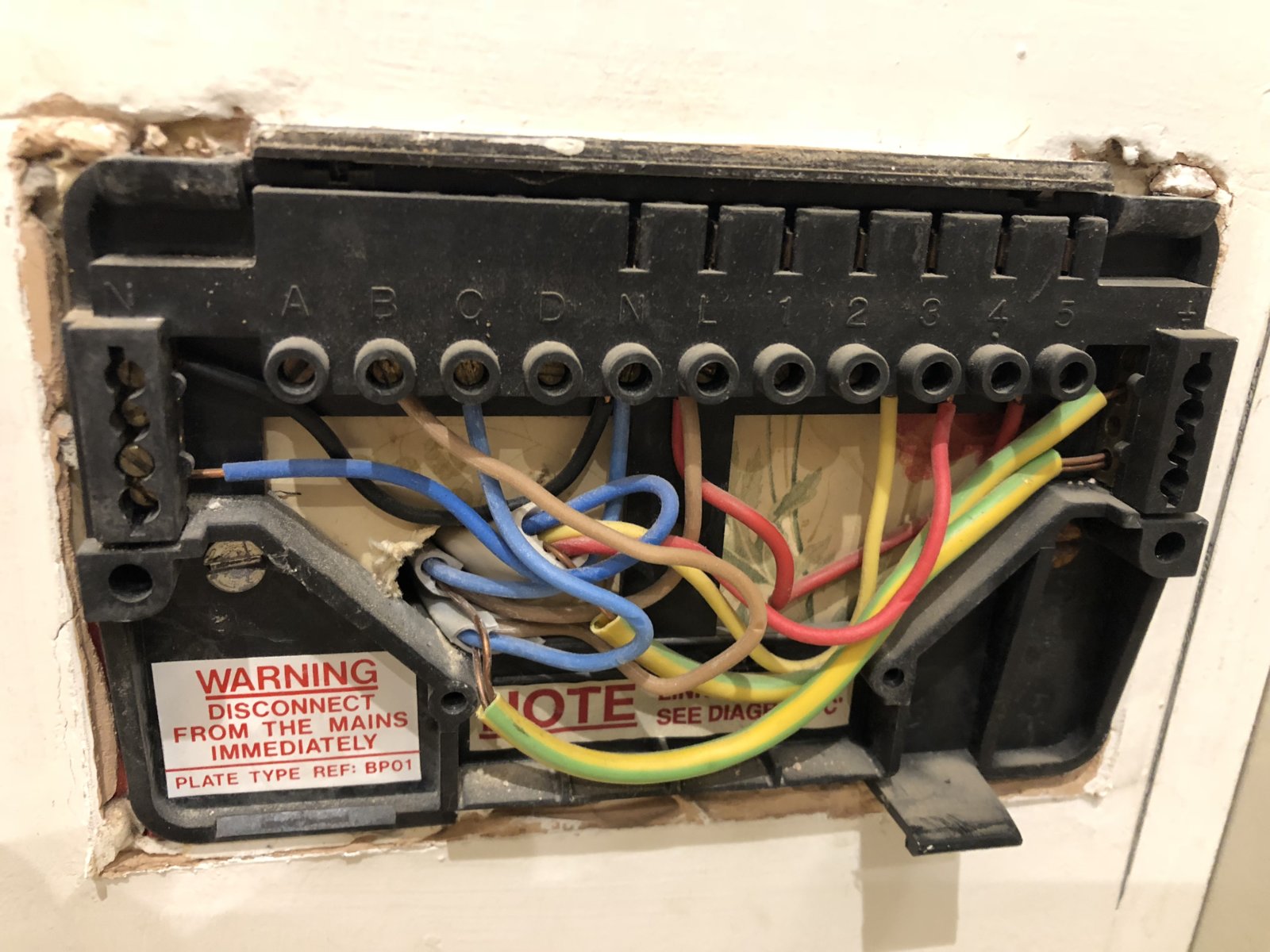

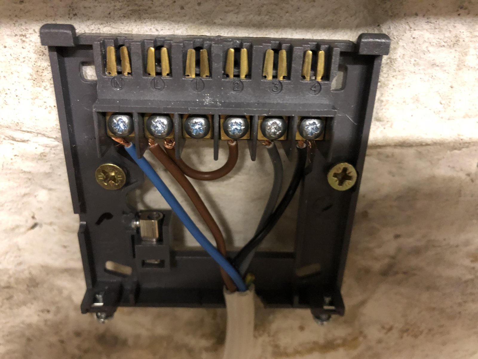

Hi
Recently moved and currently have a Potterton EP3002 programmer for hot water and central heating. Central heating works by having this constantly switched on as is ultimately controlled by a Danfoss RX1 wireless thermostat. Pictures attached. Whilst the Potterton has some redundant wires in there (terminals B and C) everything else looks like a standard s-plan configuration. My question is how do I bypass the RX1 as ultimately the Hive thermostat will now control this. Can I just add a wire in the RX1 to bypass the switch?

Have you bought a single channel or two channel Hive?
You could do what you say but it would then be a further bodge with programmer CH on permanently and thermostat redundant.
Hi
Thanks for response - it’s a 2 channel hive so will replace the programmer but the CH will effectively get overridden by the Danfoss rx1. That’s why I want to bypass the Danfoss but not sure which wires I need to connect in the Danfoss receiver in the attached diagram?
Yes, but now your programmer and thermostat are both redundant.
Your hive needs connecting to the boiler or wiring centre instead of the programmer and thermostat, not in addition to them.
It needs rewiring properly.

Are you sure? I have been looking on the hive instructions and it does seem there is no hot water thermostat, Hive it seems will time when water is heated, but I can't see any thermostat. The only thermostat seems to be the room thermostat, which as far as I can see will not connect to the eTRV heads so rather useless anyway?
OP already has the programmer CH time on permanent because he has a wireless Room thermostat which he now also wants to bypass.
As he has an S-plan system the tank stat will (presumably) remain.
I do not think it right to leave the present programmer connected with CH and DHW permanently on and room stat shorted to permanently calling when they can be disconnected.
The 5 core cable at the thermostat is not seen at the programmer, and it uses both NO and NC contacts which seems unusual. Also removing power from the base unit will cause the battery to fail premature so I would have expected the unit to be always powered, some where there must be another box, if there were only terminals 2 and 3 used then it would be just a case of finding other end of cable and linking brown to grey, but big question is why is that black wire there?
