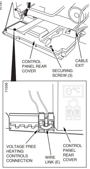

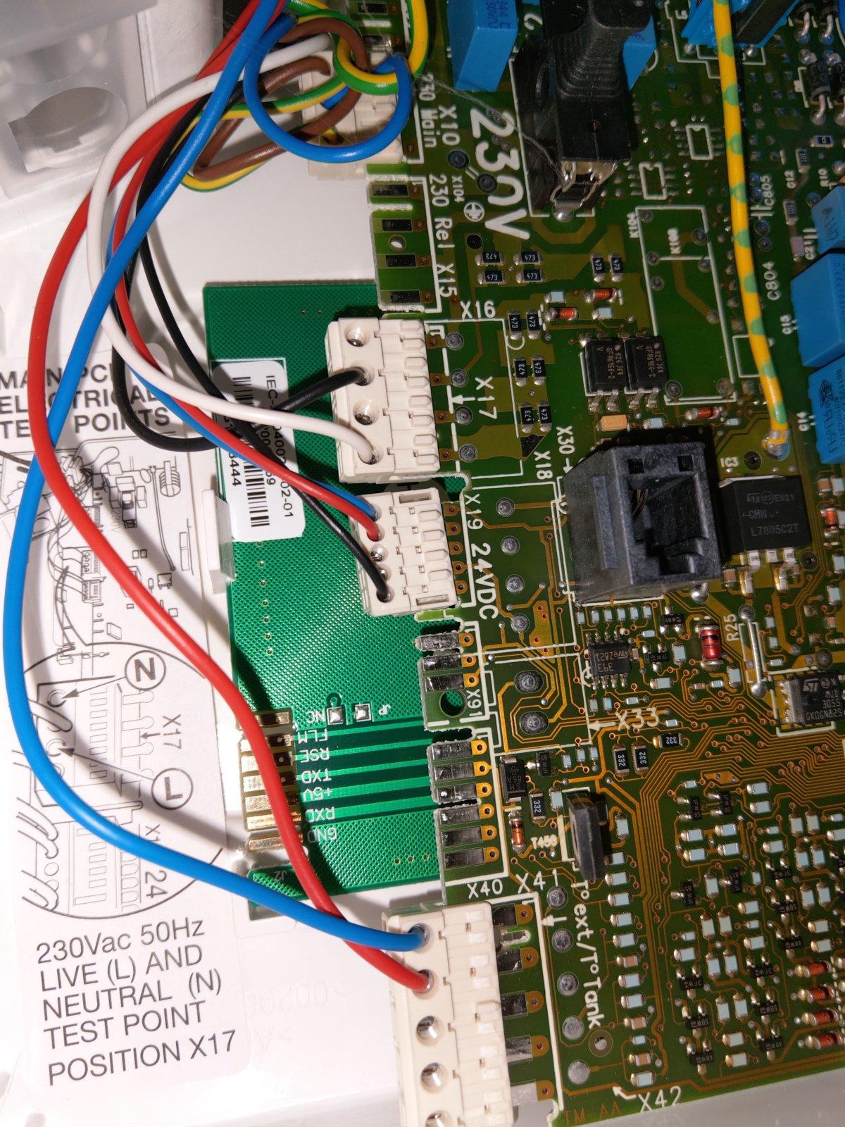

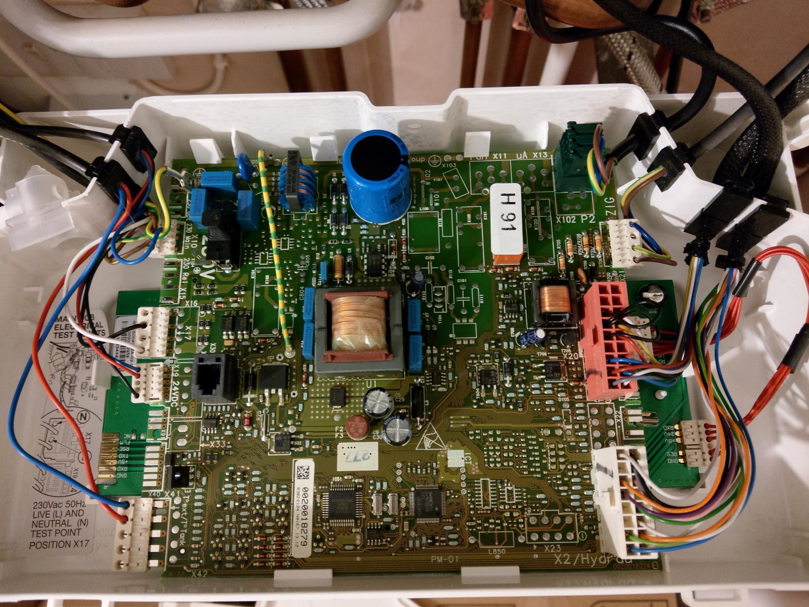

If your boiler wiring looks as below, and you as you are using the 24V thermostat connections they are labelled "voltage free heating controls connection" [ie they are not connected to 230V mains voltage]
The programmer is optional so may not be present. If it is there, it will need to be set to be permanently 'on' 24/7 after the Hive is installed.
The Hive N & L connects to the boilers N & L permanent mains supply.
The Hive Single Channel version (1) 'Common' and (3) 'Heating On' connect to the two terminals marked "voltage free heating controls connection" in the place of the existing thermostat. (the link will have been removed when the original thermostat was installed) It doesn't matter which way around they go.
You may read other threads that mention adding links to the Hive, you shouldn't do this as you will put 230V on to the 24V circuits and the results will not be good!
If the existing thermostat is wired to the 230V control circuit and not 24V then things will be different.

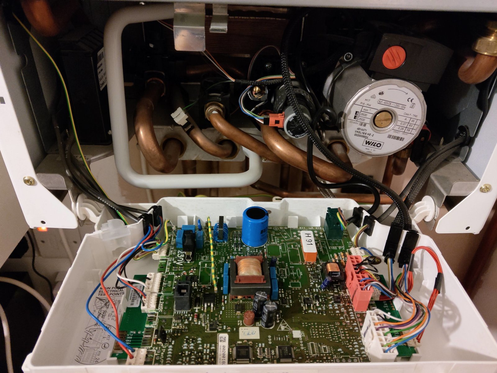

Thanks Stem I think that all makes sense on the thermo connection points (although I don't seem to have the same wiring config as the illustration - I can see a 24v point marked as x19 but that h=has three wires currently

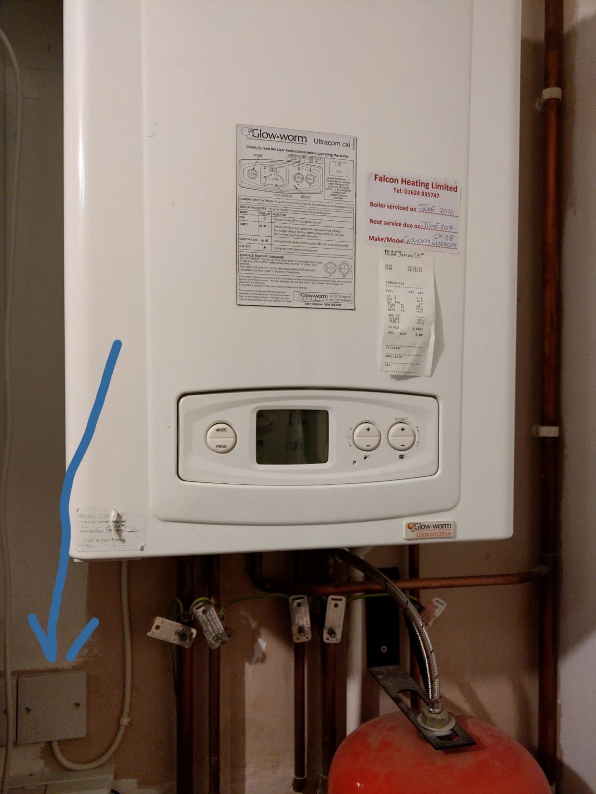

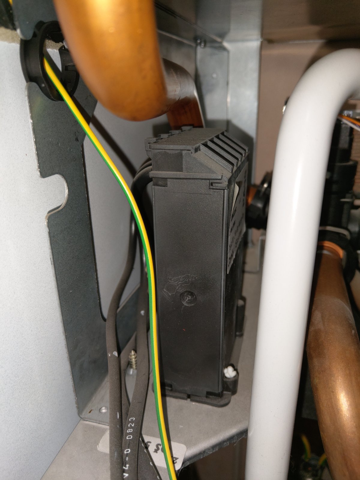

Re:the N&L same supply as boiler though - is there another wiring connection to piggy onto the boilers mains supply (ie presented as a block like the heating control connector or something deeper required e.g. to however the boiler is physically powered currently closest wall point?) I.e. behind the arrowed plate (sorry for bad wording and thanks!)

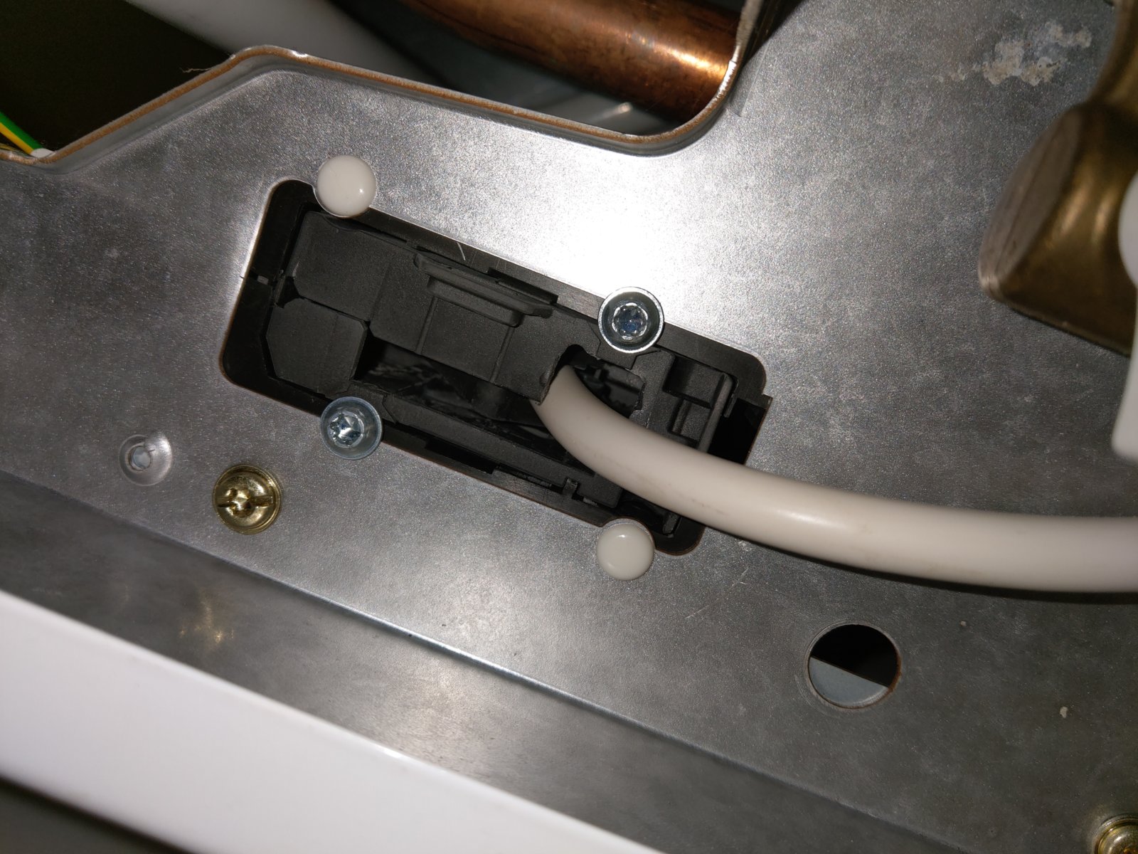

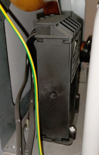

Yours is a different version to the one I posted. The photos show the circuit board and the internal wiring, but not the wiring coming in from outside of the boiler. Where does the white cable from the blanking plate and the existing thermostat wire go?

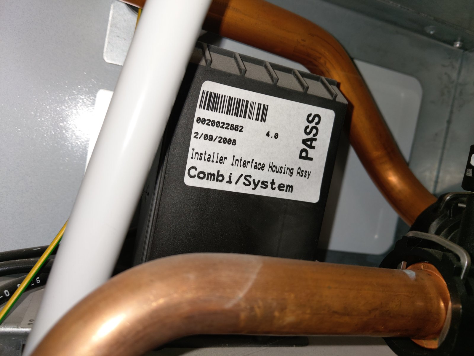

Good point... Appears to go to this black box! And then out again the wires on the left of the pcb. To Ext seems like it might be the one but I've never seen these wire terminators/couplers before. Also not overly apparent if I can get in the black box, has screws underneath but also those white plastic rivet style bits in the pic... Typical that this isn't in the manual lol!

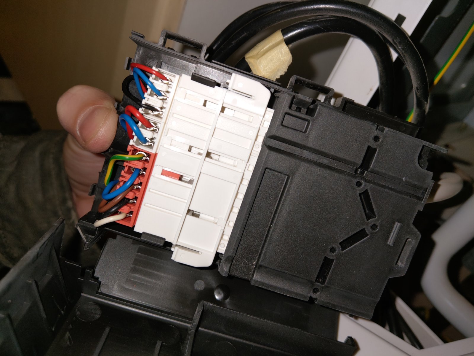

Thanks very helpful I have only seen one of these types of boiler once before. The cables enter here as you have worked out.
It opens up and the external wiring is terminated inside...

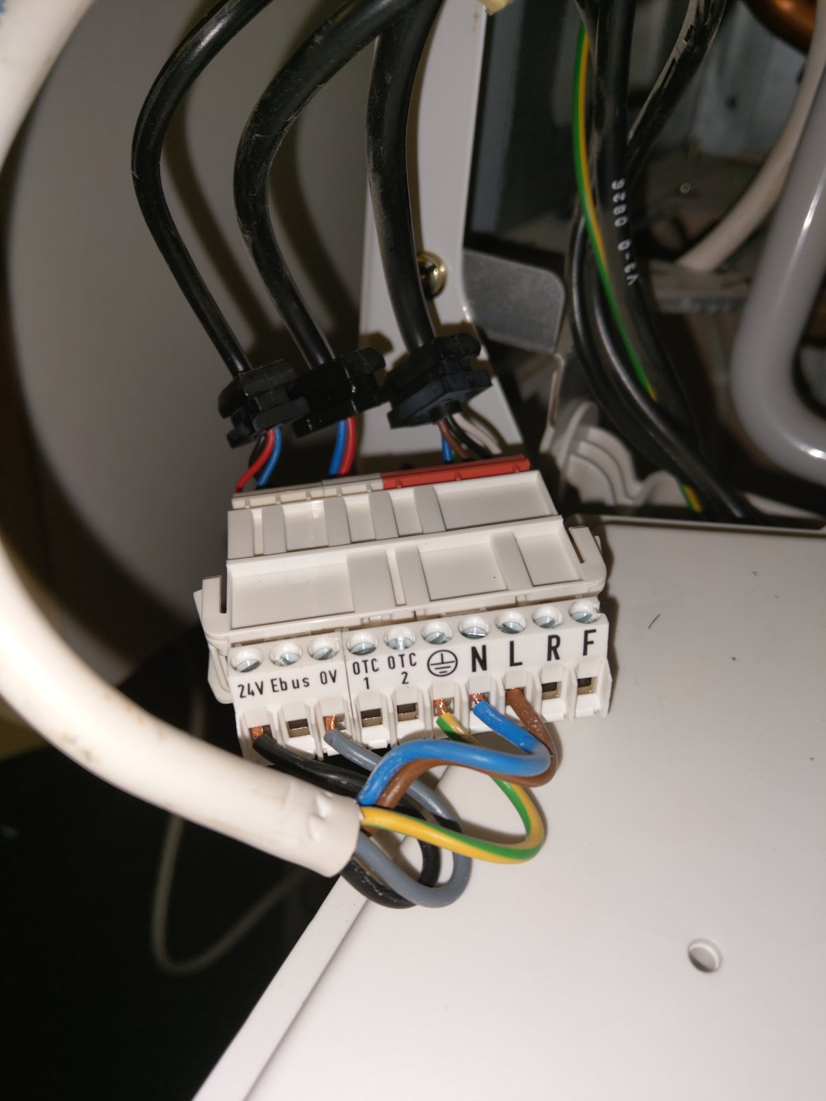

....and connected so.

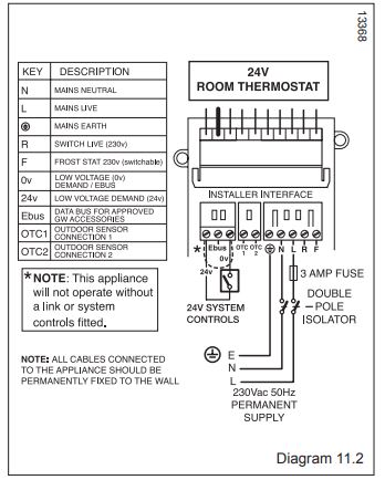

The voltage free contacts are 0v and 24v if you do have your room thermostat wired to 24v they should be the terminals it is presently connected to (Ignore the Ebus in the centre)

Thanks stem that's super helpful! Doesn't look like much room around it to access it to open it up mind... May have to try the screws at the bottom and see if can prise the plastic rivets off!?
Hi stem, this is what it looks like inside the box, not labelled unfortunately, at you saying ignore the bus as in it isn't used or ignore as in leave it in place (as there is a wire in it currently!)
That is the boilers internal wiring, there will be a wire in the Ebus connection on that side in case someone wants to connect to it for its intended purpose!

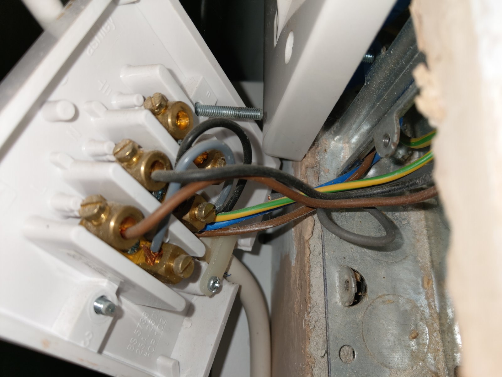

The terminals we are interested in are those that connect to the outside world, the external wiring. ie the mains supply and the thermostat
They look like this. Note the cables at the bottom under the strain relief, that come from the mains supply and room thermostat:
That was the key, thanks so much stem for sticking with me! Pushed the plastic rivets off and screws undone then did the Russian dolls three layers to get at the wires. Cut a kettle lead in half and ran the LN and E as it was there in one run, and then the other half to replace the thermostat. Had to cut various chunks of the plate to let the cables fit so I could close the hive receiver but managed to put everything back together again (one screw left over... typical) with glowworms stupidly complicated interface box instead of just the external connection the instruction manual implied lol... But it is now connected up and I have full remote control of my heating!
