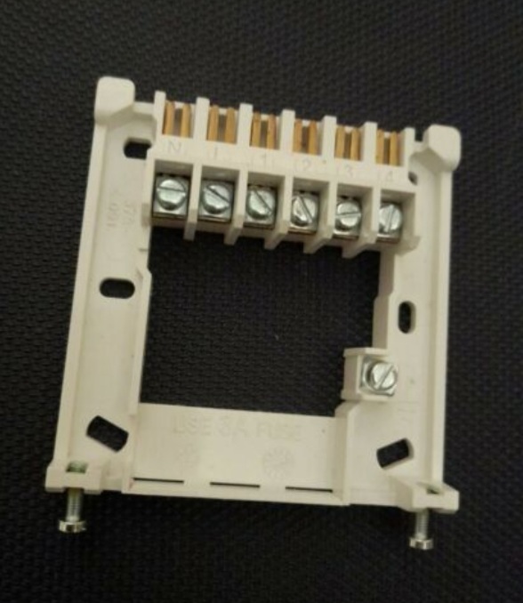

Hi,
Can someone give me some guidance please. I'm replacing a faulty danfoss central heating thermostat/timer with a single channel hive on a combi boiler. The danfoss was a battery powered unit so only had two control wires going in to it, one into a terminal marked 3N/O and the other into 1 COM. I've replace the cable with some four core to supply the hive receiver with live and neutral it requires and just taken these both from the junction box after the switched fused spur that supplies the boiler. For the two control wires I've gone into the common terminal on the hive with one and the heating on (NO) with the other. Both of these wires coming from the boiler are black, so I've no idea which is which.
Problem is the receiver unit isn't lighting up as though it isn't getting power. I've tried switching the two control wires around to see if it was because these were wrong but it doesn't make any difference.

The earth is there to protect the cable, and maintain continuity. If your hive isn’t lighting up for power then it’s not the switching (control) wires doing this. Check your L and N connections.
Yep, schoolboy error, I had my blacks and browns mixed up, I blame bad light and old eyes
Just to clarify on the earth, based on the two replies, you are both saying to connect this regardless? The hive installation info states that the receiver is double insulated and doesn't need an earth. There is an earth terminal on the hive back plate, but it suggests that this can be used if required, i. e., just somewhere to park the earth wire if needed.

However, even though the Hive receiver is double insulated, I don't think you could say the same for its baseplate!
"Best practice" may be to earth this one :)
