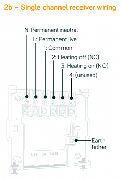

I think that the existing thermostat will have 3 terminals marked A, B & C, and there will only be wires connected to terminals A & B
But please check this carefully before proceeding!
If this is correct they are the switching wires and would connect to Hive terminals as follows:
The wire in A=Hive (1) Common
The wire in B=Hive (3) Heating on
The CM67 I know (again please check to make sure that this is the version you have) is battery powered, the Hive needs a 230V supply to power it, so this will need to be applied to the N & L terminals. It should come from the 'load' side of the same fused spur that supplies the main 230V supply to the boiler.
As you ask about replacing just a room thermostat, and don't mention hot water, I assume that your boiler is a combi version and that you don't have any stored hot water (ie a Hot water cylinder) If you do, then the dual channel version of the Hive is required and it replaces the existing programmer and not the thermostat.

You would need to provide a permanent live and permanent neutral, which could be done at the wiring center, which a and b should go back to anyway.

you can use a hive the receiver goes next to the corrosponding zone valve, but will involve wiring alterations

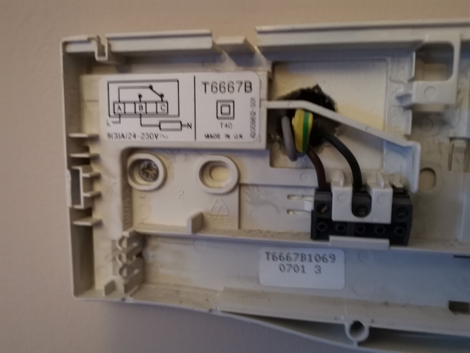

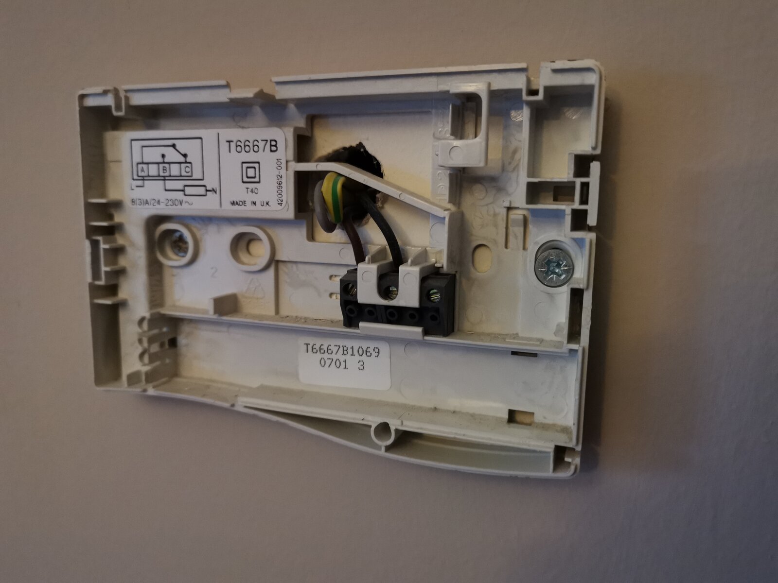

Do you know if the 2 wires that feed the current cm67 go to valve which in turn goes to boiler? I took the cm67 off and there is a 3rd wire and an earth looped back into the hole in wall. I'm presuming it's a 3 core and earth and they've just used the 2 cores. Or maybe the 3rd core is connected the other end for the option to fit a 3 wire programmer/thermostat?
Just not sure where to look for the other end of this cable.

They are simply switching wires, the Hive thermostat, doesnt need wires it is battery powered, it is the receiver unit that is wired to and controls the zone valve,
