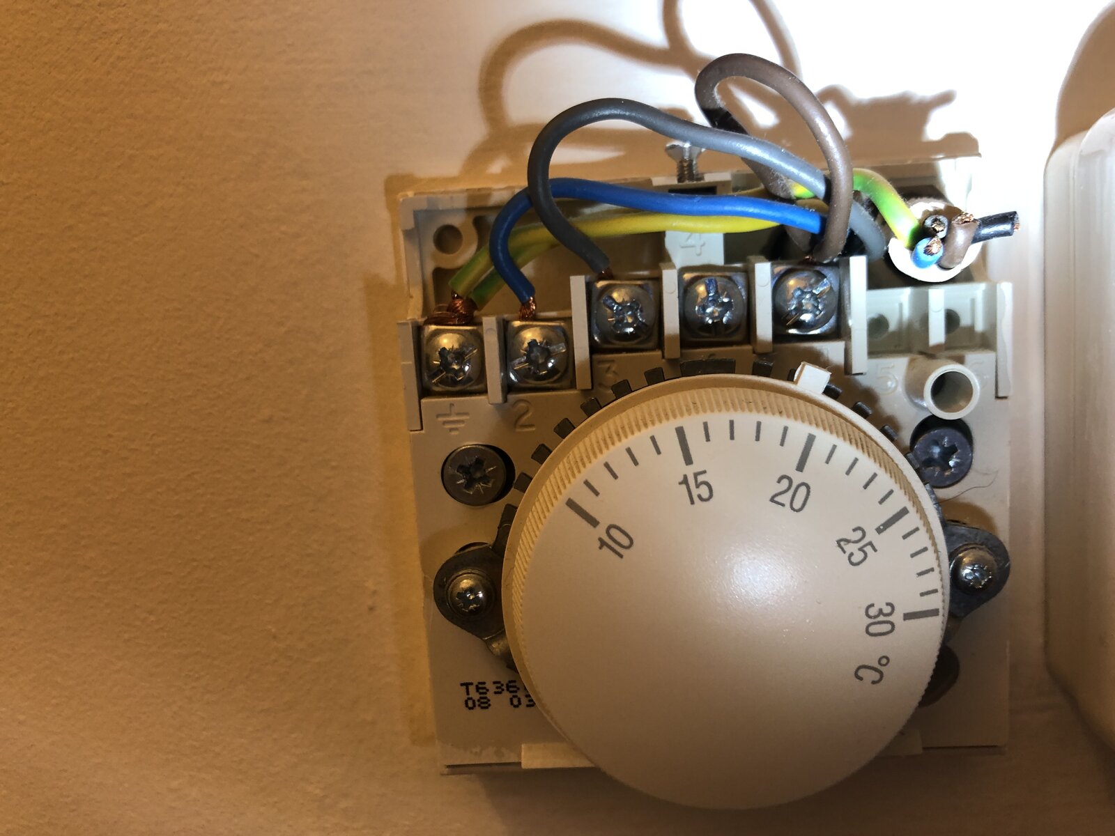

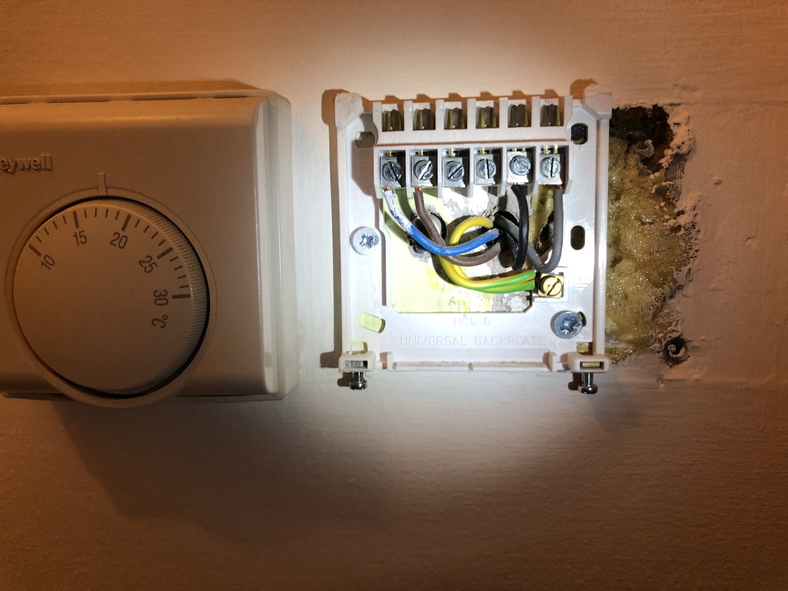

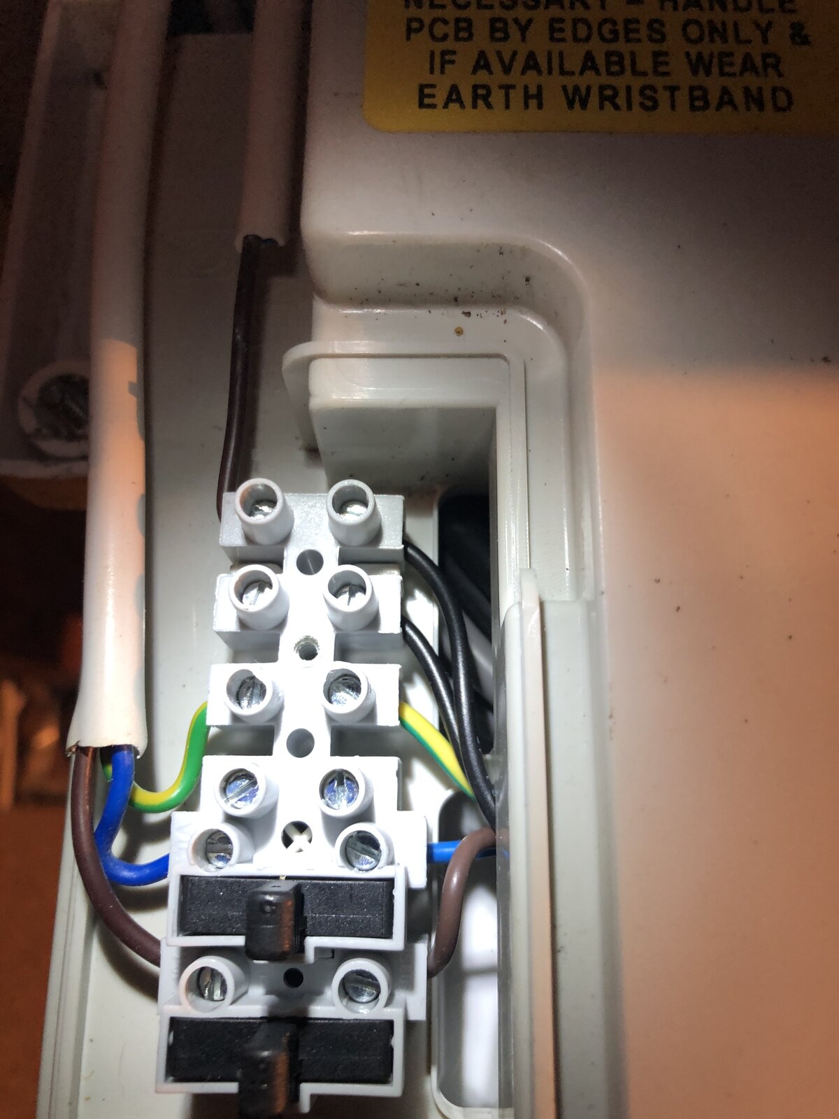

Hi I am new to the forum, so bear with me if I don't get things quite right.
I have the above boiler, that's attached to a Centaurplus C21 programmer and a Honeywell temperature gauge. I wish to take these out of the heating system and replace them with the Hive. I am no electrical expert, but could somebody tell me which cables from the boiler I connect to the hive receiver and into which connections

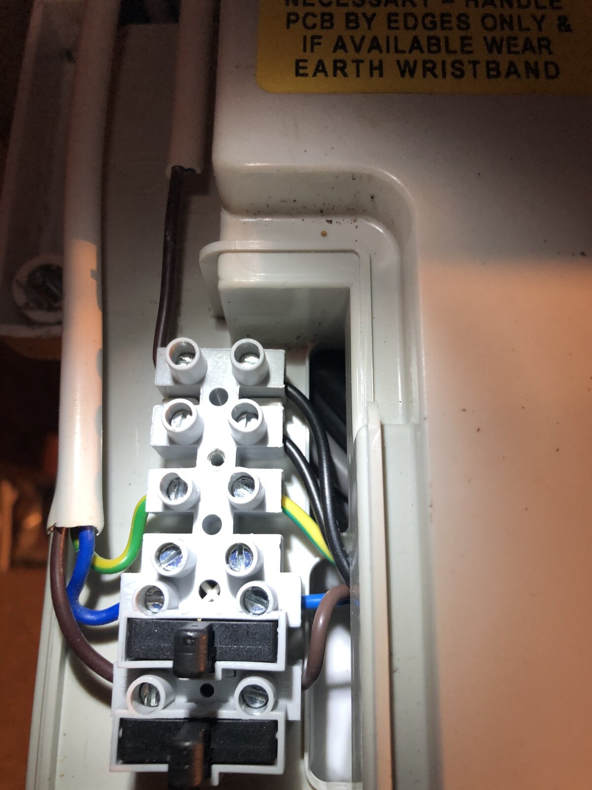

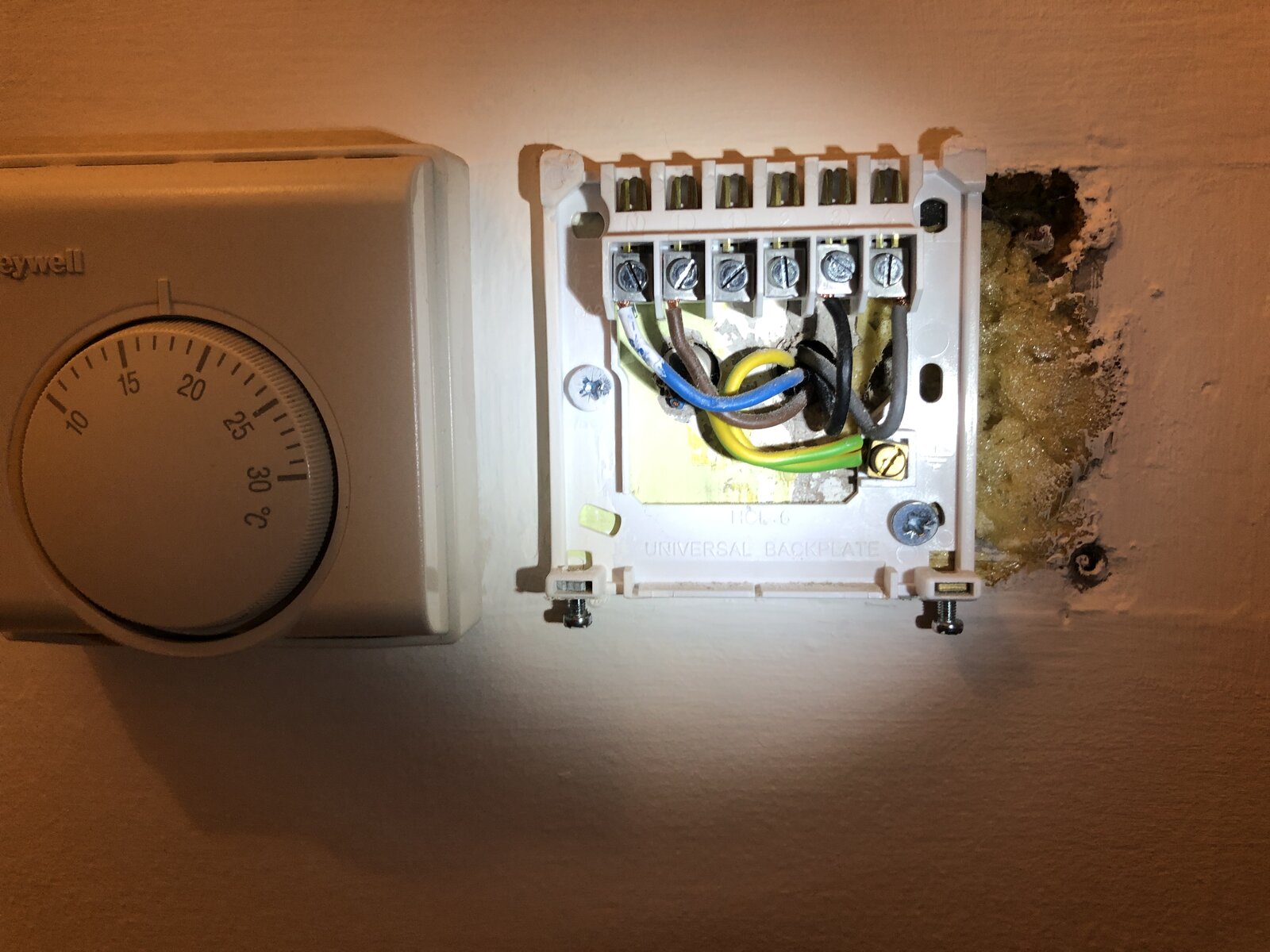

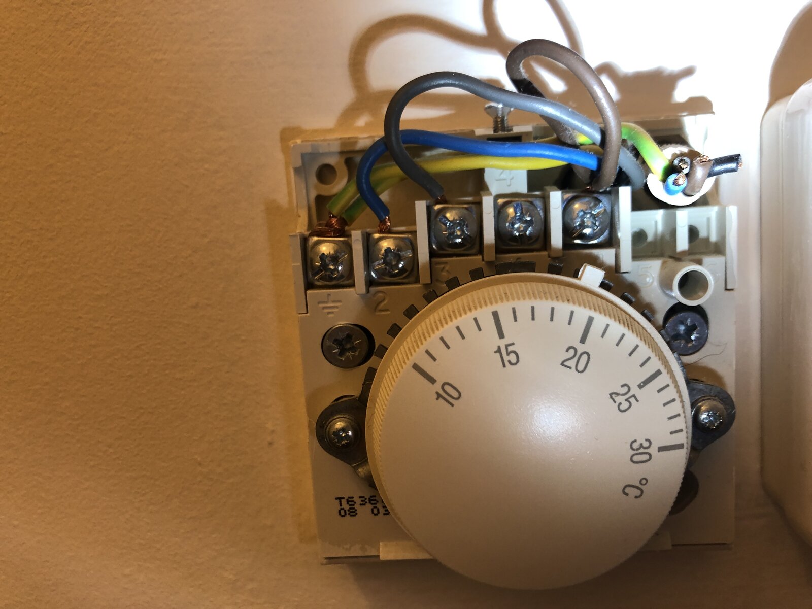

Ok, might be best to just rip out the C21 and Honeywell stat altogether, get some 5 core heat resistant flexible cable and do it from the boiler. Piggyback the LNE and then take the other 2 wires from the connections to the left of the earth wire (1 is currently the switch live) and put them to the com and NO at the Hive. Hope this makes sense?

What you do next depends on what you want to achieve.
The simplest thing to do (assuming a single channel Hive) would be to remove and isolate the black wire in terminal 3 of the Centaur plus.
Move the Grey wire in terminal 4 to terminal 3.
Add a short link wire between L and terminal 1.
Mount the Hive on the existing backplate.
And turn the Honeywell stat to maximum.
Removing the existing stat and wiring would be possible, but is a more involved process.

I have employed the Stuckinarut suggestion and ripped out the programer and stat and wired the Hive up as described direct from the boiler.
I have also used RamdonGrinch's suggestion and removed all cable associated with these pieces of equipment.
The result is an up and running Hive. I had to contact Hive customer services to get the thermostst to connect, but that was a hive problem.
