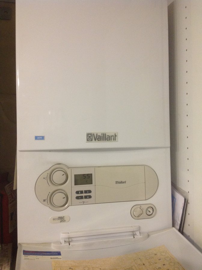

Thanks for this response I will take some pictures tomorrow and see if I can get them on line. The wireless thermostat is a Danfoss and the boiler is a Vaillant ecoTEC plus.

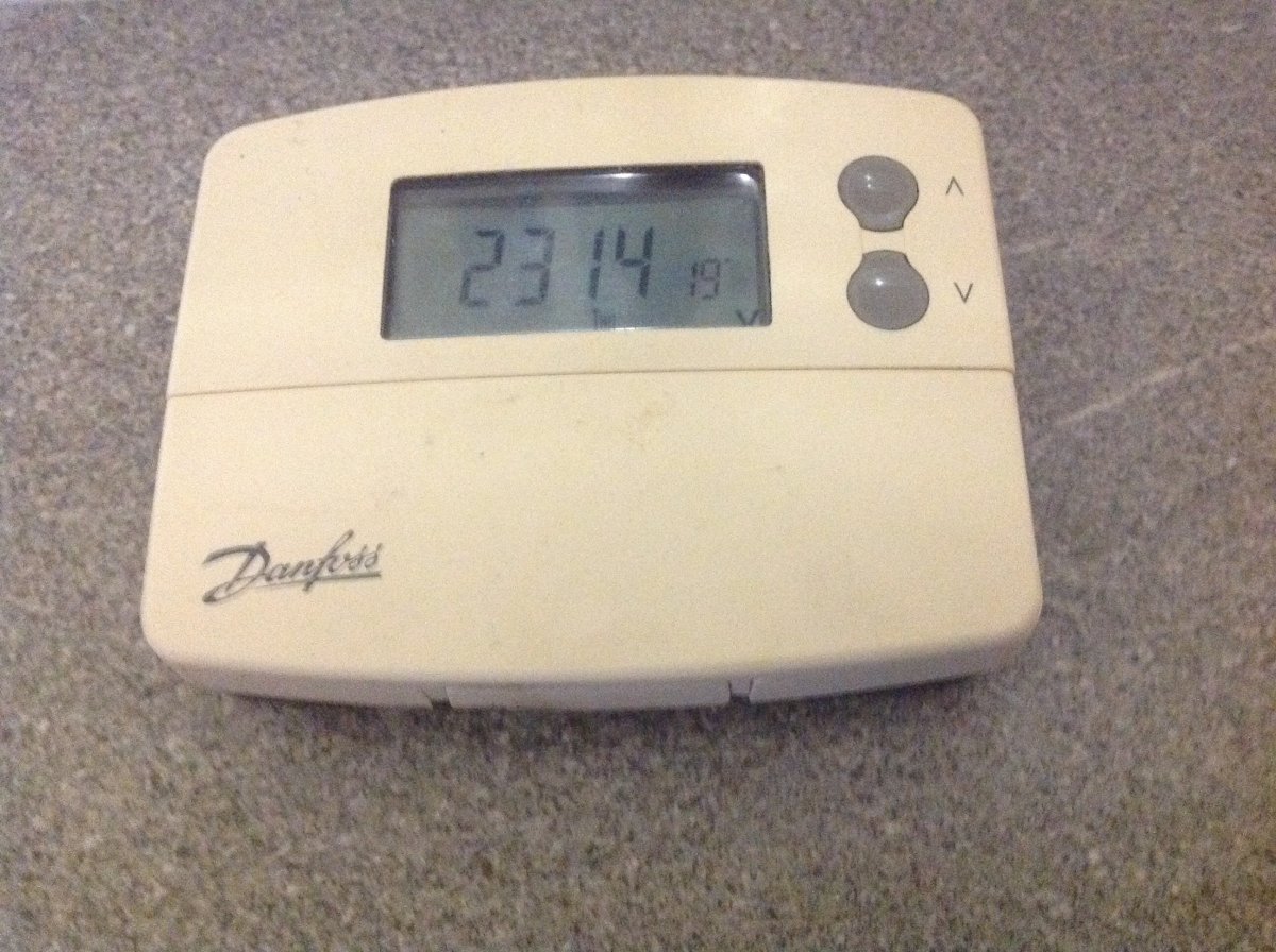

Yours appears quite an easy installation and shouldn't be to difficult to swap over because the Danfoss is already a programmable thermostat which combines time and temperature control, so there isn't any time control built into the boiler to remove or disable. From your photo the thermostat looks like a Danfoss TP5001.

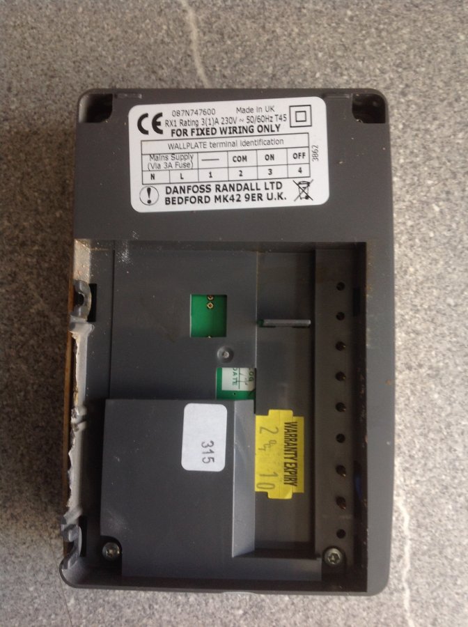

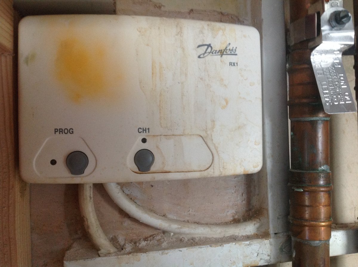

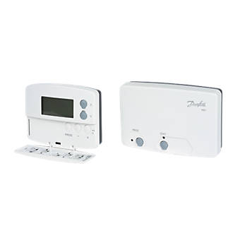

As it is a wireless thermostat, it is an RF variant and the control wires should be terminated at a Danfoss RX1 receiver (see picture below). If your receiver is an RX1, then you can proceed as below.
Danfoss TP5001 wireless thermostat and RX1 receiver
I found that I had only 4 wires on the old system
With 4 wires at the receiver, the wiring terminals used should be as below. However, if yours is different, or your thermostat is not a TP5001 RF with a RX1 receiver, don't proceed and post back with details of what you do have. The RX1 terminals allow the four wires to be identified as follows:
Danfoss RX1 Receiver
Terminal N = Permanent Neutral wire
Terminal L = Permanent Live wire
Terminal 2 = Common wire
Terminal 3 = Heating 'on' wire

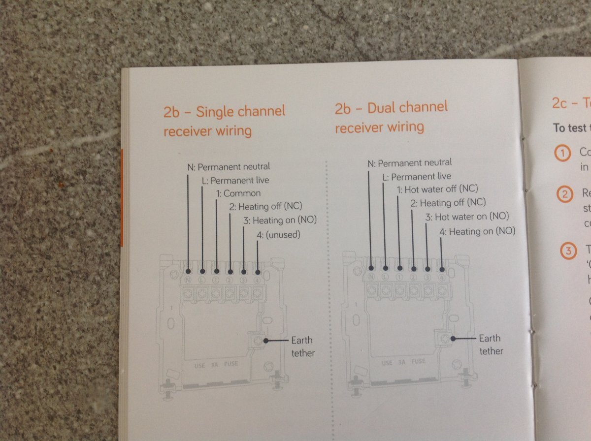

As you have a combi boiler, you require the Hive single channel receiver, to replace the Danfoss RX1 receiver. The wires should be reconnected to the corresponding Hive terminals that have exactly the same functions as the Danfoss ie:
Hive Single Channel
Permanent Neutral wire = N terminal
Permanent Live wire = L terminal
Common wire = Terminal 1
Heating 'on' wire = Terminal 3
I found that I had only 4 wires on the old system and on the new hive I need 5.
I'm not sure why you think you need 5 wires for the Hive though. If you are referring to a separate earth wire, the Hive does not need an earth connection, but there is a tether to park it if one is present.

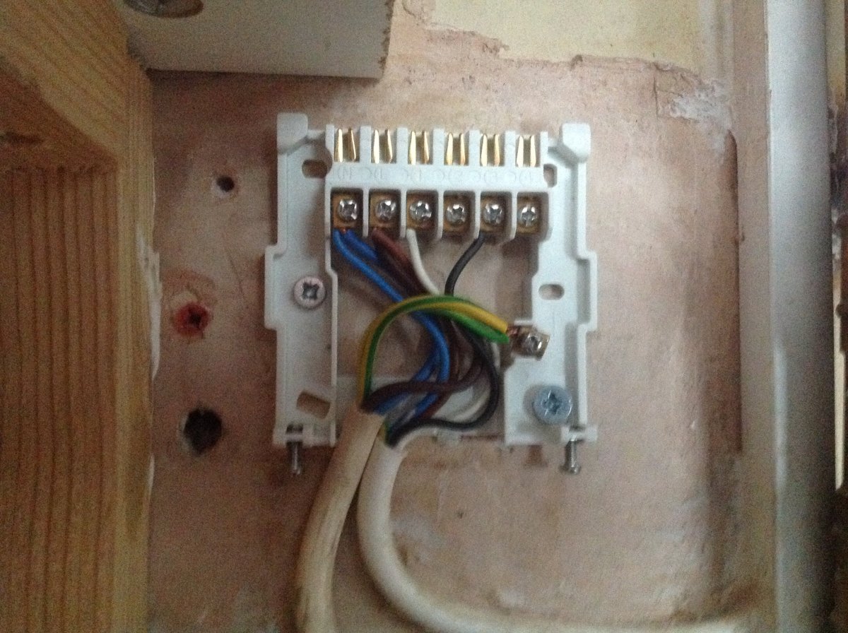

Hi all you helpers out there,
Here are the pictures of the controller that's in and a drawing from the hive v1 book.
Hope these help you help me.
Thank you all.
Thanks for the extra photos. That confirms my previous post. The wiring and receiver are as expected. As long as you have purchased the Single Channel version you may proceed as I said. Let us know how you get on.
So; basically all you need to do is move the white wire from terminal 2 to terminal 1. The others stay the same.
The two blue wires = Hive N
The two brown wires = Hive L
The white wire = Hive 1
The black wire = Hive 3
Edit: Take the opportunity to tidy up the connections so that there is not so much copper on show or wire whiskers poking out from the terminals.

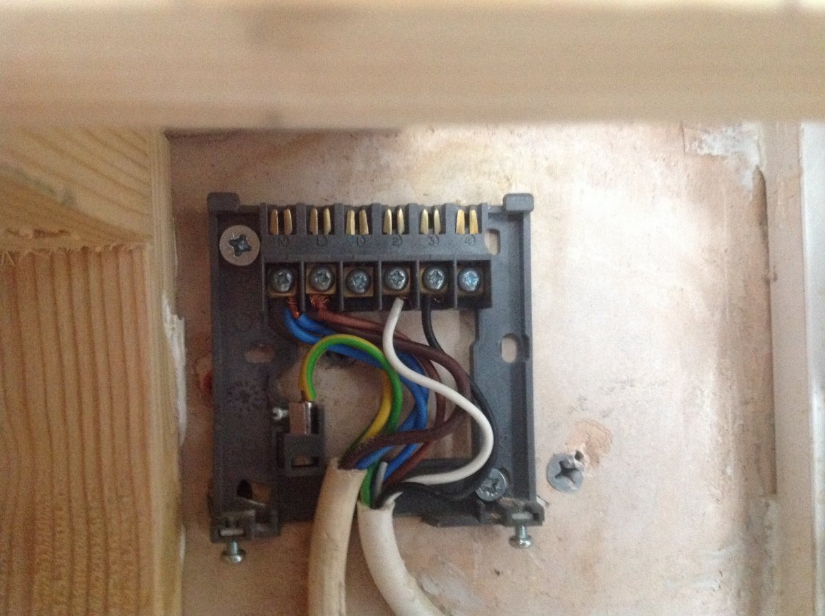

Hi Stem,
Having read your post it was obvious enough what to do. Why do people try to make things more difficult than they are. I have completed your instructions and the system is up and running. Thankyou so much for your help on how to make things simple.
I live in Leeds and I owe you a drink.
Have included a picture for you to see that I have tidied the wires up, for safety and it looks better.
Grand Job well done. Looks very professional. Pity the backplane didn't come with some cable clamps.
