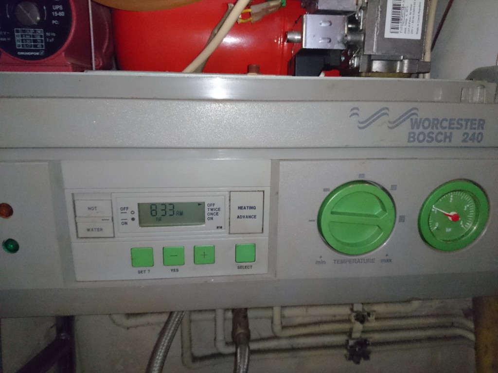

I have a Worcester 240 and a hive system that I removed from an old house.
I have attached images of what I am working with.

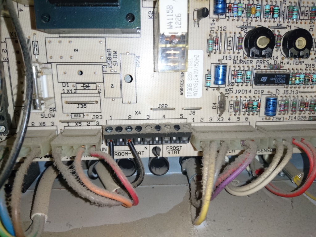

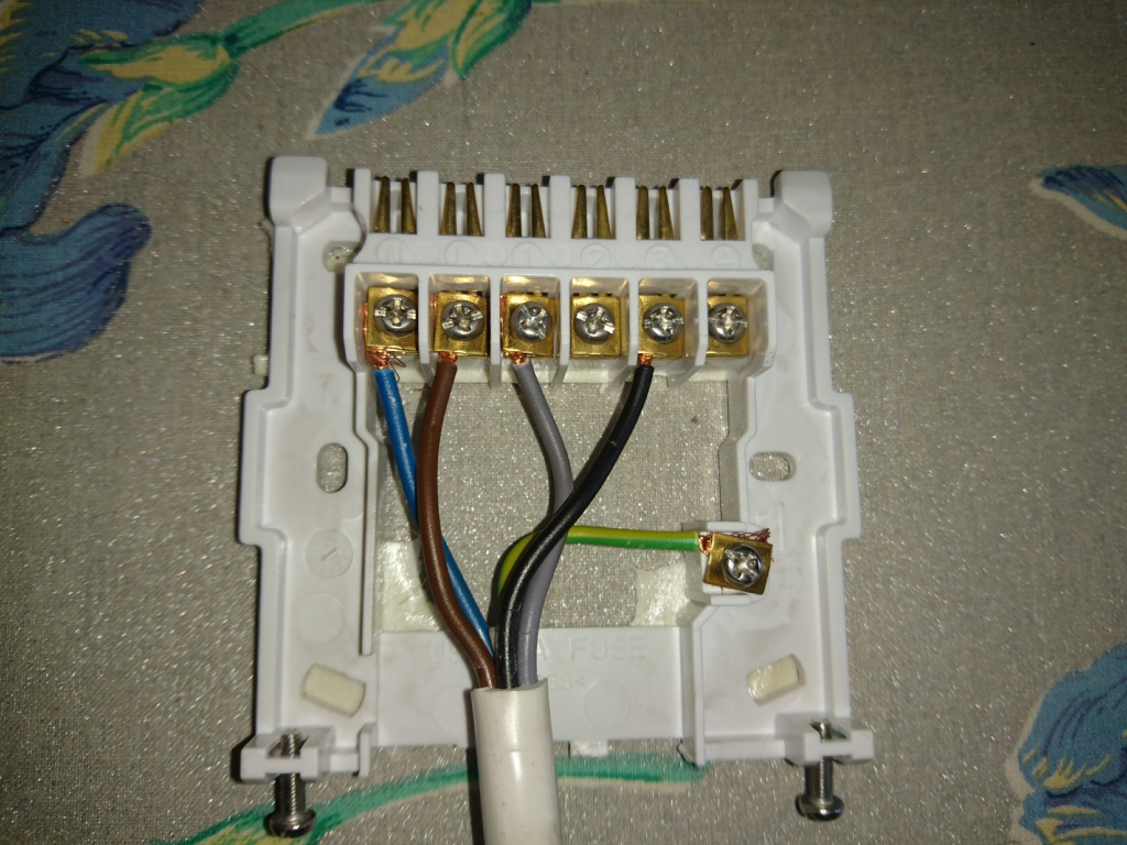

Where are 1 and 3 going from the HIVE backplate? Be careful with this boiler because if you fry one or both of them boards they are obsolete.
L and N to mains, Link L on backplate to 1. Use the black to grey on X4.
So nothing goes into x10, that stays as it is.
And the only thing that goes to x4 is the black from 3 in the back plate?
yep, you can use 1 with your grey from backplate, just easier to use link L to 1 on HIVE backplate.
You don't need it if you link Live and 1 on HIVE backplate.
