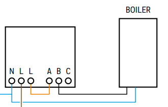

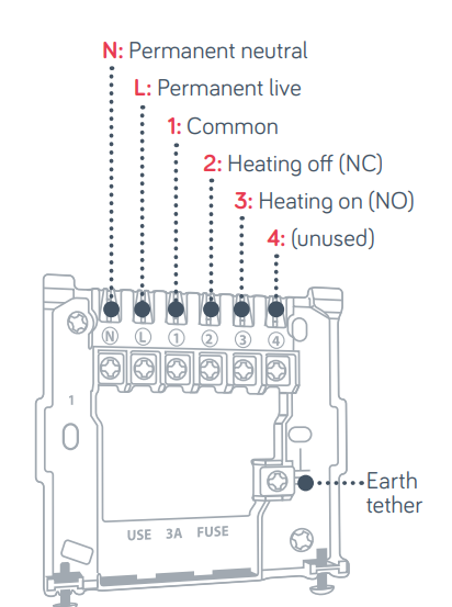

Hello, my old timer is currently working as shown in the picture. I would like to change it over to hive. Could someone help with where the wires go?

Greetings @splintertop,
Yes they would be as follows from existing to Hive:
N to N
L to L
Link from L to A to L to terminal 1 (common)
B to 3 Heating on (NO)
Park CPC/earth wire if you have one there
