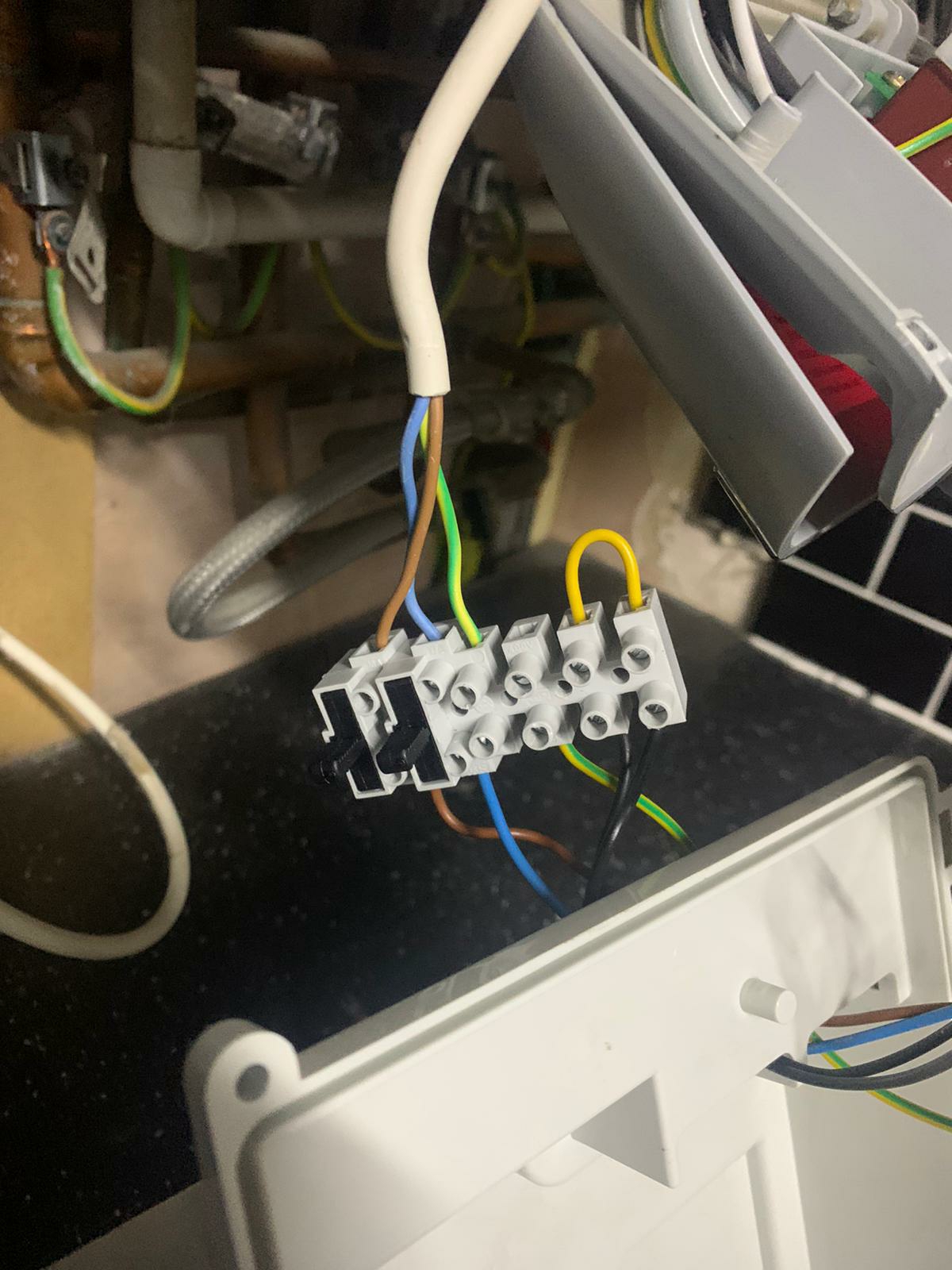

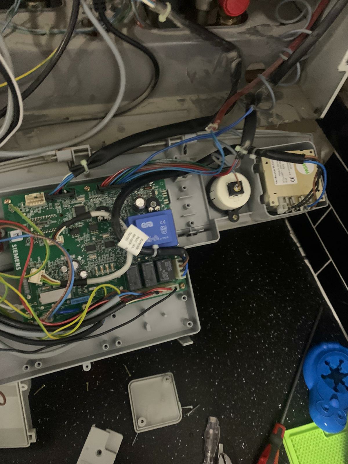

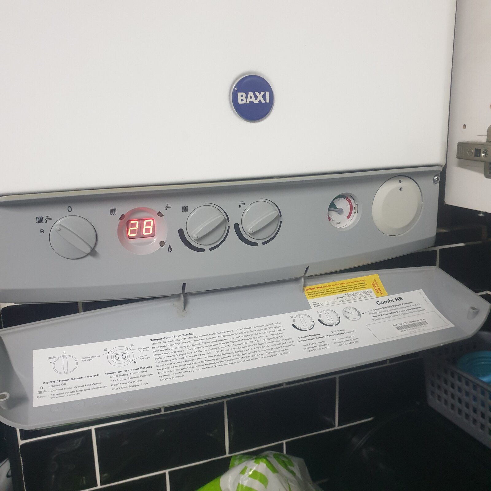

Hi so I have searched the forum and still not having any look I was wondering if someone could shed some light on wiring in this hive to my baxi boiler. I have wired up exactly as follows. Live to live neutral to neutral earth to earth. And the 2 black wires to terminals 1 and 3. The bridge wire also removed as instructed on the front of boiler. Also unclipped the baxi wireless analog thermostat. Everything is working as it should but the boiler just wont fire up the light on the hive receiver lights up. Just wont fire. Any help would be greatly appreciated. I've attached a few pictures if this helps. Thanks

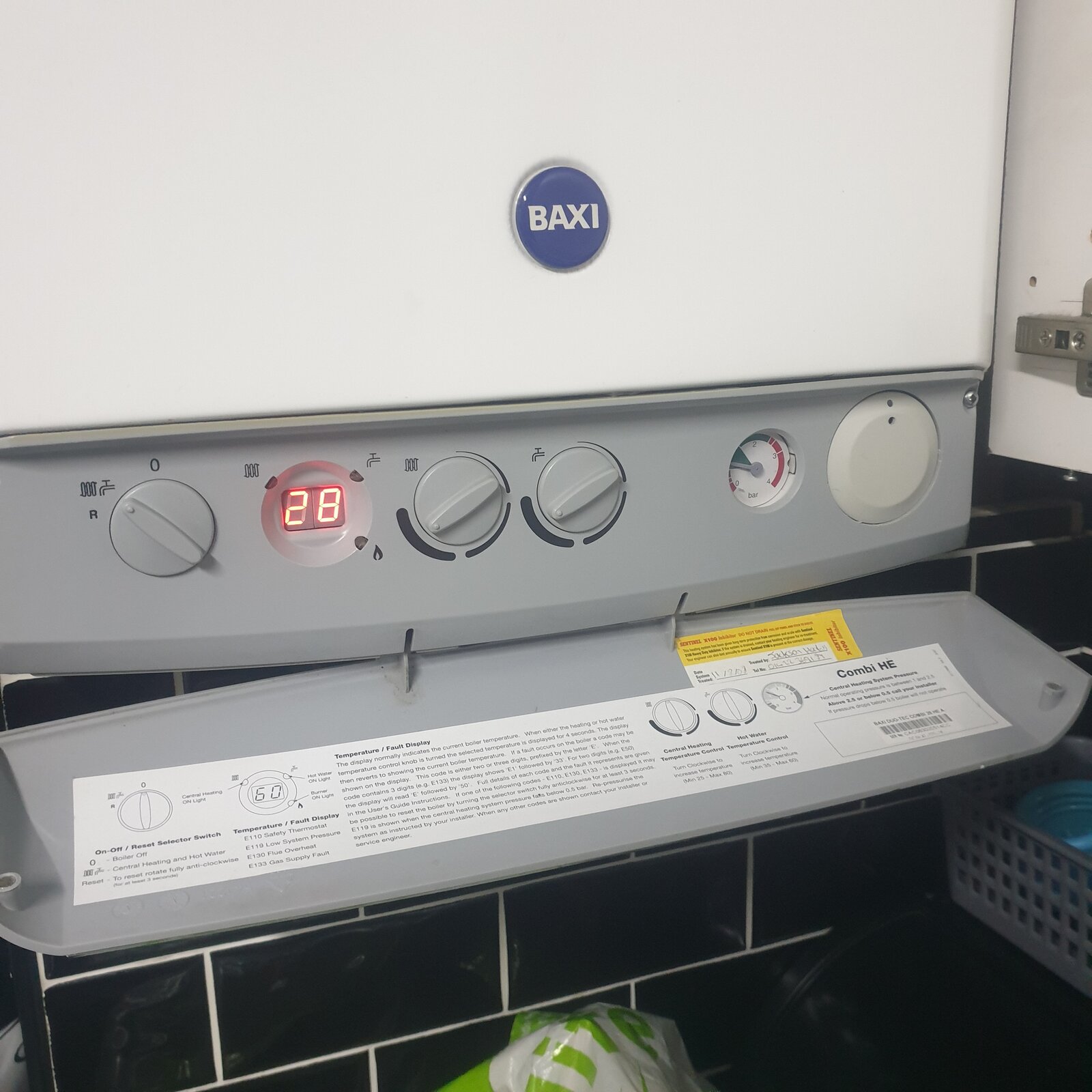

Set time clock/switch to constant, the one that’s on the right hand side of front panel
It has a baxi wireless thermostat. This is the front of boiler

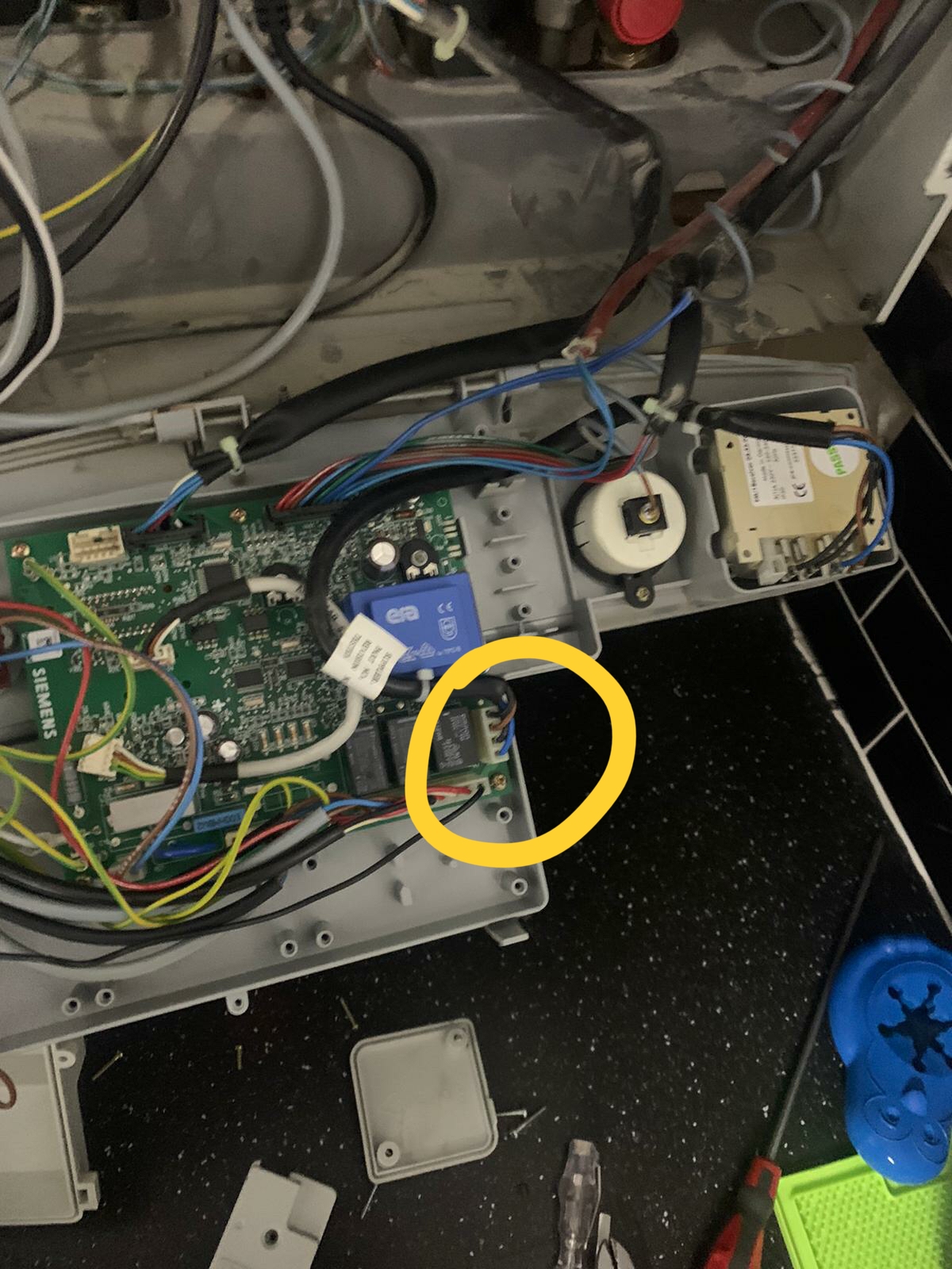

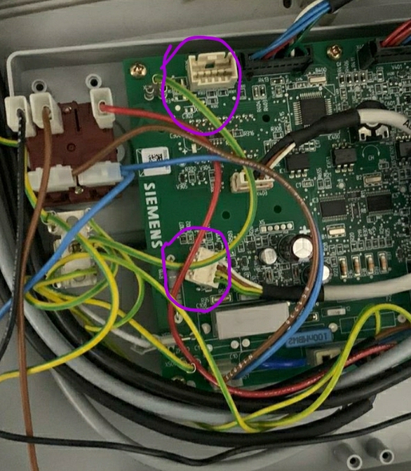

The receiver is just on a plug in clip so I just unclipped it. How would you recommend bridging it out? Cheers

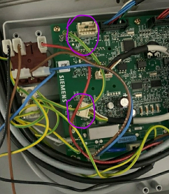

Try unplugging it from here:
I also tried plugging this cable in as it was just left unplugged so I thought that might bridge it out
