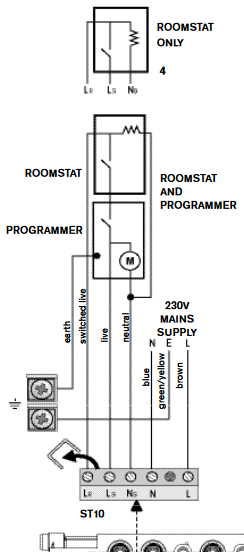

I'm hoping someone can confirm the wiring before I go ahead and (hopefully not) cause some damage.
I'm wiring just a Hive Heating system, the water is on-demand and not set via timer.
I'm planning to do the following:
Questions I have:
1) Does that look right? Will I have two wires screwed into the L and N terminals of the Hive plate as they come in from mains and go back out to the boiler?
2) Do I need to have a jumper between Live and Common (L and 1 on the plate)? I've seen some tutorials on Youtube saying that it is needed so that the boiler can switch the live to the 'heating on' output on the boiler
3) My boiler has a jumper between Ls and Lr, do I remove that?
Thanks in advanced.
The Hive should get its 230v supply N & L from the same 3A fused supply as the boiler. This is usually a fused connection unit not a plug.
No, you don't need a link.
Yes the link is there because there isn't presently any room thermostat fitted.

But to clarify, with power coming in from the fused supply, does the diagram still stand - as in, the supply of L and N comes from the fused supply, into the hive plate, and then from those same two terminals on the hive plate, then goes back out to the L and N on the boiler?
Hive N connects to the Boiler N
Hive L connects to the Boiler L
Remove the link between Ls and Lr
Hive 1 'Common' connects to Boiler Ls (Live supply)
Hive 3 'Heating' on connects to Boiler Lr (Live return)

Thanks Stem. And N and L from fused supply into hive also?
FUSED SUPPLY N + L ---GO INTO---> HIVE N & L Terminals ---> FROM HIVE N & L ---GO INTO---> into BOILER L & N
(Im comfortable with the 1 + 3 connections, just concerned I've not understood the flow above here correctly).

Of course for gas seal looking at round cable, and to be rated at 90°C not thermal plastic, would need to be thermal setting, it states 3A fuse nothing about if plugged in or with a FCU. The diagram is good.

For anyone wondering, the answer to this question was yes.
All done and working fine as per diagram in post #1 which is also the same wiring as used here
