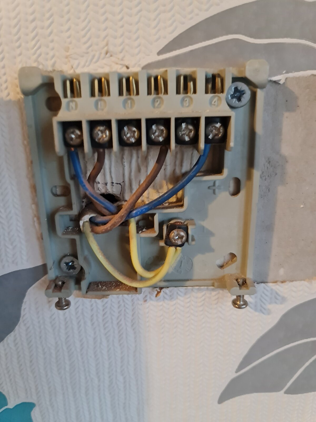

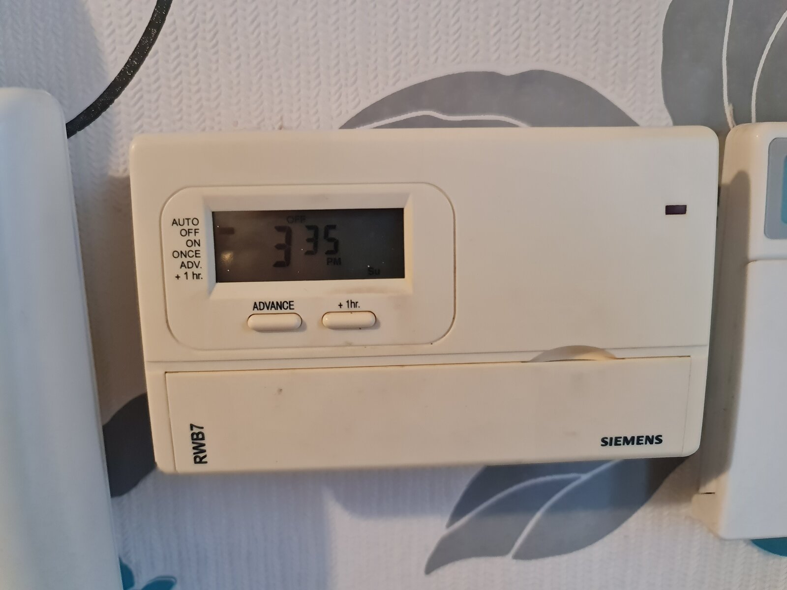

Hi
I currently have a combi boiler with a siemens rwb7 programmer which I'm looking to replace with a hive.
I've attached picture of the wiring behind the current unit.
I'm i correct in that the wire in 2 will go into 1 and the wire in 4 into 3 on the hive
Advice would be great

yes that is correct dont make any links that other posts on here mention and obviously Nto N and Lto L then put the earths into the hive earth tether
