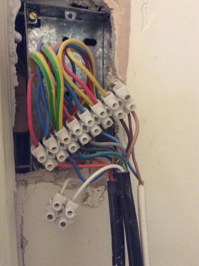

Can you post some pictures of both the thermostat wiring and the wiring centre, if there is one. If there is it would help a lot if you were able to identify the wires there that come from the existing room thermostat.

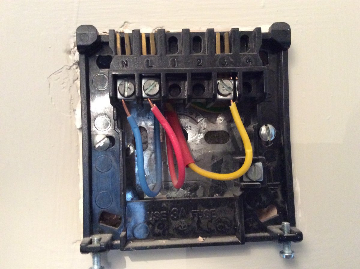

I attach a couple of pics - this first is the room stat wiring which looks quite simple and the second is the wiring centre in the airing cupboard which looks horrendous! I posted a picture of the wiring of the existing Drayton controller earlier.
I think I will pursue option two in your post unless you disagree?

Option 2, is probably the best option for you. The live switching wires at the thermostat are Red and Yellow. They should be joined together. The Blue is a neutral which should be isolated and left on its own.
If you did want to remove the thermostat wiring altogether, then you would need to trace the cable back to the wiring centre and remove all three wires. Then link where the Red and Yellow wires were removed from. This can be tricky sometimes because depending on the personal preference of the original installer and the layout of your home, sometimes the thermostat has been wired back to the programmer instead of the wiring centre.
That does look like the easiest option and just means connecting the red and yellow together and isolating the blue safely on it's own.

Just looking at your photo of the wiring centre, the metal back box doesn't appear to have an earth connected to the earthing screw (top left hand corner) If there isn't an earth connected to it somewhere else, for safety sake, you should add one.
