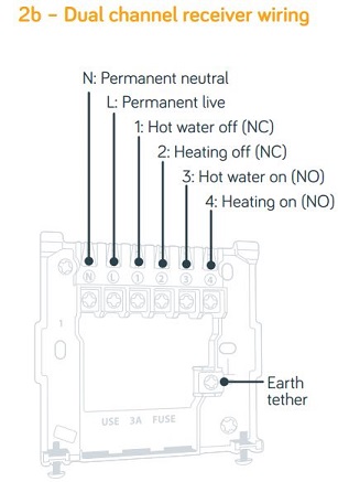

The wiring diagram easy
but how your going to use it is another question.
