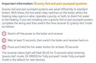

I've got an old Danesmoor 20 25 oil fired boiler with built-in programmer and room stat, the ch is a sealed system and HW is gravity fed. Can anyone shed some light on how to wire hive to it, do I need a single or dual channel hub.
Steven
The Single Channel Hive is for systems that only have control of the central heating, and not timed hot water control (ie combi boilers)
The Dual Channel hive is for systems that require control of the central heating and also have timed control for heating stored hot water supplies (ie a hot water cylinder)
When it comes to the installation, boilers with built in controls can be more difficult. There's an example of fitting a Hive to a Danesmoor here. After reading it you may decide that professional installation would be the best option for you.

The restriction on the control functions is usually down to restrictions in the existing plumbing system, which means that it is physically impossible to have the heating 'on', unless the hot water is also 'on' at the same time.
In which case, even if you were to install Hive on such a system you wouldn't be able to get independent control of the central heating without converting it to a fully pumped system / incorporating motorised valves/s and a hot water cylinder thermostat.
The Hive has the facility to be 'dumbed down' [See excerpt from the Hive installation instructions below] by setting it to 'gravity mode' to suit the restrictions of such a system. But that means that it would still work as it does now, and that the hot water will have to be 'on' before you can have heating.

Hive and Nest are wired different with C Plan, I am told setting Hive to gravity the DHW relay works the boiler, and the CH relay works the pump, and Hive automatically switches on both relays with CH and only the boiler relay with DHW, but with Nest you have access to the com terminal of the relay, so com goes to boiler and N/O is always line, and N/C goes to CH N/O doing the same as Hive but with wires not software. As soon as a tank thermostat is added then the N/O and N/C contacts of the tank thermostat are wired as with Nest instead, I would guess with Hive it would not be set to gravity even though it is?
