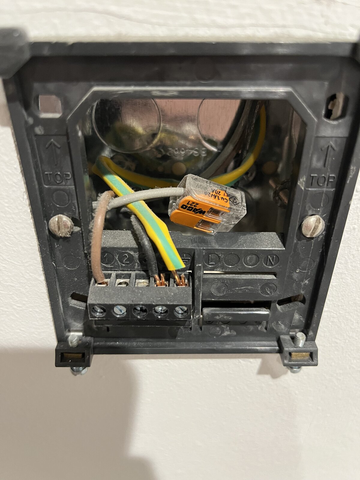

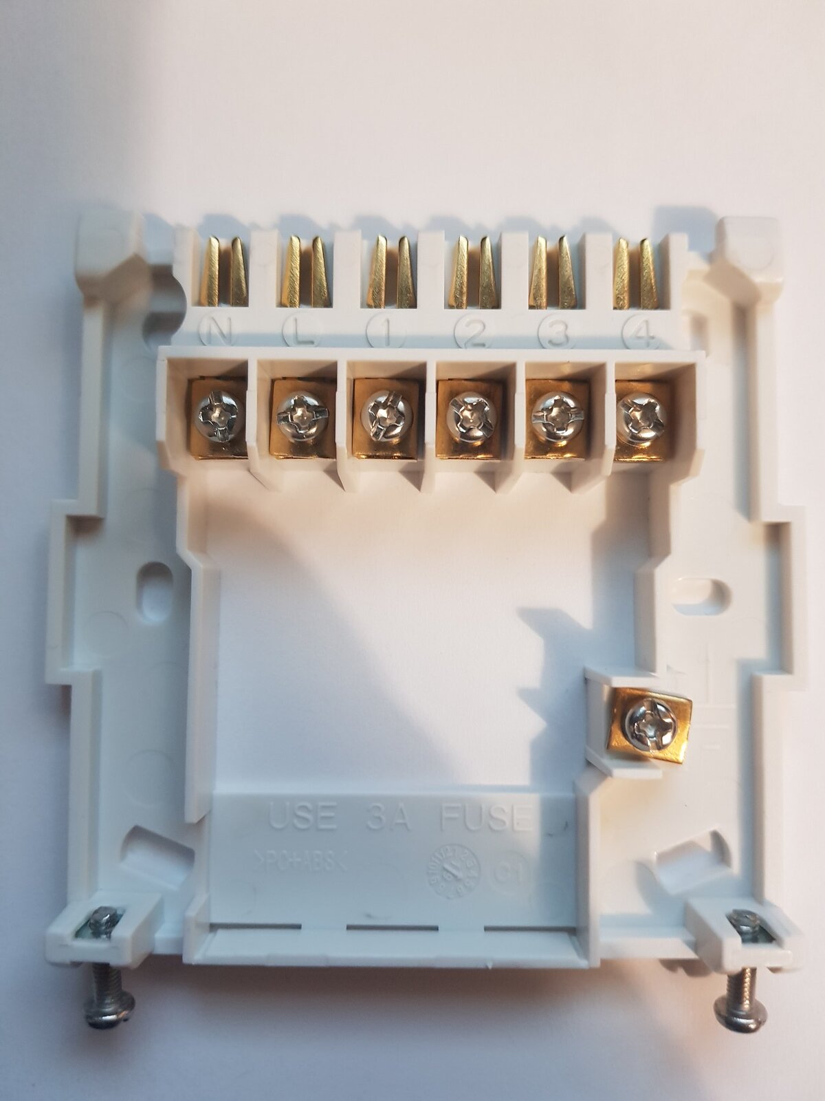

I am trying to replace my thermostat with a hive Mini. My current thermostat is a Horstmann C-STAT 17-B & I have an ideal logic combi ESP1 30 boiler.
I've attached a photo of the wiring of my current thermostat (the grey wire is not attached to anything) & the hive backplate too.
Any help would be greatly appreciated!

So you want to replace a battery powered thermostat with a mains power thermostat, so only way is to get mains to the thermostat/hub. It seems the boiler can be controlled with 230 volt
but my question would be why Hive with a Opentherm enabled boiler? if fitting a new thermostat would it not be better to use OpenTherm, not that much between Hive and Wiser price wise so why fit a cheap thermostat like Hive, it is spoiling the ship for halfpenny of tar.
But Wiser also needs 230 volt power, about the only one I know is battery powered and smart is Nest e, but Nest e will not connect to TRV heads, not sure about the Tado range, think there may be a battery powered version.
Some boilers the electrical connections are in the room sealed part, and needs gas safe person to work on it, others are not, and I don't know which yours is, but clearly can't swap battery to mains powered without wiring in the extra mains power.

As Eric mentions above, your Hive receiver needs to be supplied with mains power.
He also correctly mentions that, taking the cover off your boiler to access the wiring connections, breaks the room sealing of the boiler and requires an RGI.
Without knowing how the other end of the cable is connected, all we can do is guess.
Given the existing wiring, we can safely attempt to wire up the Hive and see what happens. The worst that can happen is it won't work.
With the power safely isolated; you can try connecting the grey wire to N on the Hive backplate (Assuming single channel Hive).
The Brown wire to L
The Black wire to terminal 3
The Green/Yellow wire to the earth terminal
And add a short link wire between L and terminal 1.
You fit the receiver near the boiler where all the necessary wiring is and remove the existing cable to the thermostat position then the Hive thermostat can go wherever you want.
