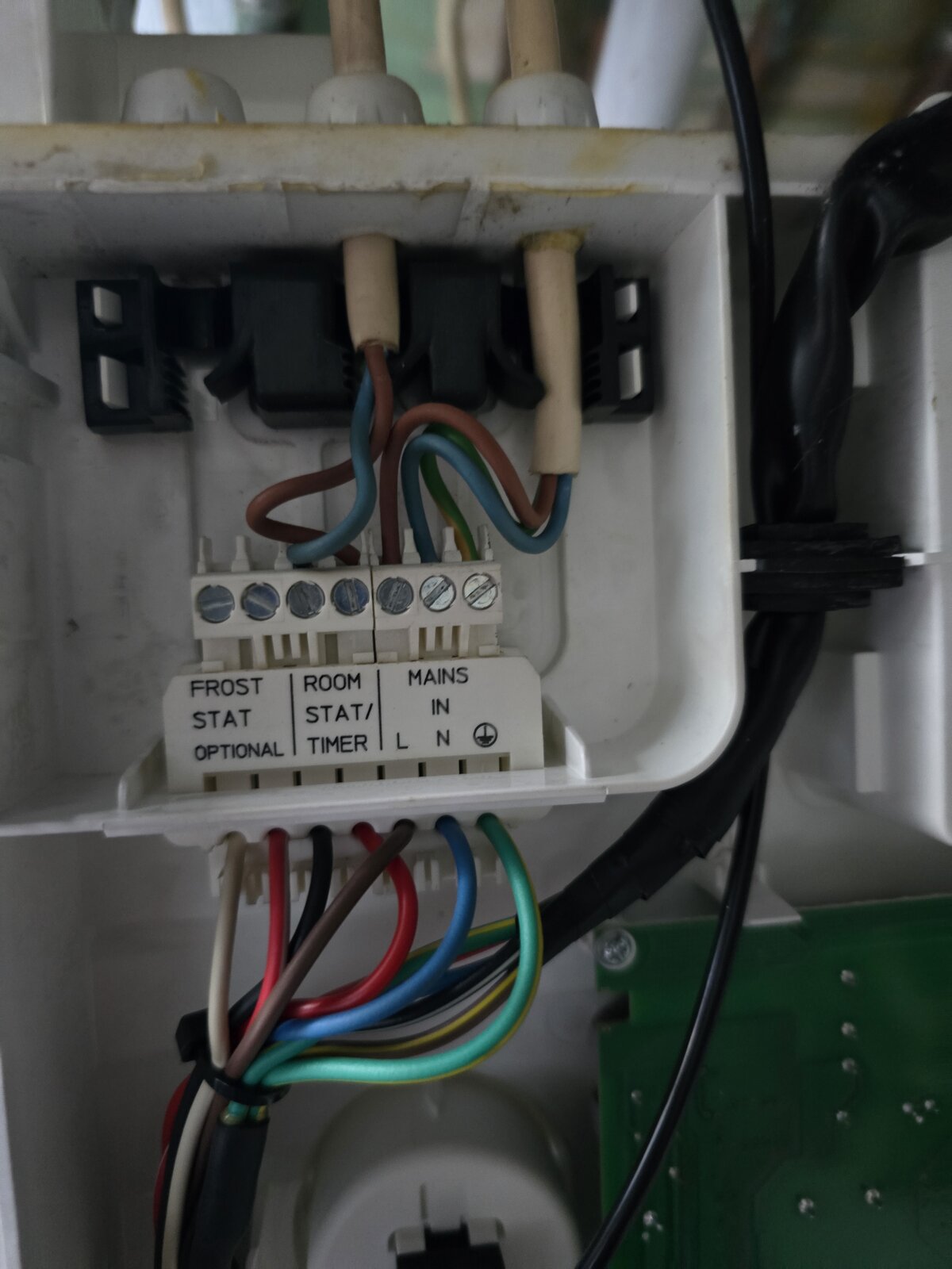

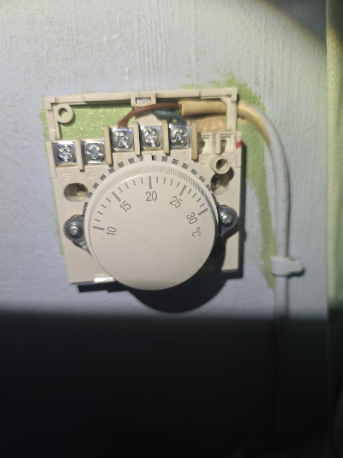

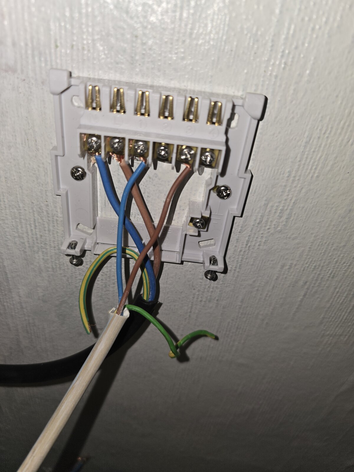

Hive wont fire up my logic c30 other post on here seem to have different wiring to mine any help will be appreciated
10 Nov 2024
2
Everything works just won't fire up the boiler

Which version Hive do you have - are there one, or two buttons on the receiver?
Are there any other external controls, like a programmer, and did the existing thermostat correctly fire the boiler, before you attempted the swap?
I’ve managed to sort it seems my built in timer was set wrong a bit of tinkering and it’s working the way it should.
Glad you’re sorted. Careful though, as those ideal logic covers form part of the combustion circuit and make it room sealed. The burner baskets on the logics are porous and could easily emit fumes/products of combustion.
