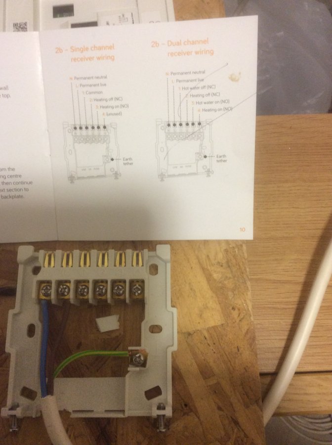

i am a qualified electrician , but I'm not 100% on hives
I have an alpha inc 28x boiler
I have run power to the hive
Not sure where to run the other flex to for control
Please help
Many thanks

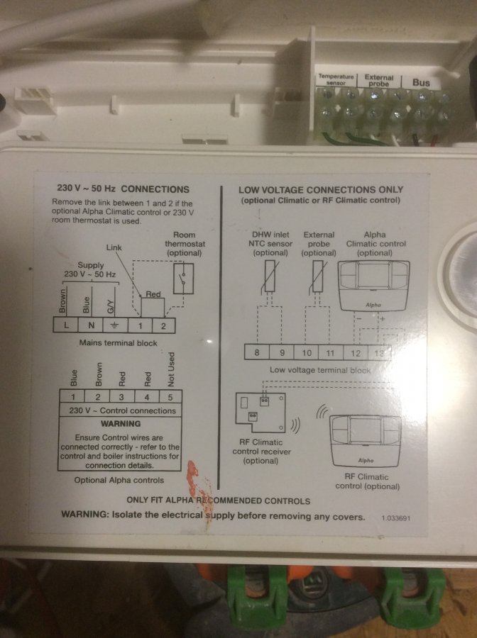

Terminal 1 at the hive (common) should connect through to terminal 1 at the boiler and terminal 3 at the hive (heating on n/o) should connect through to terminal 2 at the boiler - the hive is going where the boiler circuit diagram shows the optional room thermostat.
image.jpeg image.jpg Thank you, I wasn't sure if it went to the lv side of the boiler I was thinking of taking the link wire out but wanted to make sure that the 240v didn't blow the hive I measure the lv which was 25v,
Yes I am qualified but haven't had any expirence with thermostats , I just do new installs and testing boards . I have my 2230 leval 3 , 2391 and 17th edition . Just not much experience with boilers. Many thanks again .image.jpeg
