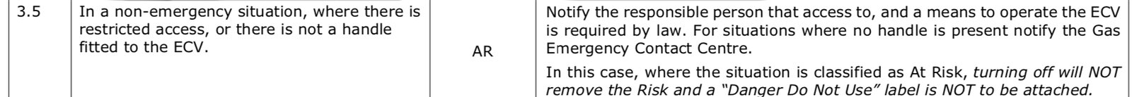

Restricted access to the ECV is classed as At Risk in a non-emergency situation, for which the correct action is to turn off the supply until the situation has been corrected. The meter needs to be moved to a communal area.
Sorry, I’m inclined to disagree with turning it off, as it doesn’t remove the risk as per GIUSP:
Might have to agree to differ then! From my point of view, it does remove the risk as it prevents gas appliances being used with no access to emergency isolation, and additionally removes the risk of leakage with no access to emergency isolation. The risk is that the supply can't be turned off in an emergency. By turning the supply off before an emergency can occur, the risk is removed.
Have to agree with Andrew.
Isolating the installation pipework and appliances downstream of the ECV, by turning it off, DOES remove any risk.
Pipework upstream of the ECV that is at risk, such as a built over supply, is usually something that will not have the risk removed by turning off the ECV.
That's how it was explained to me at gas school :)
