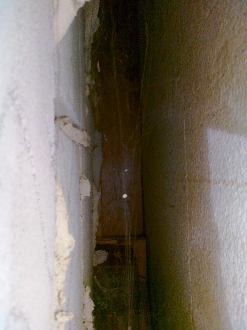

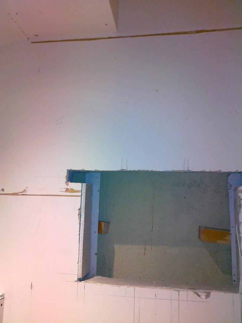

Ok. 2 pics. One shows hole and beam above. (The chap today decided that maybe a piece of 4x2 slotted in would help spread the load and shut me up, so has cut the hole in readiness!) The other pic is of the end of the steel, taken with my hand in the cavity. You can just see the end of the steel not going into the party wall but protruding the blockwork wall by about 20cms.

Ok. 2 pics. One shows hole and beam above. (The chap today decided that maybe a piece of 4x2 slotted in would help spread the load and shut me up, so has cut the hole in readiness!) The other pic is of the end of the steel, at the bottom of the picture, taken with my hand in the cavity. You can just see the end of the steel not going into the party wall but protruding the blockwork wall by about 20cms.

OK; suspect you may have a potential problem there, depending on the load the beam is carrying. Judging by the width of the casing of the beam in the first pic, it looks as though it's an 8" x 8" wide-flange beam, so could be carrying significant load.
The 4x2 which your builder has proposed would be useless in that siutation and would NOT help bridge the load over the opening, so forget that.
IF the load is too high for the remaining block (and you can't be sure one way or the other at this stage) you would need something like a 6x4 pre-cast concrete lintel over the opening, AND it would need at least 6" bearing each side to distribute the load properly.
This would entail temporarily propping the beam from below while the lintel was inserted because the cut-out for the new lintel would further 'undermine' the beam and compromise stability.
Without knowing the general structural arrangement no-one here could say, but in your own interest, you should really stop the work for now and get an SE to look at it.

Thanks for the reply, Tony. The casing is deceptive, more to do with aesthetics I think, as from what we could see the steel is only 4x6 max. Would a 8x8 beam be supported on such lightweight blocks? Our roof is a sort of Mansard shaped roof with dormers and I have read that in a similar situation, the steels either side were more for straightening rather than load bearing, and that the parapets take the load of the roof, rather than the gable ends. Have you ever come across this yourself? Am I talking rubbish? :confused:
(with a suitable padstone, you can put heavier loads on aac block).
If the steel is a 6" x 4" (actually 6" x 3 1/2") it may probably just be supporting a floor; what the loading would be I couldn't say.
It's your call! - I think that's all anyone here can say without knowing full details of the structure. All that can be said is that - if the loading IS a problem - that piece of 4x2 timber will be useless.
