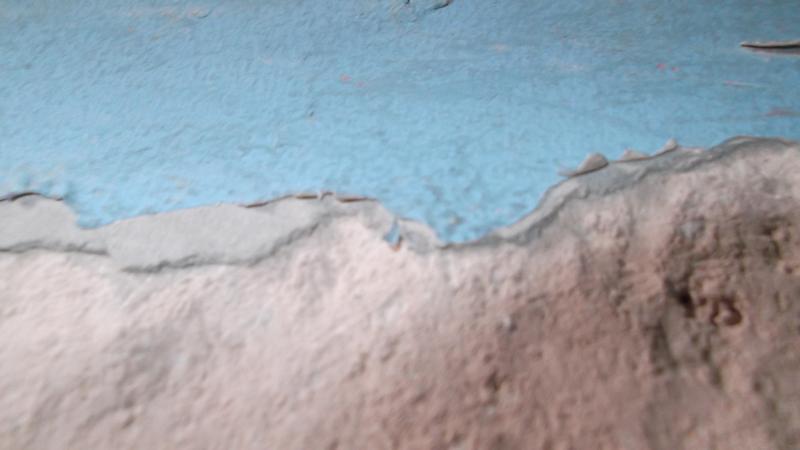

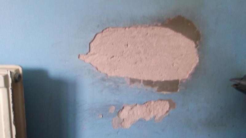

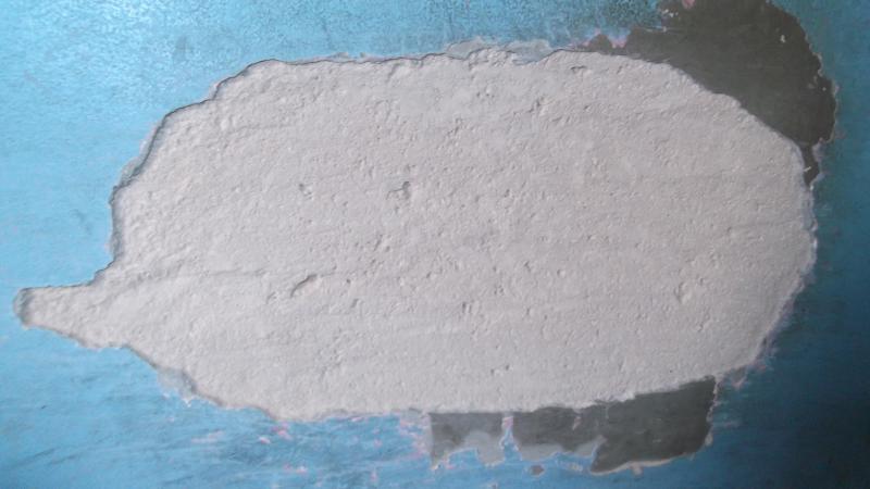

Hello,
I have a big hole in my lounge wall, well more like a giant chip. As it is quite big, I assume pollycell wouldn't work. I am useless in most DIY so apart from pollycell, I have no idea how to best deal with it.
It started around 5 years ago and has gradually gotten worse due to the computer chair rubbing against it.

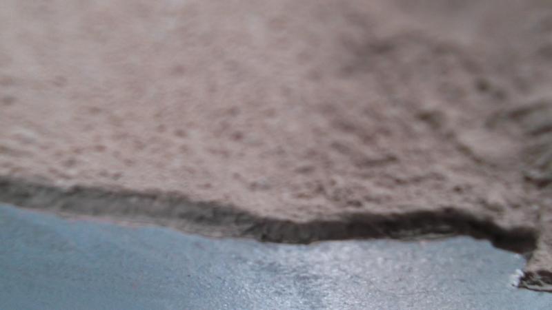

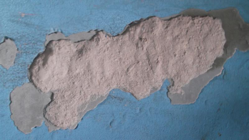

Some of the images try to show thickness (not very well though). At its deepest, I would say they are between ½cm - 1cm thick. The top one is concaved while the other 2 are just uneven.
The round one is further down the wall. The whole are has been left untreated.
Any ideas on how to deal with it would be appreciated, thank you.
Just remove any loose plaster, dampen surfaces slightly an fill with easyfill.
Sand when dry and if required fill again.
