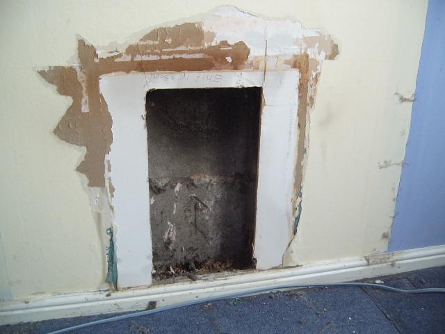

There was a gas fire sat in front of this hole and there is a flue, I want to block the hole up.

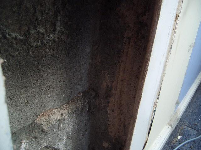

The hole is cut out of plasterboard so there is no plaster to hack off around the opening. Also, it doesn't show on the photo but the left hand side has been skimmed with concrete so you can't slide plasterboard behind the existing plasterboard.
What is the best way to do this please?
Many thanks.
can you stud behind and make the studs stick half behind the existing board then screw through the existing board innto the stud and also cut a piece of platerboard into the hole, screwed in place.

Couple of things;
- I assume I would continue the multifinish over onto the existing plasterboard by a couple of inches. Should I thin it out using a devils float? Should I use easyfill instead of multifinish as it is probably easier to rub down?
- Some of the paper has peeled off the existing plasterboard to reveal cardboard/paper, what should I do to this before I paint it?
Thank you.

After you provide the stud work & plasterboard (as 1John advises), I think you're best with some Bonding to fill it out a bit just under the wall level (as looking at the thickness in the right hand pic, it looks about 10mm deep).
I.e. the approach Roy C gave you in the previous post.
A devil's float has nails/spikes in it for scratching up render/undercoat plaster. Don't think this was what you meant.
To fill out the last mm or so, you're prob fine with easyfill for ease.
There's only 1 skin of paper on plasterboard as far as I'm aware. So assuming the paper peeled off on top was a wallpaper anyway (or lining paper)
If there is paper still on the board and it is well stuck still, I'd perhaps ensure all smooth with easy fill. Then it will give a neat finish with paint.

If the existing plasterboard is skimmed then your new board will be a few mil shy, rule off with one coat and skim over with easyfill, sand back as previously described
