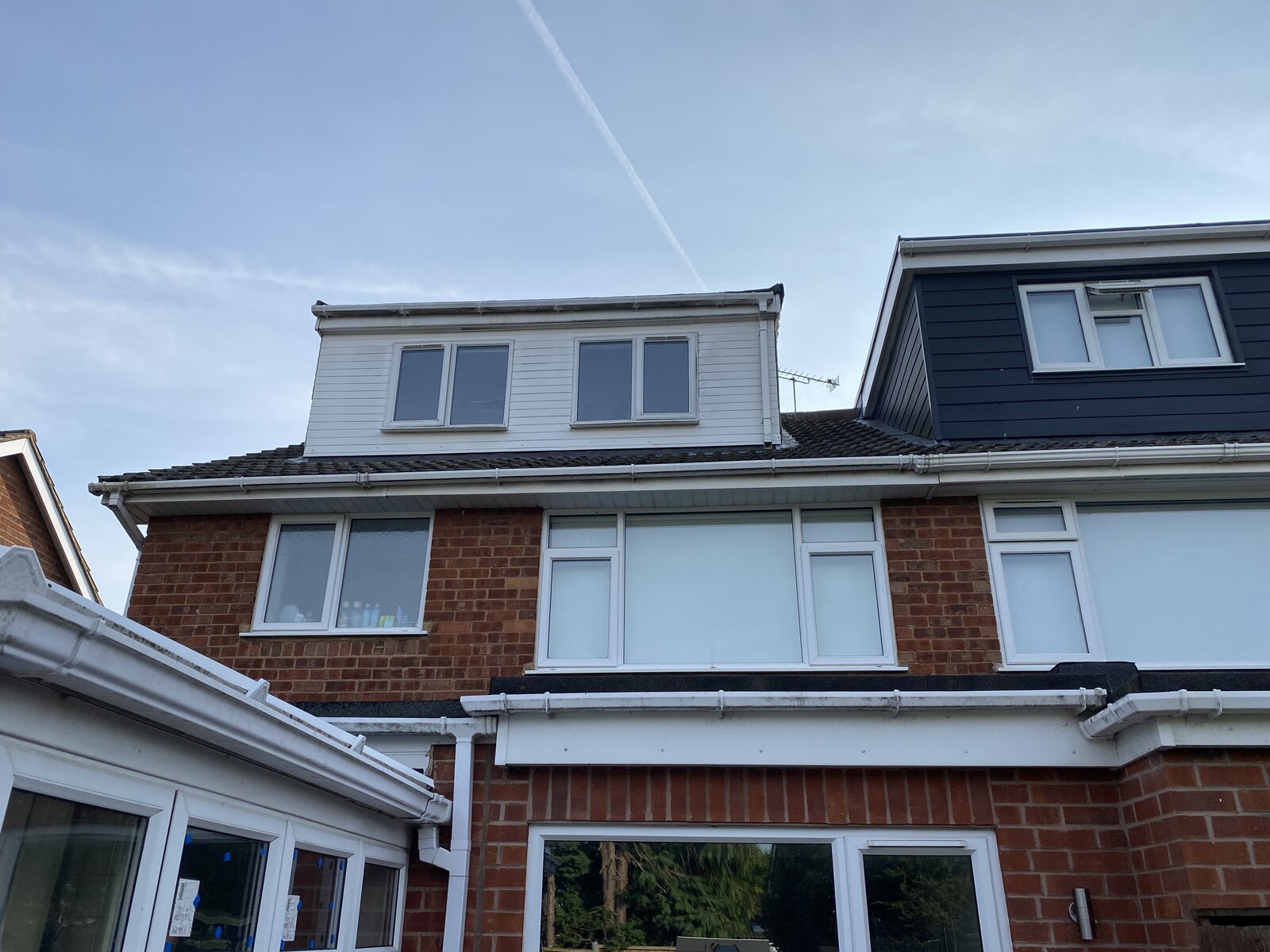

As title suggests really. Current property has a dormer on top and it’s been clad with hollow soffit boards. Or at least, they look like that but seem to be smaller. It needs replacing as I’m putting a smaller window in. From what I’ve read you can’t use hollow soffit boards as cladding. Is that right?
Only ones I can find are 300mm boards and the ones on there are slightly smaller than that but are still hollow. Any idea what they might be?

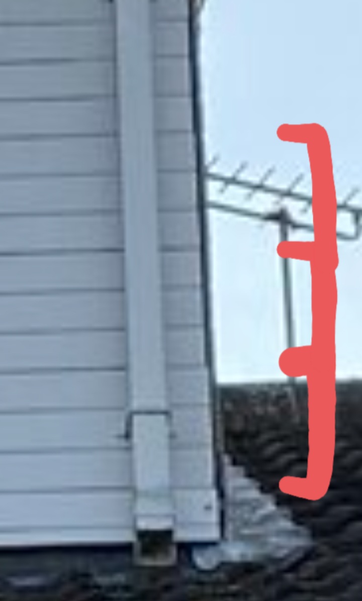

I’ll take a picture and upload tomorrow. I’ve attached one but probably too difficult to see the detail on it. Not sure if the pins at the bottom are a clue?
Yep, you're right! :oops:
You can see the boards are in groups of three:
The finish and corner detailing also seem quite poor.
I will wait for second opinions, but I would be tempted to rip it all off and replace with the uPVC shiplap cladding listed above. At least it shouldn't set any alarm bells ringing when the buyers survey comes back.
Yeah. One of a number of things that’s been poorly done that I’m rectifying. I’m surprised it got signed off in all honesty. The window on the left is being replaced by a smaller one. Slightly worried what I’ll find when I rip it all off though.
Hollow boards are for soffits, and are not water resistant when laid vertically.
I check these when carrying out a survey and flag them as a concern.
Also plastic not suitable within 1m of a boundary, unless it can be proven that there is other fire resistant material in the structure. Again reported on survey.
When you say boundary, you mean from the roof edge or the property boundary? What fire resistant material would you expect to see?
Any part of a building within 1m of a property boundary should constructed substantially of non - combustible material, or be suitably protected if not.
Plastic cladding on a dormer close to a boundary would normally be picked up on a survey and then the problems start.
You may, if questioned be able to demonstrate that the particular cladding does not support spread of fire, but you should also be prepared to demonstrate that the structure behind does not either, and cavities are fire stopped. Because as soon as fire spread is mentioned on a report buyers become twitchy.

So as you look at it in the picture, the left side is well over 1m as there is a wrap around extension on the ground floor. So really it’s just the distance between the right side and the boundary with the neighbouring property. I’ll have to double check it.
