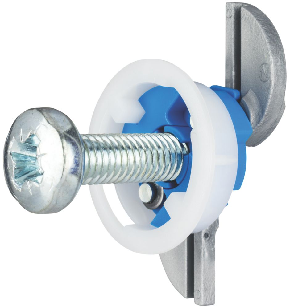

How do you use those in plasterboarded stud work walls?
You don't but you can use them on the other two walls to get through the tile, plasterboard and insulation. On a stud wall you can use a stud, put a noggin in or use a plasterboard fixing ...I like these
Been there, said that already. BTW Gripits require relatively enormous holes and a special cutter - so the can't be used on walls which have already been tiled
